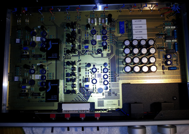

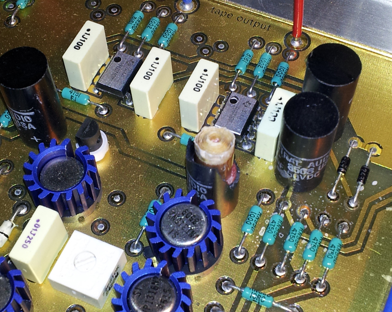

I have a DMC-10 Gamma that has been in storage for many years. I decided to listen to it and it works but has a dim power LED. It also doesn't seem to sound as good as I remember. I removed the top and found a broken cap as well as a few swollen ones. I would like to replace them all if possible but it's going to be difficult to remove the board. The interior is so lovely I want to keep it that way. The caps are all 35uf 50VDC and appear to have paper inside, they have Spectral written on them and most have the no. 8808 with a few having 8813. Any good suggestions would be appreciated.

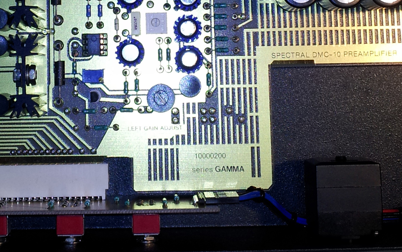

What color is the dielectric material of the PCBs??
I ask because on some of the Spectral stuff a very high quality material was used that had a low melting temp, making work on them more difficult.

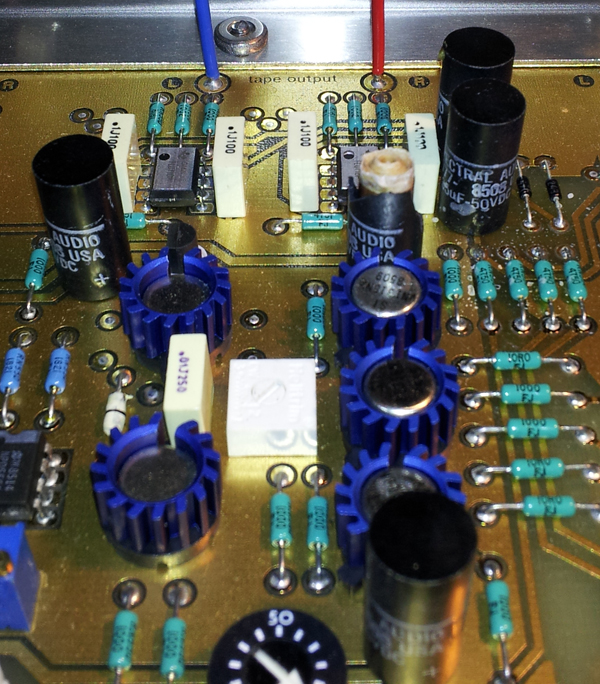

The boards are gold plated, the caps appear to be whitish paper inside, black outside as the pics should show.

Looks like standard fiberglass PCB.
They are double sided with through-hole "vias".
I'd replace them all. You'd want a temp controlled soldering iron and a good way to SUCK the solder out of the holes without overheating the boards. Mark the boards with the polarity, unless of course the boards are marked and you can see that.
Afaik, these are all power supply related caps, the signal path (except for RIAA or tone controls) is all DC coupled. So, high-temp rated, low ESR caps preferably with a slightly higher voltage rating, form factor to fit (pin spacing the same would be nice). Voltage rating 75-100vdc (higher IF they fit nicely).
Ought to be ok after that, unless something else went south.
The power supply caps are of some concern, but appear to be a different manufacturer.
Maybe someone else reading has experience with these particular caps. I'd likely leave them be, but no reason not to replace them assuming the cost is not to high and you can desolder without damaging the board.

The square array of caps in the pix are undoubtedly for the power supply. The associated electronics nearby are likely regulators.
