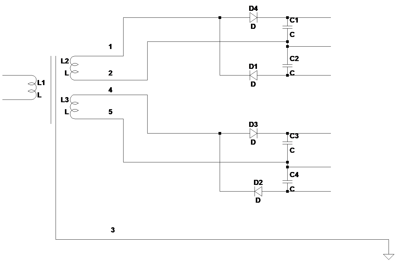

I took the top cover off and found the blue wire pair to be connected to pins 1&2 and the red wire pair to be connected to pins 4&5. It is my understanding that one pair is for the left channel, the other pair for the right channel. There is a black wire connected to pin 3, I'm assuming for ground. I wired up my input cable accordingly. The other end of my input cable was connected to a Variac set to about 20V, and checked with a multimeter to confirm it was the correct voltage output, as to avoid damaging anything. At this point, I wanted to confirm the preamp was functional before buying additional parts, so both power pair were connected in parallel to the Variac.

Attached is the essential supply for the DMC-10. The original transformer was special since at the time we could not get toroids. It also was made with multiple shields and very low flux density. Toroids should work fine. The secondaries should only connect through to the board. Any other connection will short something out or cause hum.

Thank you for the additional information. I found that one of the AC input pairs was out of phase with the other in my cable. I switched one and no more high current draw. Next step will be finding a fully isolated transformer, as my regular Variac couples line noise into the circuit. I'll post further updates after obtaining the correct transformer configuration.
