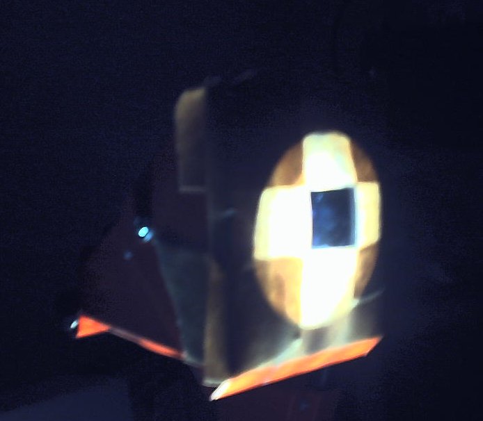

Also, I have some fuzziness on bright images on my nview spectra c. has anyone else experienced this?

if its only on the bright images it could be the same problem I had with my ASK400 setup. Basically you want to turn on your projector, get some electrical tape, move a length of tape from one side of the projection lens to the other until the fuzziness goes. Repeat for all four sides of image. see picture
