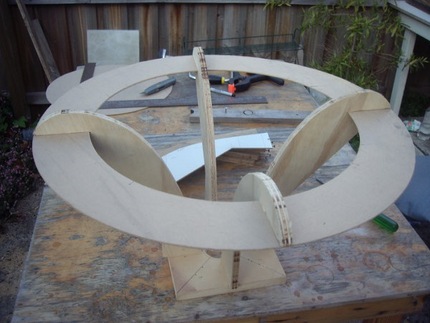

Agreed. I did something with a similar aesthetic a few years ago. With hindsight, it was a lot more work than it needed to be - a petal horn is how I'd do it now.
I built a teardrop shaped gore-panel construction once, if I had made the shapes grow at the mouth, a horn would have resulted vs a tear drop shape.
The one horn I made with 4 gore panels, followed a tractrix, and it sounded fantastic. One of the best speakers I have heard when used in a two way point source:
