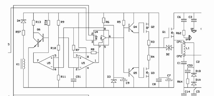

Hi, Alfsch,
Nice 😀 Did you eventually built it? I noticed something. The feedback is taken after the LC filter. Is this UcD?
The parameter difference between Nch (IRF540) and Pch (IRF9640), will this be a problem in real cct?

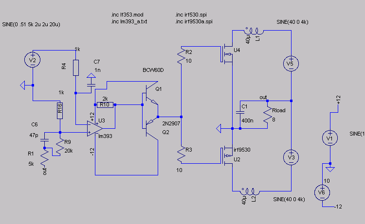

Hi, Fredos,
Q4-Q5=common collector bipolars, driving Q2-Q3=common source mosfets, and the drains are driving Q1 (the big mosfet)
Hi, Fredos,
alfsch said:hi fredos,
a year ago i had this in mind: (pic)
you think about something like this?
for small mosfet, as trans i tried: bc516/17 , 1A darling
for bigger gates, komp.fet driver: irf7389 , 30v, 30a peak
monster , fast driver: tc4422
There is a problem with that in that there is nowhere for the inductors to reset when you turn the mosfets off.
Here you go....
Link
DNA
coil "reset" < back-diodes
but for stray-ind. a extra snubber is needed, right, not in my pic...
is this, what you guessed?
