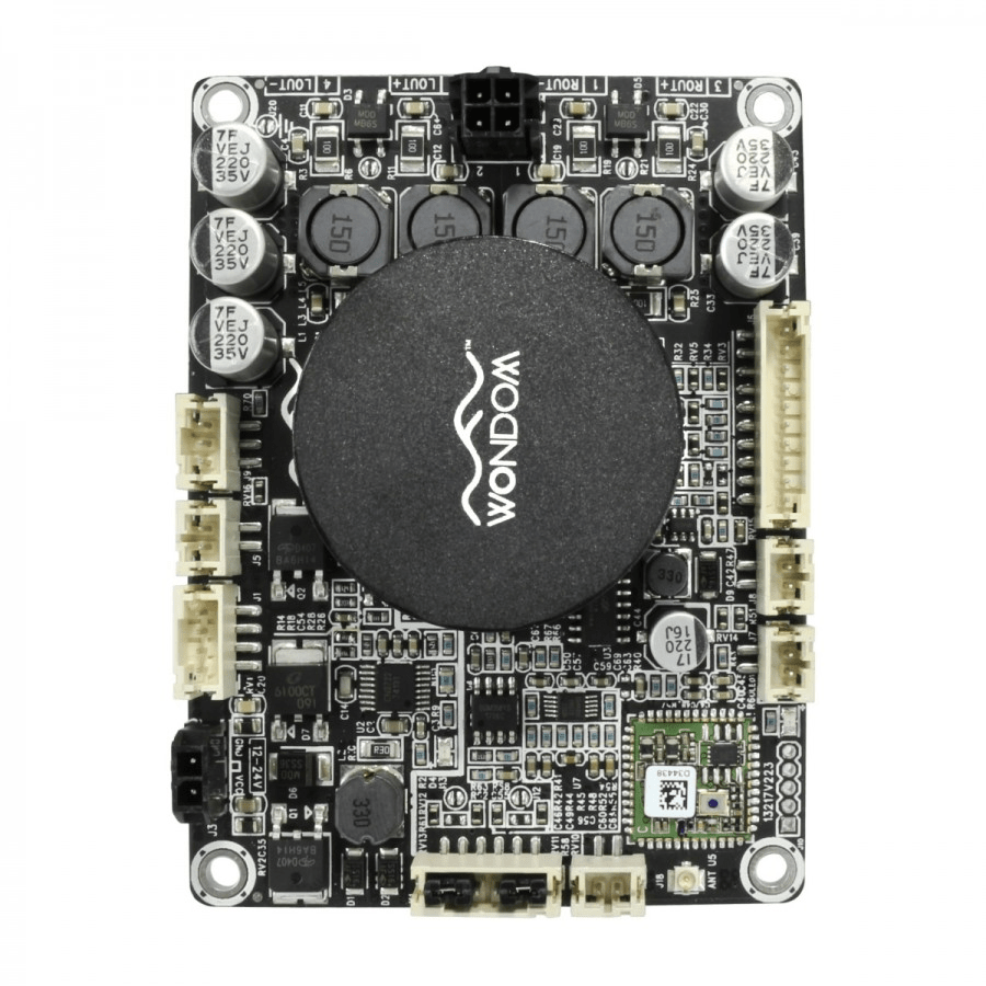

Hello, I've paired this amp WONDOM JAB with two 8ohm speakers (ND90) powered by a 5s battery pack for a Bluetooth speaker project. I have added a volume knob on the amp (comes as kit for this specific amp). Every time I modulate the volume using the knob I can see the speakers moving in and out (while music is not playing of course), moreover i get a fairly substantial noise coming from them when the knob is turned higher than 9-10 o'clock (noise stops after a while when there is no music/signal, i suppose the integrated Bluetooth module /amp goes into a power saver mode when it sensing that there is no signal). Power supply is common for source and amp since the Bluetooth is integrated on the amp and besides it doesn't sound like a ground loop. I suspect it might be the volume knobs cables that pick up noise (I attached a photo of the wiring you can see the map on the right hand side and the cables that run to the volume knob which are folded not looped).
Do you have any recommendations on how I should try to fix this these two issues?

I felt inspired to look and the signaling is something like Lout, Lin, Gnd, Gnd, Rin, Rout. The volume control appears to have six individual wires, while each in and out should be a ground shielded coax. The "WFO" wiring may be where the noise is coming from.

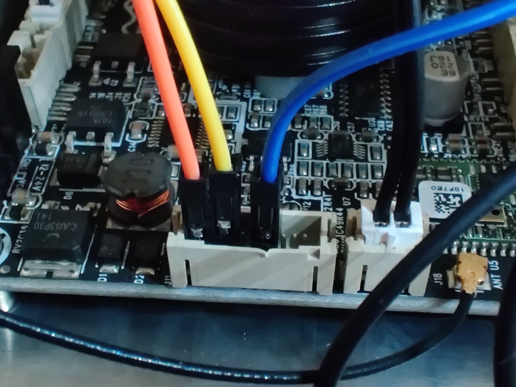

The amp originally came with two jumpers shorting two pin pairs together (pic attached) and leaving 2 pins unconnected? I suspect the are shorting Lin-Lout/ Rin-Rout and leaving the ground pins unconnected? could i use these two jumpers to check your hypothesis?I felt inspired to look and the signaling is something like Lout, Lin, Gnd, Gnd, Rin, Rout. The volume control appears to have six individual wires, while each in and out should be a ground shielded coax. The "WFO" wiring may be where the noise is coming from.

If you have a DMM. Put the two jumpers back in. Measure DC from the little metal part atop / inside the jumper (shown) to either of the open, center two pins (Gnd). If you get a DC voltage - even a fraction of a volt - they must've handled that "downstream" of the volume connector.
With DC across it, your volume control is effectively a signal generator when you turn it - and your speakers are responding to that signal.
Hopefully this test cinches it, then you can add the cap as advised above for the fix!

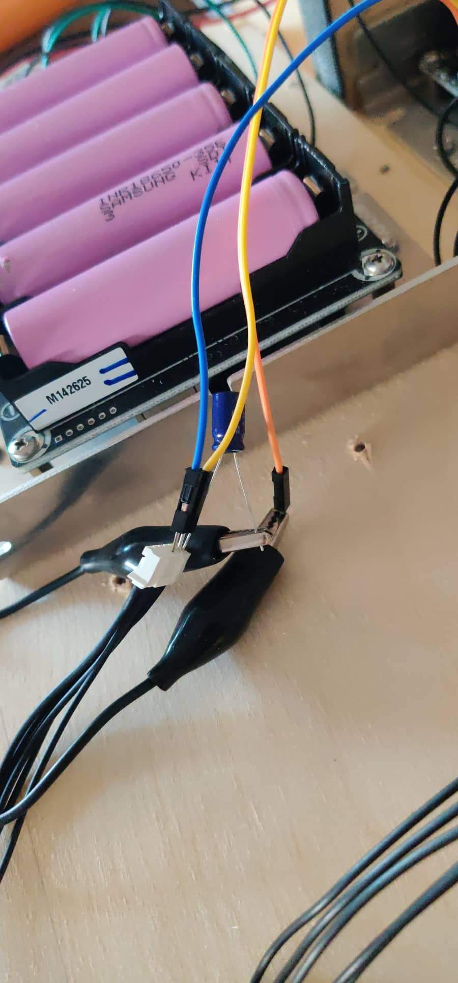

I connected a 10μF 50volt bipolar cap (I couldn't find 35 volt I hope that's fine) between the "out pin" and the " in pin"
The noise persist. I measured the DC voltage again. It was still 1.584 But this time it was dropping, dropping really slowly, maybe by 1mV per second. After about 3 minutes it finally almost reached 0-1mV. The was not eliminated thought.

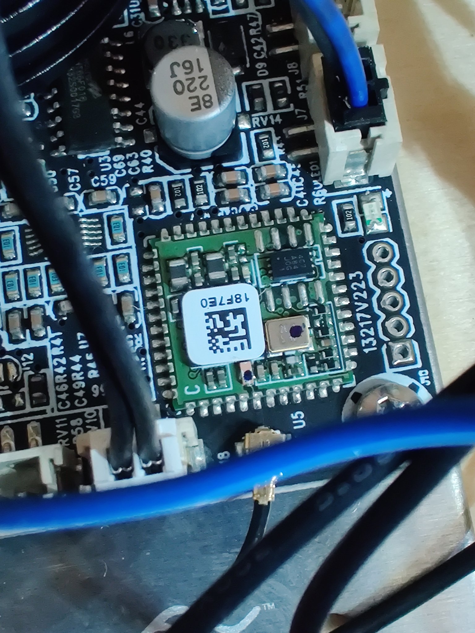

I've also attached a Pic of the bt board (I think?), it's integrated unfortunately. The noise is extremely loud and it doesn't sound a normal hiss, I can also feel a periodic thumb if I touch the cone of the speaker. The noise volume is attenuated by the position of the potentiometer.

The one photo of the volume pot audio connector placement is amusing. Looks like some kind of switching regulator just to the left, the BT just to the right - what a "happy place" for it, steeped in between those "digital, EMI generating" circuits...
