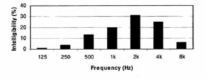

I wonder if make a loudspeaker dedicated to speech intelligibility have sens ?
Purpose is to reproduce radio communications in dispatch room (300-3000Hz).

The intelligibility of speech relies heavily on the reproduction of the consonants (k, p, s, t, etc.).Purpose is to reproduce radio communications in dispatch room (300-3000Hz).
To hear the consonants clearly, the loudspeaker must be capable of adequately reproducing frequencies in the range range 2 to 4 kHz.
Lots of papers on the web. From JBL:“Speech Intelligibility – a JBL Professional Technical Note” Technical Notes Volume 1, No. 26 | Pro Audio Encyclopedia
The graphs show intelligibility dost need low freqs. Thus the classic PA horns:

Thanks cbdb, that JBL technical note is very comprehensive in regard to the intelligibility of speech.
Well worth a read! 😎

Walkies talkies are not the best audio source 🙁 So not much signal above 3000Hz. According to cbdb's doc, I already loose 20% of intelligibility.

As mentioned by others, you need *excellent* response between 250-300Hz to typically 5kHz, but reaching , say, 7 kHz will not hurt at all and slightly increase sibilants.

This is the digital telephone bandwidth [BW], so in theory we basically want a big version of what's in an old portable phone, but never having seen/measured one all I'll say is that based on the pioneer's research we want it as flat as practical from ~200 - 6 kHz and boost the ~ 4 - 6 kHz BW to 'taste' for increased clarity.
