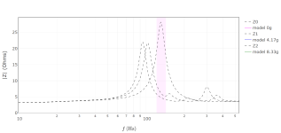

I have recently started the jurney of making impedance measurements on drivers. I am using REW with Focusrite Scarlett 2i2 audio interface. I have Keysight lab calibrated DMM and a two digit precision scale.
Rsense is 99.32ohm. I am running the driver on a small amplifier.
I have made several measurements with success and can generate T/S parameters in REW. I am however after reading V. Dickasons Loudspeaker cookbook v8 interested in using Speakerbench and their advanced parameters method.
I succeeded in uploading the zma files and create a Json container. But the data seems to have an error - it says there is an issue with the quality. Can you guide me on what i am doing wrong?

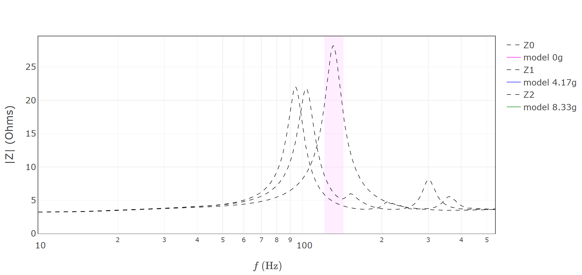

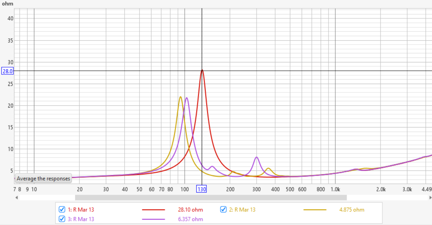

Measurements in REW

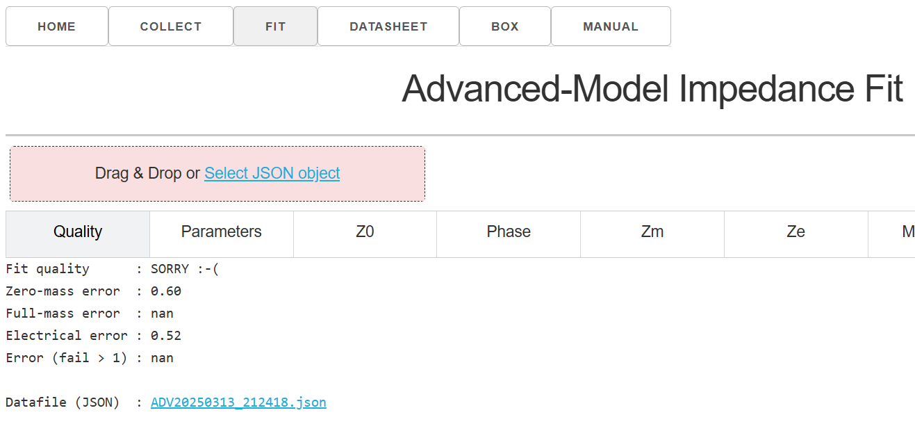

Imported into Speakerbench - Quality issue :/
The wierd thing is that if i chose the Z measurements, they seems to be imported correct

I can't speak for Speaker bench, but the extra bumps in 300Hz range are an indication that the added mass is not well attached.
I have attached the ZMA files. The driver is a 5,25" 4ohm bas/midrange from MB Quart. It is a test device, and i have two. Both are performing with like 5% difference when comparing the T/S parameters i calculate in REW.

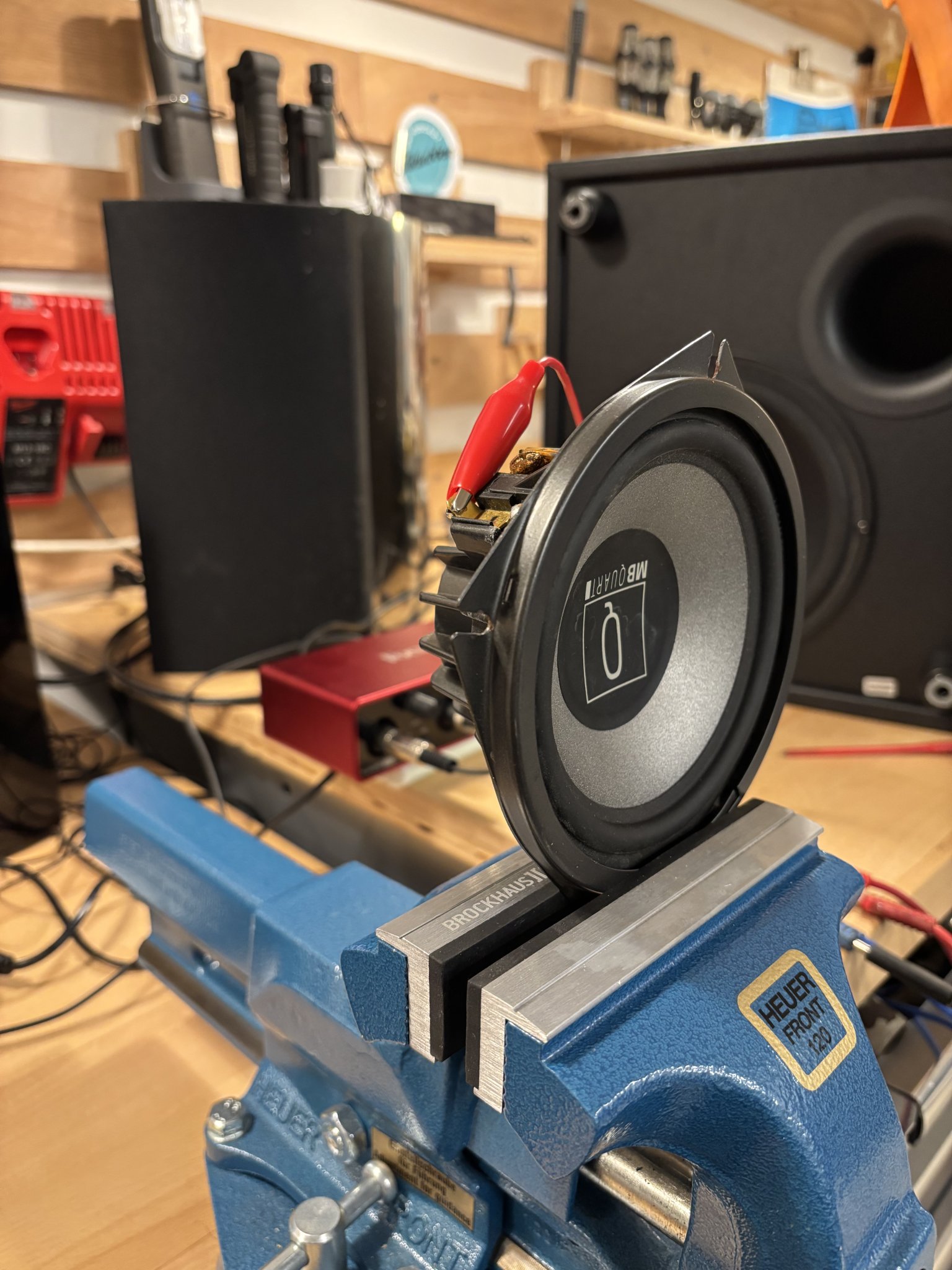

I use Tesa tack to attach some small coins to the membrane - good point about the 300hz resonance. I have tried two different benc vises, with same result, but they both clamped the basked and not the magnet as other seems to prefer.

Dcibel has named the problem.
In my experience, coins and magnets are difficult to attach resonance-free. It is easier with soft modeling clay.
Furthermore the soft clamping on the basket could cause problems (see chapter 3.1.3).

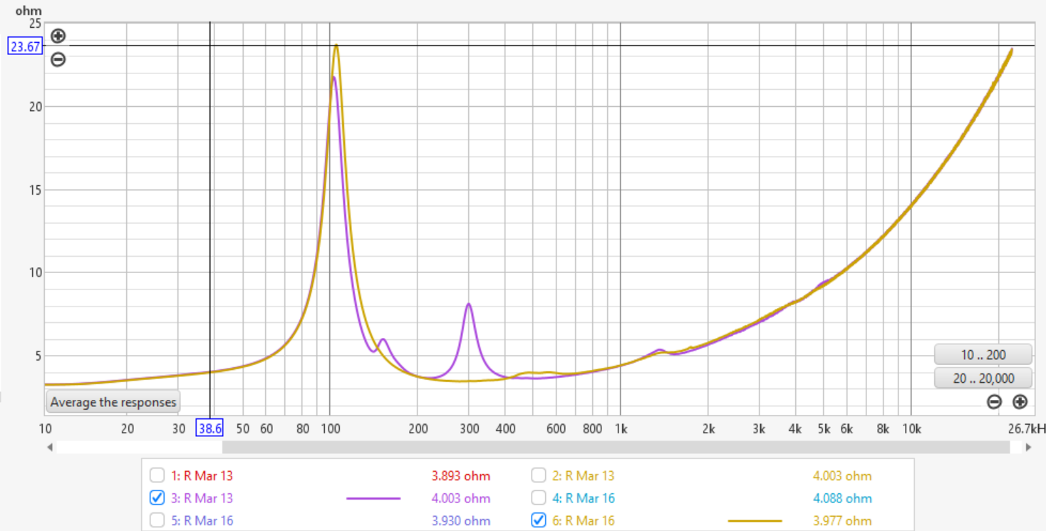

Ente and Dcibel. You were right. Used only tack and no coins. It seems like a result with less resonances. I will give it a try, and make three measurements and upload to Speakerlab
Curve (3) old measurement with coins and tack
Curve (6) new measurement with only tack

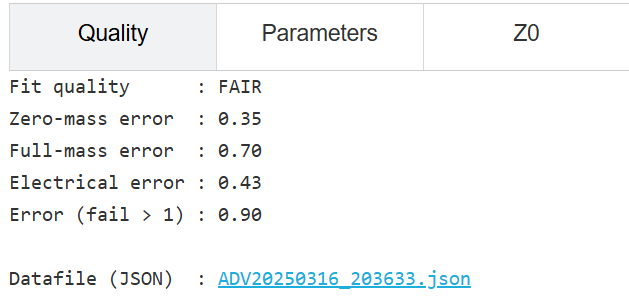

Just a short update - i uploadet it to Speakerbench and got the quality to "fair" 🙂 Thats better - but my inner OCD likes if the response was Perfect 🙂
How can i do my measurements better?
