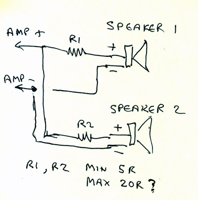

1) You cannot connect the two speakers in parallel as that would give ~ 2 ohm impedance. This may be too low for the amplifier, cause too much current to flow and damage it.
2) You can connect both speakers in series without danger or damage, but one speaker may sound louder than the other.
3) you can adjust the volume output of each speaker by connection a resistor in series with each speaker and then connecting both in parallel.
Schematic in next message ....

Quick sketch added.
If you do not need to make the volumes the same, just use 4ohms or 5ohms. The actual value is not critical, tolerance can be 10% or better.
If you play music loud, the resistors will get warm so they should be rated 10watts or bigger. Big white square resistors are often used for this.
Clear?
Any further questions?
(Edit) I forgot to say that if it is not important to have the same volume, just connect both speakers in series without resistors:
Amp+ to speaker1+, speaker1- to speaker2+, speaker2- to Amp-.

Thanks cliffforrest, I chose this metod Amp+ to speaker1+, speaker1- to speaker2+, speaker2- to Amp-.
