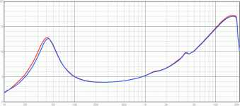

dscrobe said:Brett, I understand the convention on nominal impedance but I can safely assume that the impedance has to be something larger than the 5 ohm resistance I measured. The reactance of the coil to particular frequencies would cause an impedance of something higher than 5 ohms. But I can't imagine it ever getting higher than 10 ohms.
It does. I just measured a Seas L18, which is an 8 ohm nominal woofer. Impedance was
200hz - 7 ohms
2000hz - 12 ohms
20000hz - 40 ohms
Take a look at some of the many posted driver impedance measurements out there. You will see that the actual impedance of most drivers is below the nominal only over a few octaves.*

Owdi, that's amazing. I realize that inductive reactance increases with frequency but I just didn't comprehend the reality of it. Then to conclude, your speaker's impedance has a tendency to be higher when playing music with higher frequencies. Higher impedance means less watts. Of course the brains in the amp should account for this (hopefully).
dscrobe said:Owdi, that's amazing. I realize that inductive reactance increases with frequency but I just didn't comprehend the reality of it. Then to conclude, your speaker's impedance has a tendency to be higher when playing music with higher frequencies. Higher impedance means less watts. Of course the brains in the amp should account for this (hopefully).
The brains behind the design of the driver account for this. The job of the amp is to maintain a constant voltage no matter what the impedance.
