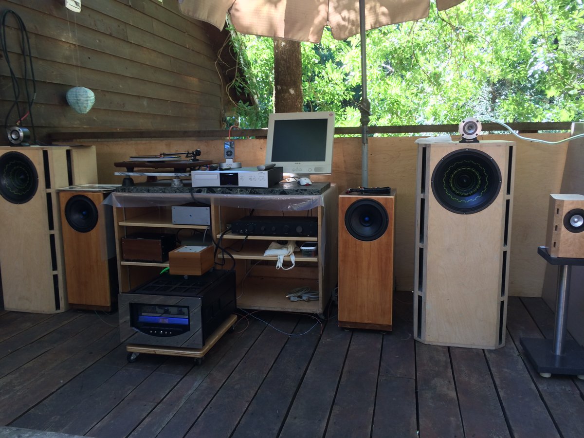

We have been working on these for sometime, ostensibly for use in PA work (slowly). Our goal is for a speaker that will fill this role and still be usable as a PA speaker. This summer we did get to the point where we were happy with the sound in a hifi role. Took quite a bit of work on the driver (Eminence 12LTA). Some here are quite happy with the driver in stock form (less dust caps).
They are about the same efficiency as Vulcan, but handle more power, and being a 12" move more air. They do need a tweeter -- the one you see is a cap coupled Foster, the one used in the radio shack pods.
We have also done a test fit of a Fostex FT17 mounted in some plumbing fittings that can be fitted as a Phase plug… given the high XO that arrangement would be good, we will proceed with that next.
All the drivers are quite inexpensive.

Depending on the noise in your workshop, you might not need to add a tweeter to the EmKen.
My EmKens 12lta's dont have the 'P10 pox' but do have an awfu'lotta basket damping going on.

I'd definitely concur that the 12LTA need some type of tweeter, and something like the FT17H makes sense. We use the old Radio Shack version because they were at hand, and with the plastic mounting case, handy to use.

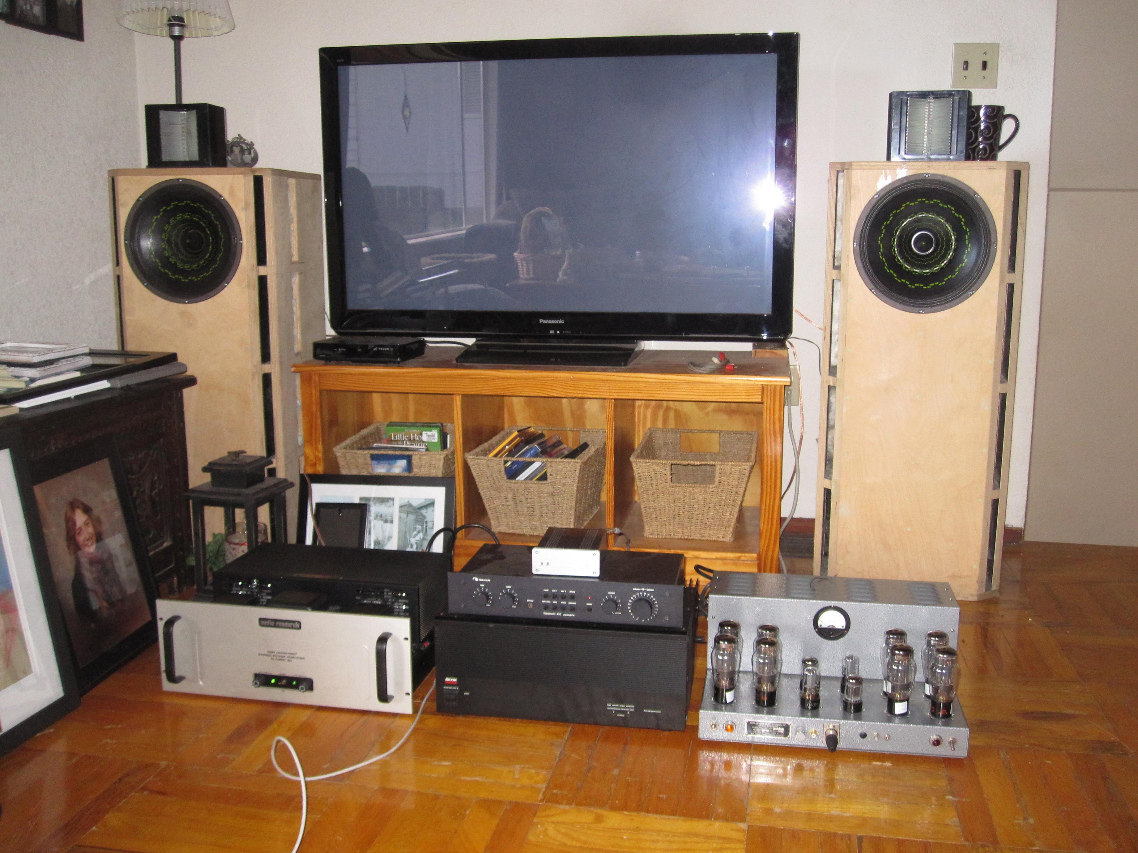

So I am building these right now with the Eminence 12LTA that I found neglected in a closet (Dave modded).
I am looking at the Fostex FT17H for a tweeter. I'll set in on top of the enclosure with a stand of some sort.
What do I need in terms of a crossover?
Essentially you'll have to perform measurements to see where you want to cross it over, how steep, and with what alignment. I think I set mine around 1kHz Linkwitz-Riley second order but it's been a while now. There are so many objectives to satisfy with a crossover design that there's no "one-size-fits-all" answer.

They are assembled with the Fostex FT17H's.
The low end is lacking and mids a bit but I am in a big 2400sf open building and I haven't pushed the volume yet.
Where do I start in terms of acoustic damping? Acousta-stuff or sheet material and where?
I did build with removable back and the front/back internal brace as well as both side braces.
Damping of the Em-Ken consists of nominal 12mm cotton or wool felt (or the subs that should be in the notes) on all the walls. Low density damping (like polyfill biting) can be placed on the centre side of any holey braces.
