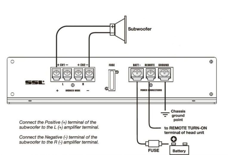

Please, can I connect this converter (with common ground) to an amplifier with bridge output stages? Connect (R-) and (L-)?????

I believe not. See this link: https://www.diyaudio.com/community/...ttenuating-bridged-btl-speaker-output.346777/

A bridged amp is made out of two normal amps, only driven out of phase.
So connect your attenuator to one speaker out terminal (typically the +Sp one but the other is fine too) and Ground.
As easy as that.
