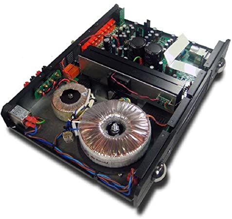

There are 2 causes for this loud thump.
1) Sparking caused by main power switch of power amplifier.
Every time the amplifier is switch on or off, a spark jumps across the gap. It can get pretty loud, sometimes loud enough to make you jump out of your chair if you are not expecting it.
2) DC offset at the output of your power amplifier.
This is a much softer thump.
Let us deal with no (2) first: DC Offset.
Disconnect all speakers from amp.
Place probes across amp + and - outputs.
"On" power amp and note reading of voltage. Check for other channel as well. "Off" power amp immediately.
Caution: make sure your red probe is not touching the -ve terminal or the chassis. If this happens, there is a very high likihood that your amp will be destroyed.
Your readings should be below 100mV. Preferably below 10 mV.
If above 1V, your amp is faulty.
As Saakra mentioned earlier, an output relay with a delay will eliminate this sound on power up. I would like to add that this does not solve the problem of DC Offset at the output. It only removes this annoying sound.
We now proceed to cause no(1), which is a very loud thump caused by sparking on the amp power switch.
What I am about to suggest is going to:
1)void your warranty, but more importantly,
2)expose you to the dangers of live 240Vac. If you are not well versed in mains electricity, do not attempt this. Electricity can kill. Its called "electrocution". Get a friend who is qualified to do this if you are not.
Step 1)
Unplug the mains power cable of your amp. Do not just switch off the wall supply. Pull the plug out of the socket.
Step 2)
Open the chasis cover of your amp. At the back of the front panel you will see the power switch. Hopefully, there are only 2 cables soldered to it. This is the mains "LIVE" wire. Check whether there is something connected across these 2 cables. I am refering to the point where the cables are soldered to the terminals at the back of the switch.
If there is nothing there, you have identified the probable cause.

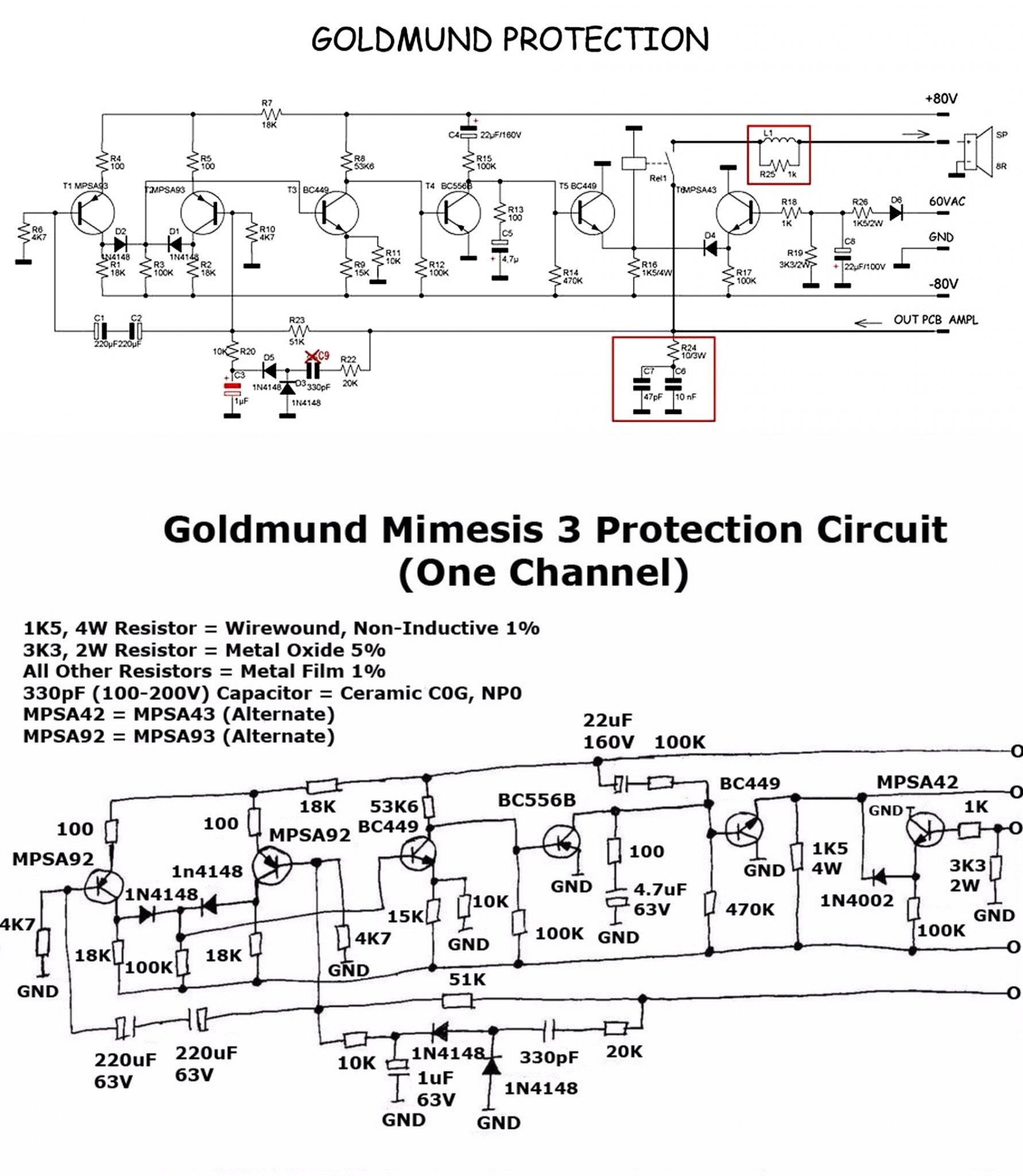

Simple case of omitted standard speaker relay. Many if not most amplifiers have non ideal start up and shutdown behaviour that results in a short but annoying DC pulse on the speakers. Good designers prevent the power on/off plops with a relay in the speaker outputs that switches delayed at power on and switches off very fast at power off. This was eighties design standard in 95% of Japanese amplifiers that were dead silent at power on/off AND did not blow up speakers when they died as the relay circuit was often done with an IC (the µPC1237) that also measured DC at the outputs. So, as a user, you never had your expensive speakers going kaputt because of either power on/off plops or the amplifiers having a very bad day. This was all standard and working OK more than 40 years ago. This seems to be forgotten as many 2022 amplifiers "fart" which apparently is appreciated, have severe power on/off plops and when the famous designers baby has a very bad day it will burn your loudspeakers as well. You can't stop progress 🙂
So it makes some sense to add the omitted speaker relay. If you also want DC protection: the good old µP1237 IC's are still produced. Most simple way to have it all: silence and safety. Make sure to choose a relay with silver or silver containing bifurcated contacts and not the often made mistake to choose gold/gold plated contacts. There are many of such designs available as kits or ready made PCBs so the challenge is to find a quality one that fits physically in the amplifier. In the case of buying cheap Ebay/chinese stuff then at least make sure to buy a branded relay for the Chang Hui relay and use quality electrolytic caps. Some of the cheap devices use 2 relays so each channel has 2 x bifurcated contacts in parallel mitigating any (exaggerated) negative side effect.

Question: what do you think will happen when that amplifier is fitted with a speaker relay and you switch it on before the preamplifier is switched on?
