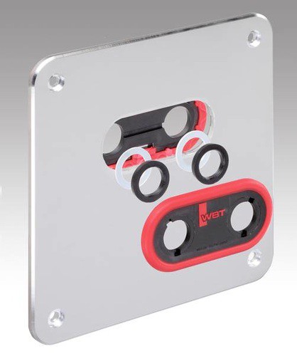

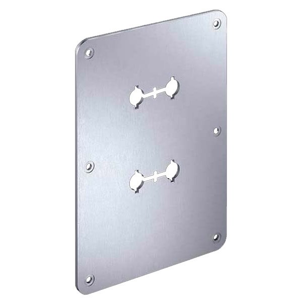

After some seaching through internet he found that WBT do milling in their aluminum mounting plates where there are either large oval hole for plastic frame or cutout line betwen terminals.

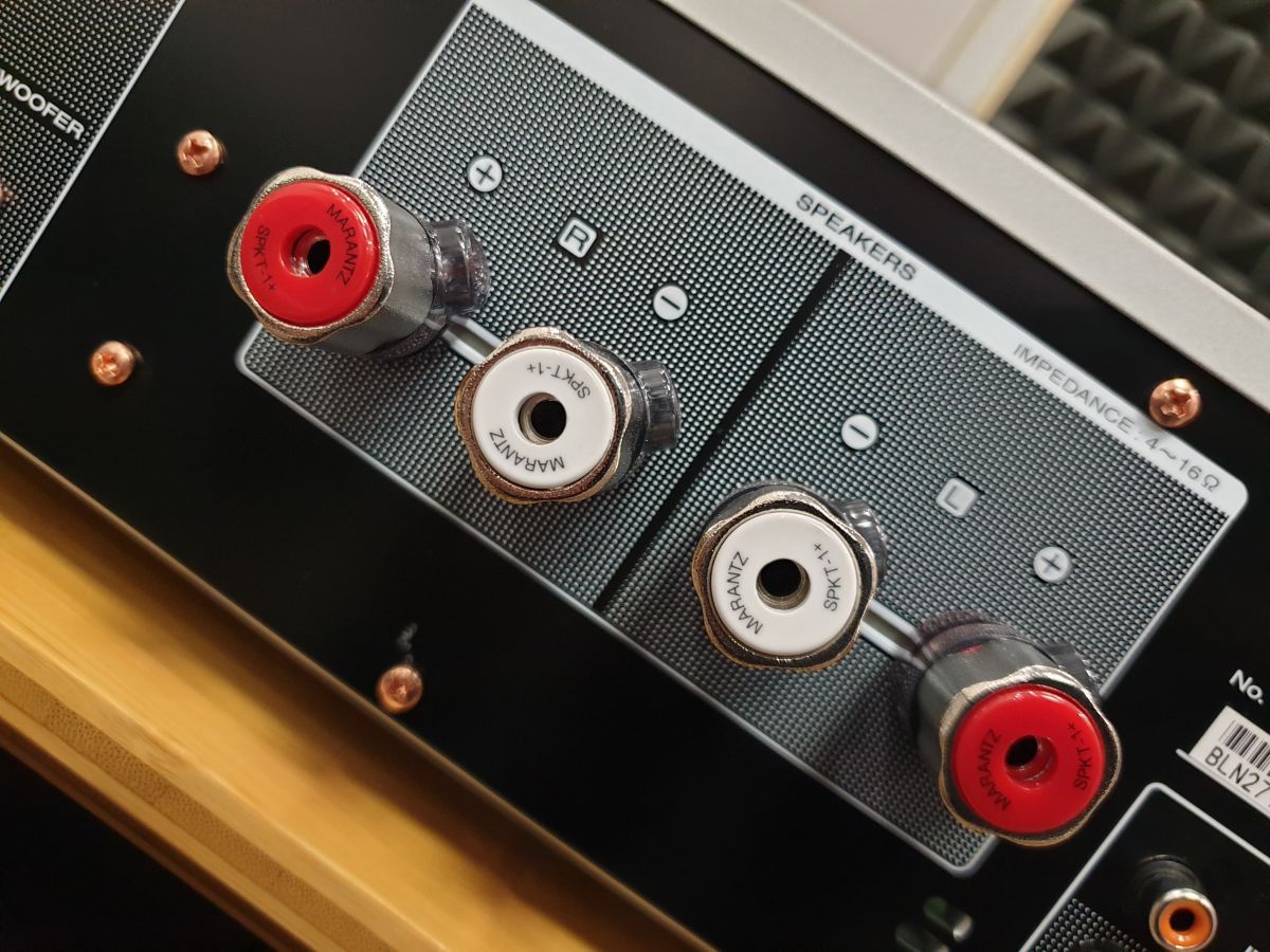

He also google "Marantz back plate" pictures, they also do it for a long time.
The point is that "+" and "-" pass through the same hole in the metal plate.

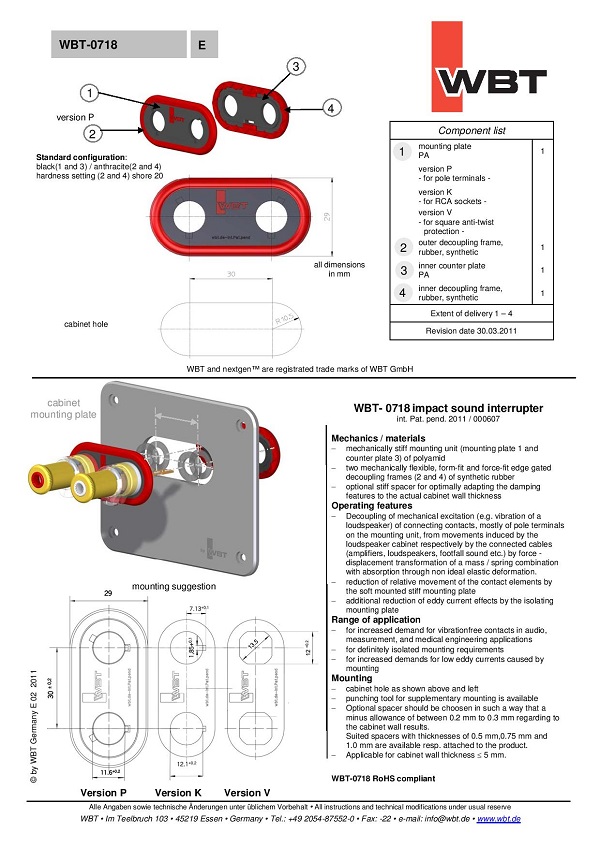

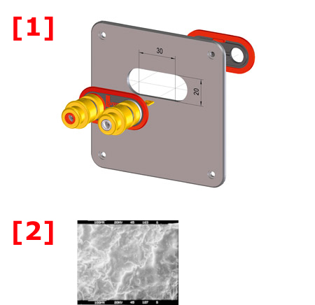

Plastic frame (WBT-0718) as I understand have 3 versions for all of WBT pole terminals and also their RCA sockets.
It is actualy made of polyamid + synthetic rubber with purpose to dampen vibrations.

Polyamide ie mostly like nylon is a very tough durable material.
You can deform it - it tends to fail in a ductile manner, not due to cracking, it's not a brittle material.
I was writing about that (WBT-0718) frame, but WBT terminals washer with a "tooth" is also made of polyamide (PA) 6 (10% glass fibre). Well yes this is also type of nylon. I guess it is more durable for anti twist purpose than plastic washer.
