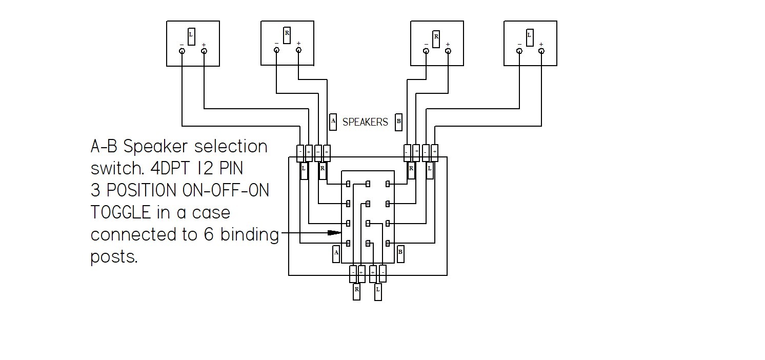

I need a speaker selection switch and have read many posts. Most recommend niles, russounds and adcom, becuase they have components that protect amps and speakers. I don't understand why I need that protection. It seems that, since just a pair of wires are used to connect an amp directly to a pair of speakers, it seems only a simple switch, with two wires from amp and wires from two sets of speakers would be needed to connect to a switch. I don't want volume control. What am I misiing?
I've decided to make a simple switch that will allow either speakers A or B but not both. It will use a 4dpt 12 pin off-on-off toggle switch with brass lugs connected to binding posts.

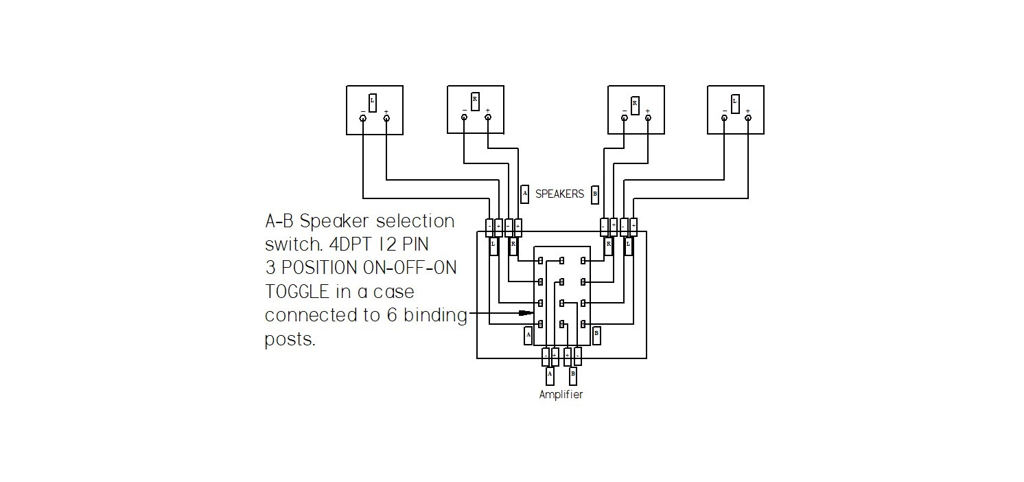

The reason for the switch is I want to connect the B&W N803 speakers to an amplifier in another room, with a pair of B&W P6 speakers, The N803s are now powered by an Aragon 8008BB, in excellent condition, that I plan to sell. Corrected switch sketch is attached.

I have used something similar to this but I modified it to use quality metal thin film load resistors inside for the unused side. They use white cement filled resistors to supply a nominal 200ohm load on unused channels to prevent damage to some amps as they don’t like to drive no-load (open condition).

If you will switch tube amp outputs you need make(connect)-before-you-break (disconnect) switches so output is never ever unloaded, even for a fraction of a second, because that is BAD for tubes, sockets and OTs.
Such switches are typically rotary and contact is wider than needed so when halfway it is simultaneously connected to the contact it's leaving and the new one it's reaching.
The halved impedance seen by amp is not damaging for that fraction of a second while sparks might fly if contact were contacting none.
No big deal for SS amps but the idea comes from the 50s or so.
If pushbuttons same thing, sliding contact is somewhat wider than needed.
IF you turn volume down to zero before switching no problem happens but good Engineering includes making "idiot proof" products if at all possible.
And even so ..... 🙄
Seems that an idiot proof way to keep a tube amp safe is for manufacturer to install nominal circa 200ohm “load” resistors in parallel with outputs so that they are never truly “unloaded”. Someone can accidentally bump a speaker wire and pull it out. That would be bad to blow an amp.
