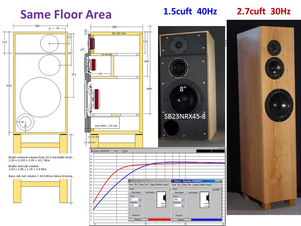

Decision 1: how important is powerful deep bass? 45Hz @ 0.75cuft or 37Hz @1.5cuft or 28Hz @2.5cuft volume
2-way stand mount designs typically use 0.5 - 0.75cuft cabinets with -F3~45Hz and a midwoofer which covers 45Hz - 1.8kHz like the ZR71
For your price range, you can get a good 8" woofer which performs well in 1.5cuft - 2.5cuft volumes.
For a small room a 3-way design using 1" + 5" + 8" in either a 1.5cuft stand mount, or 2.5cuft floor stander is popular.
A separate 5" midrange offers greater detail presentation than a 6"-7" midwoofer used in a 2-way
A floorstander cabinet for -F3=28Hz will use the same floor space as your stand with a -F3=39Hz cabinet.
SB_Acoustics Drivers offer a high performance/cost.
8" SB23NRXS45-8 woofer $94 (-F3=28Hz in 2.5cuft, -F3=39Hz in 1.5cuft)
5" SB15MFC30-8 midbass $54
0.75" SB21RDC-4 dome tweeter $33
Total $181 for drivers
$70 for crossover = $250/speaker for parts - just add wood

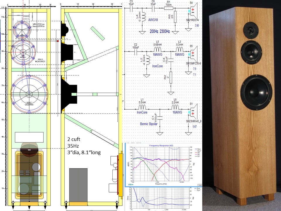

SBAcoustics 3-Way Classic Troels Gravesen 1.5cuft stand mount
SBAcoustics-3WC

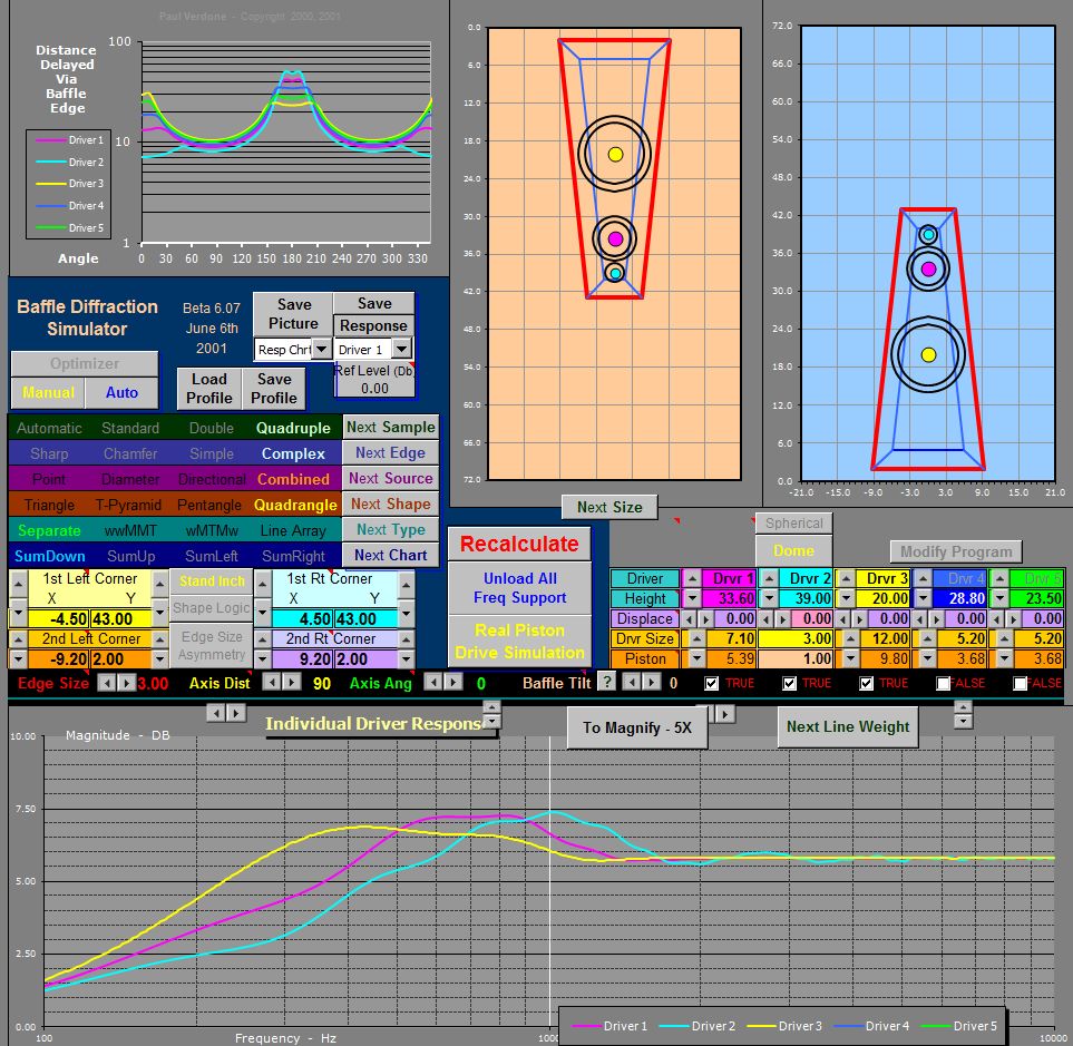

There are two common cabinets with slanted baffles for time and phase alignment: box with 6-degree slanted baffle; pyramid shape with slanted baffle.

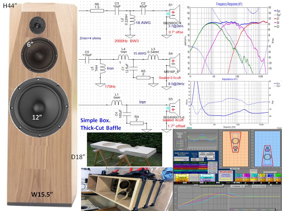

Hey All,
Thanks for all of this. Luckily I am in no hurry, and google search my way around all of this. I am not opposed to a nice 3-way even floor standing... If I do that then I would have to get a different SUB, or not use one at all... and I am ok with that... I think... I KNOW I would prefer a "stereo" sub, and not the single I have now.
I'm sure I will have more questions soon when I look into all of this more.

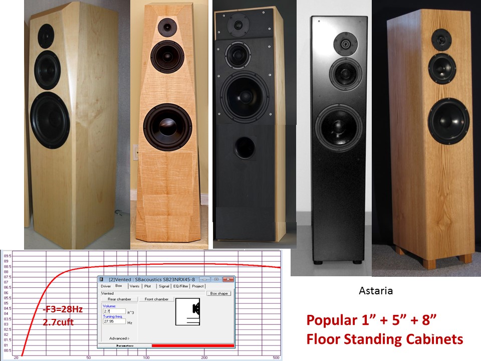

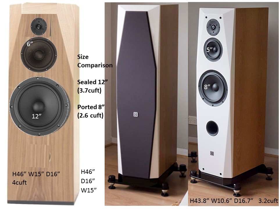

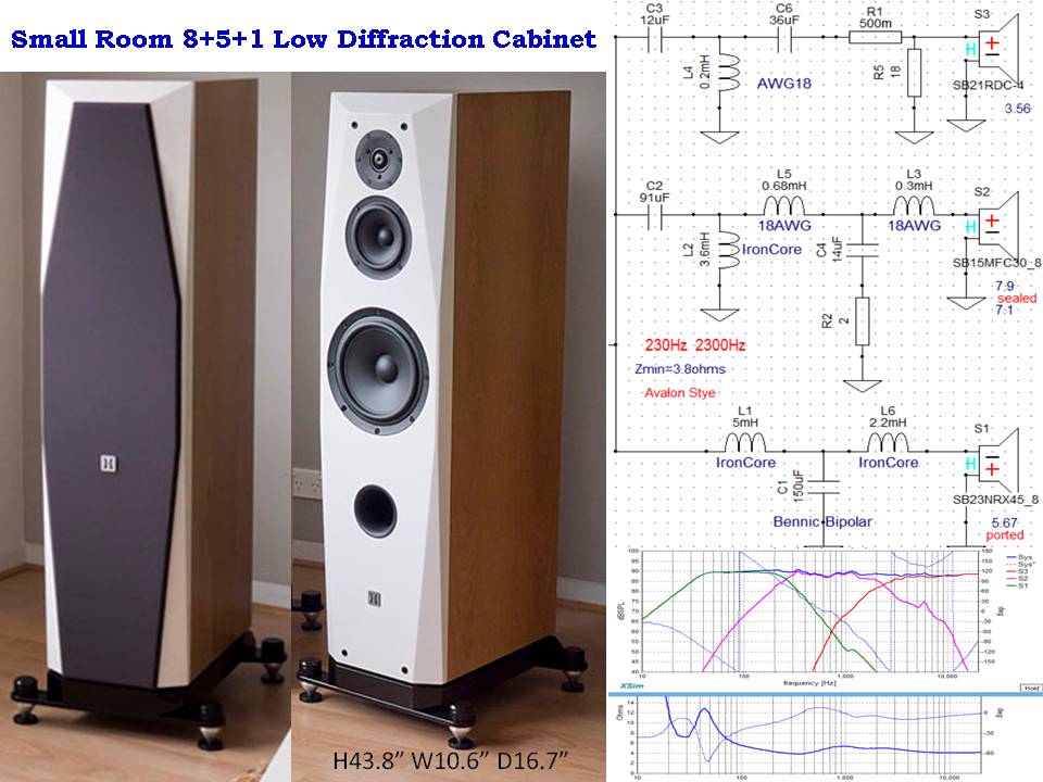

Consider: Spend the entire budget on a stereo pair of 30Hz - 20kHz 3-way speakers. Get wood shop help to construct an Avalon style low diffraction cabinet. (construction examples on web)
Research and experiment placing your one subwoofer in the corner, or 1/3 along the long wall.
1" + 5" + 8" woofer(ported -F3 ~30Hz)
1" + 6.5" + 12" woofer (sealed -F3 ~32Hz)
1" SB29RDC-4 $52
6.5" MW16P-8 $148
12" SB34NRX75-6 $174
Low-Frequency Optimization Using Multiple Subwoofers*
TODD WELTI AND ALLAN DEVANTIER
Pet the OP: " I do not have room for large floor standers". These are excellent speakers, but it doesn't matter a whit if he doesn't have room.
One solution does not fit all.
1" SB29RDC-4 $52
6.5" MW16P-8 $148
