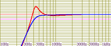

Incidentally, how are you measuring all this? I see these precise fractions, and I am wondering how it is possible.
For tuning, 2.92 cu ft equals 83 liters and I knocked off 4 liters for speaker and the port. For your 2.5" by 18mm long port I got 43 Hz tuning.
Now, one thing. Did you run a frequency test from say 25 Hz to 60 Hz to see if the box where the impedance is the least? where ever the impedance is the least in that area, that is the tuning frequency. I am wondering if you are reading 8+ohms at what you think is the tuning frequency, when it actually is a little bit off.
Finally, you seem to have a box much larger than the Thiele-Small parameters would call for. Your Vas is 17 liters, your Qts is .387, your Fs is 42.5. Such a box should be around 17 liters, tuned to the Fs. That would be the "classic" reflex. You can make it a little larger and tune it a little lower, of course, nothing wrong with that. But your box seems to be 79 liters, and that is pretty huge for what your speaker calls for. It looks like you could have gotten away with a smaller box.
By the way, are you sure abuot that Vas for the 8 inch? 44 Hz Fs and a 17 liter box-this woofer puts out a lot of bass in a small box, that is for sure.
Also, you gave the length of the vent as 18 mm. That means this is just a cutout in the box with no tube, right? Cause I am assuming your wood or MDF is 18mm thick.
Here is the simulation for your woofer in a 79 liter box, (red) and a 17 liter box, (blue). Red is tuned to 43 Hz, blue to 42 Hz.

First, there is something important I want to point out.
A simulation is not a measurement. It's all right to say that you are not equipped to do the actual measurement, ( I don't know if you are or not). I just want to know if you are measuring or simulating.
This is a very important distiction, since this is an unusual box and there is some uncertainty if the Thiele-Small equations work when the box volume is many times the Vas. So please make the distinction clear-it is important.
Okay, that being said, I have an answer as to why Eminence Designer seems to think your 4 ohm woofer is actually an 8 ohm woofer.
It's the overvolume.
If you had done a conventional setup for your particular Qts and made the box volume somewhere around the Vas, your woofer would read like a typical 4 ohm woofer.
But add the huge, extra box volume, and the impedance reading goes right up.
Below is a simulation using BoxModel, a Dos freeware program that still does a good job. Note-do not ever use the Transmission Line portion of the program-even the authors admitted it did not predict anything accurately. As for Closed, Vented and Bandpass though, BoxModel does a good job.
The light blue line is the impedance of the woofer in a 17 liter box tuned to 42 Hz. The red is for an 81 liter box tuned to 42 Hz. both Win ISD and BoxModel say your box with your vent should tune the box to 42 Hz, not 39 Hz. Anyway, the difference is not important.
As you can see, the red line, (81 liter box) is considerably higher in impedance than the blue line, (17 liter box). The response curves are similar to what WinISD shows, which I posted above.
Please note that by the time you go up to 150 Hz, the speaker in the 81 liter box, (red line), is back to being a 4 ohm speaker again.

As stated before, though, we cannot be sure, with this box many times the speaker's Vas, whether these simulations actually work or not.

Simply write in 50 Hz for your tone. Use a cable to run the Line Out to an amp-or if your sound card has a powered out, run the sound card to the speaker. Play the 50 Hz tone.
Now, cover the port with a book or something. Then uncover it. cover it again, then uncover it.
If the 50 Hz tone is much louder when the port is open than when it is closed, then the output and the impedance are probably close to what the charts say. If there is little difference if the port is open or closed, then these charts are meaningless.
According to Win ISD, at 50 Hz you should be about 11 dB louder with the port open than with the port closed. This should be very hearable. If it is not hearable, then these charts count for little.
Try it, and let me know how it turns out. 🙂
kelticwizard said:Okay, that being said, I have an answer as to why Eminence Designer seems to think your 4 ohm woofer is actually an 8 ohm woofer.
Okay. Got it!
Thanks for your help.
