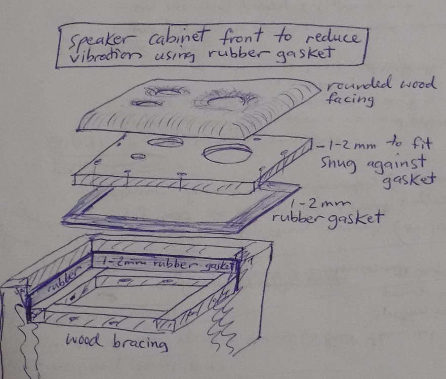

I am wondering if this idea has been explored and is worth it?
The idea is to use rubber gaskets to sepoerate the front face of a speaker cabinet (with its virbrating drivers) from the rest of the speaker cabinet, to reduce vibration.
With this idea the only direct wood wood connection is the screws, unless I used very strong silicone gasket glue or some other selant like Selleys 300g Clear ArmourFlex Adhesive Sealant | Bunnings Warehouse
Thanks for any feedback.

It's a great idea, broadly speaking, because sound does get from the baskets to the cabinet. I'd want to damp that panel though. Silicone is compliant, and while sometimes it has shown to be very useful it doesn't have high damping qualities. While you're at bunnings, maybe get some soft polyurethane adhesive.
Yes, it has been explored. Since about the seventies of the last century. There even was a time that KEF sold their CS-units with appropriate dampers for mounting them on the baffle, consisting of a soft gasket and mounting bolts in grommets. Look for old publications from the BBC and old magazines like Wireless World. The mounting of the B110 in the LS3/5A also was more or less decoupled.
Decoupling the drivers from the baffle is the better way anyway. Resonances in the baffle aren't exactly what you want either. The main challenge is aiming at the right frequency range with the right amount of damping. Simply mounting some rubber gasket will not do.

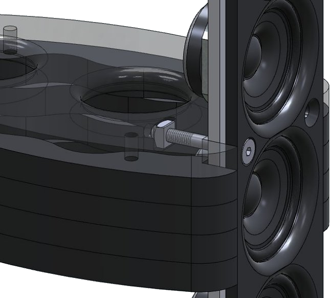

It's much like what I have done with my baffle construction, an outer baffle, isolated from the inner baffle that holds the driver(s). Flexible gasket between inner baffle and enclosure. Damping butyl rope (remains flexible) between inner baffle and outer baffle. Bolts hold it in place, under the bolt heads are rubber o-rings to further isolate them from the baffle...
The inner baffle, with drivers attached to them is floating between the enclosure and outer baffle with damping material between them.

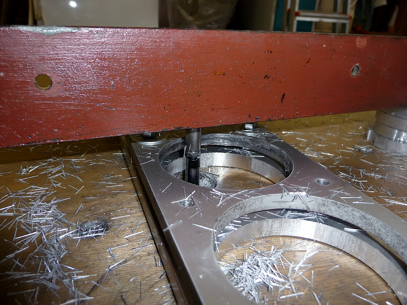

My baffles are made of aluminium but the idea is similar. I cut them with a router and lots of lubrication (I used WD40).

i think you are maybe overthinking things.
there are loads of band/pa/disco large speakers without any rubber membranes.
the back of the cone will apply sound waves to back of cabinet anyway.

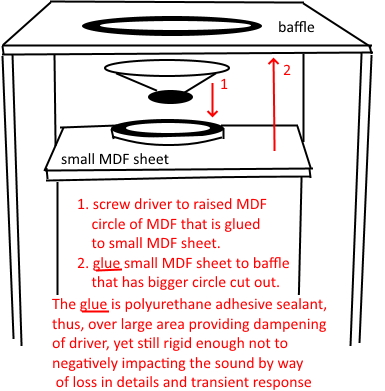

@romus:
I think this might work pretty well, but not for the reason you'd imagine.
If I understand your drawing correctly, you want the adhesive to absorb the vibrations produced by the chassis acting more or less like a mechanical low-pass but due to the huge contact area you push the "crossover frequency" way up and allow more frequencies to pass than when using a smaller plate. (I dont know a lot about this so maybe I am completely wrong but I am sure you can do some research.)
On the other hand you just constructed a constrained layer damping arrangement. When the plates deform due to vibrations, the glue in between will be subjected to shearing and will absorb a lot of energy. Therefore there will be much less vibrational energy able to propagate to other plates of the cabinet or the surrounding.
To get the best of both worlds it may be advantageous to cut the inner plate so that you have a small mounting ring for an effective mechanical filter and a large, stiff plate for constrained layer damping.

Its a good idea. BTW I never use screws in cabinets as this transfers vibrations between the panels (front, sides, back) in a cabinet. I only use builders glue to keep the box together. Also try to minimize the baffle where the drivers are attached. You can divide the baffle in parts to reduce the transferred vibrations.
