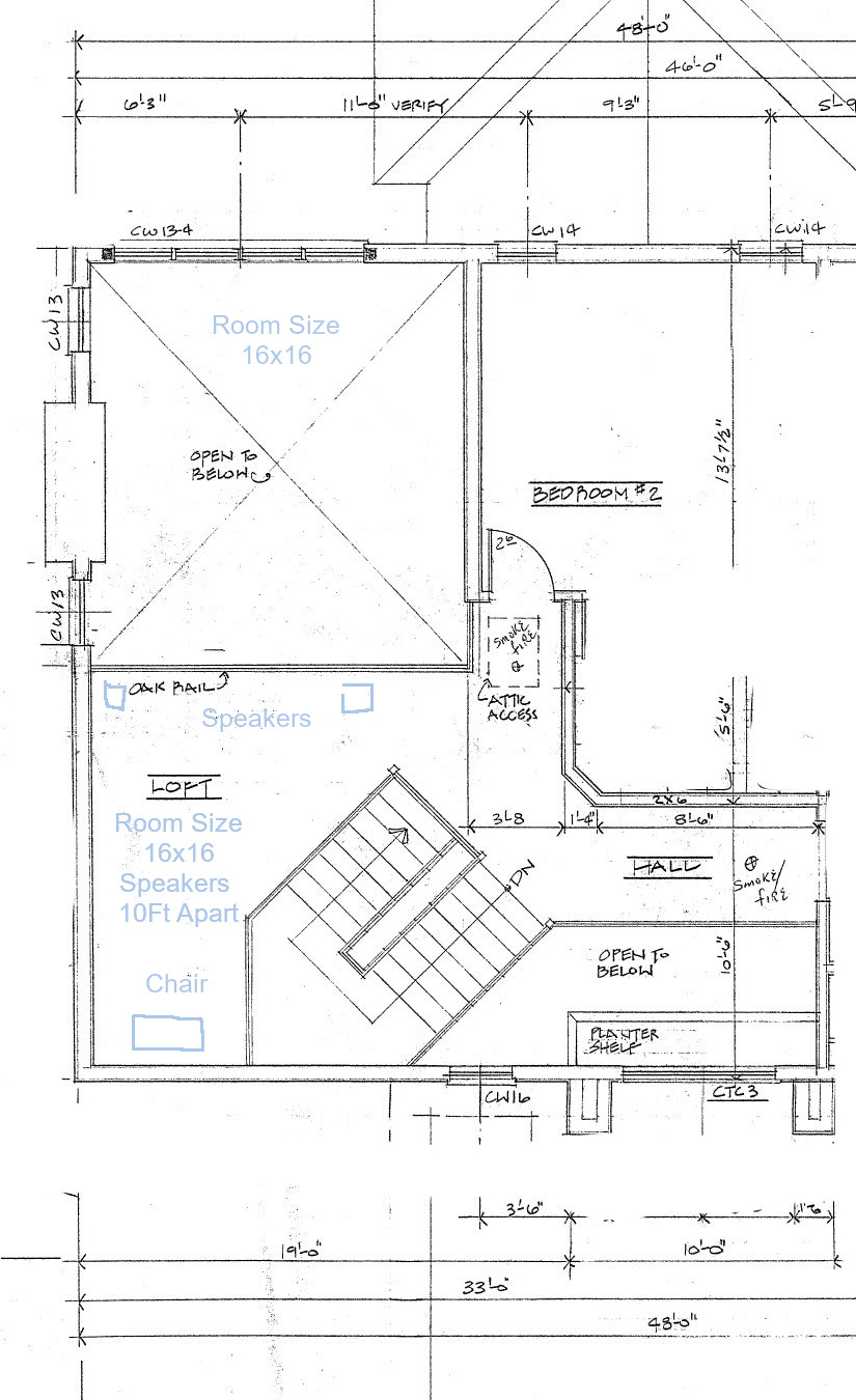

I’m looking for help in choosing speakers for my home office/listening area. I will primarily be listening to old vinyl (Empire Troubadour) or streaming music. The speakers will be powered with a McIntosh MC-240. I plan to run the speakers at 4ohms. I have other equipment, but like vintage stuff and definitely want to utilize this amp as much as possible. I want to fill the room with clean music, not loud. I listen to a lot of classic rock, jazz, current music. Typically, no one else is home when I am listening.
The overall space is 16x16 loft that is open to another 16x16 area. It’s an odd space as there is a set of stairs there so my listening chair is off to one side. I’m looking for speaker ideas. My original thought was a pair of magnepans as they would fill sound off the back as well as the front. This may still be a good idea given the space. If I don’t go with the Maggies, I will likely build a pair of speakers. I’ve been considering a MTMW setup, similar to this build: DIY 3-Way Hi-Vi Tower Loudspeaker Project - 1.618 or diVine Audio | Canaiolo
I have never built speakers, and would need to do a lot more planning if that I the way to go. I have picked up David Weems book and have also been reading lots of other articles. For drivers, I am looking primarily at Dayton Audio’s reference series (RS225, RST28F, RS150P). I’m not married to these drivers, but they are at a price point I like. I have not planned crossover’s yet (more to come). I’m comfortable with woodworking and have access to a pretty nice shop.
