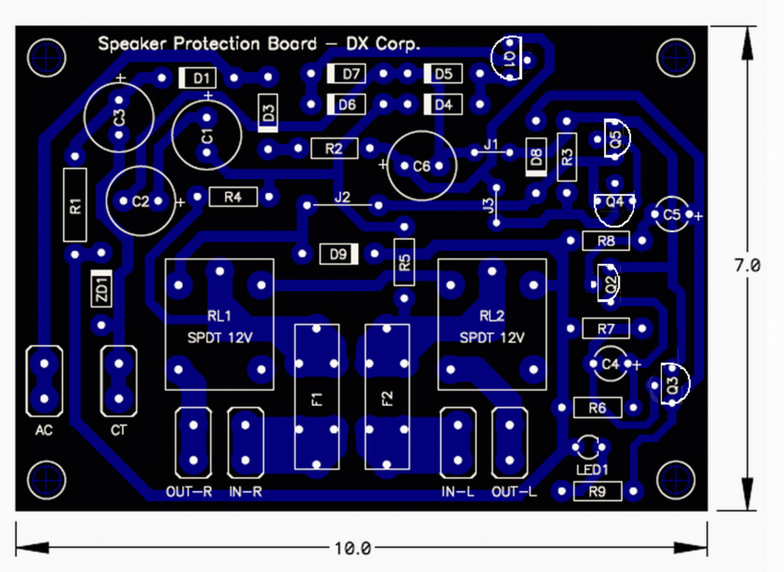

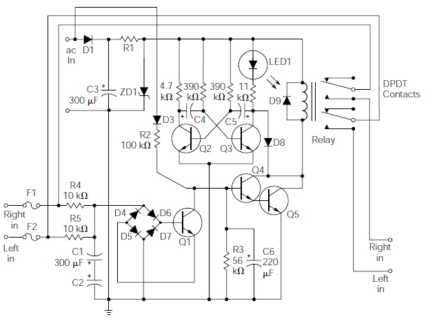

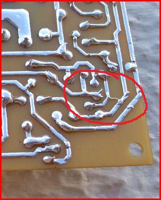

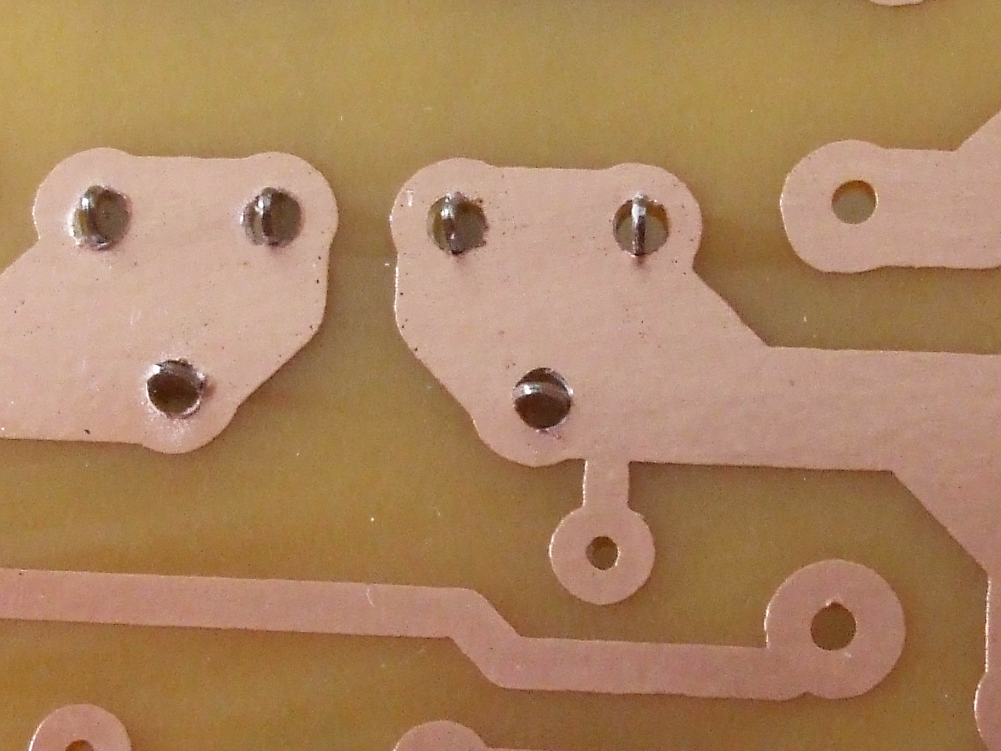

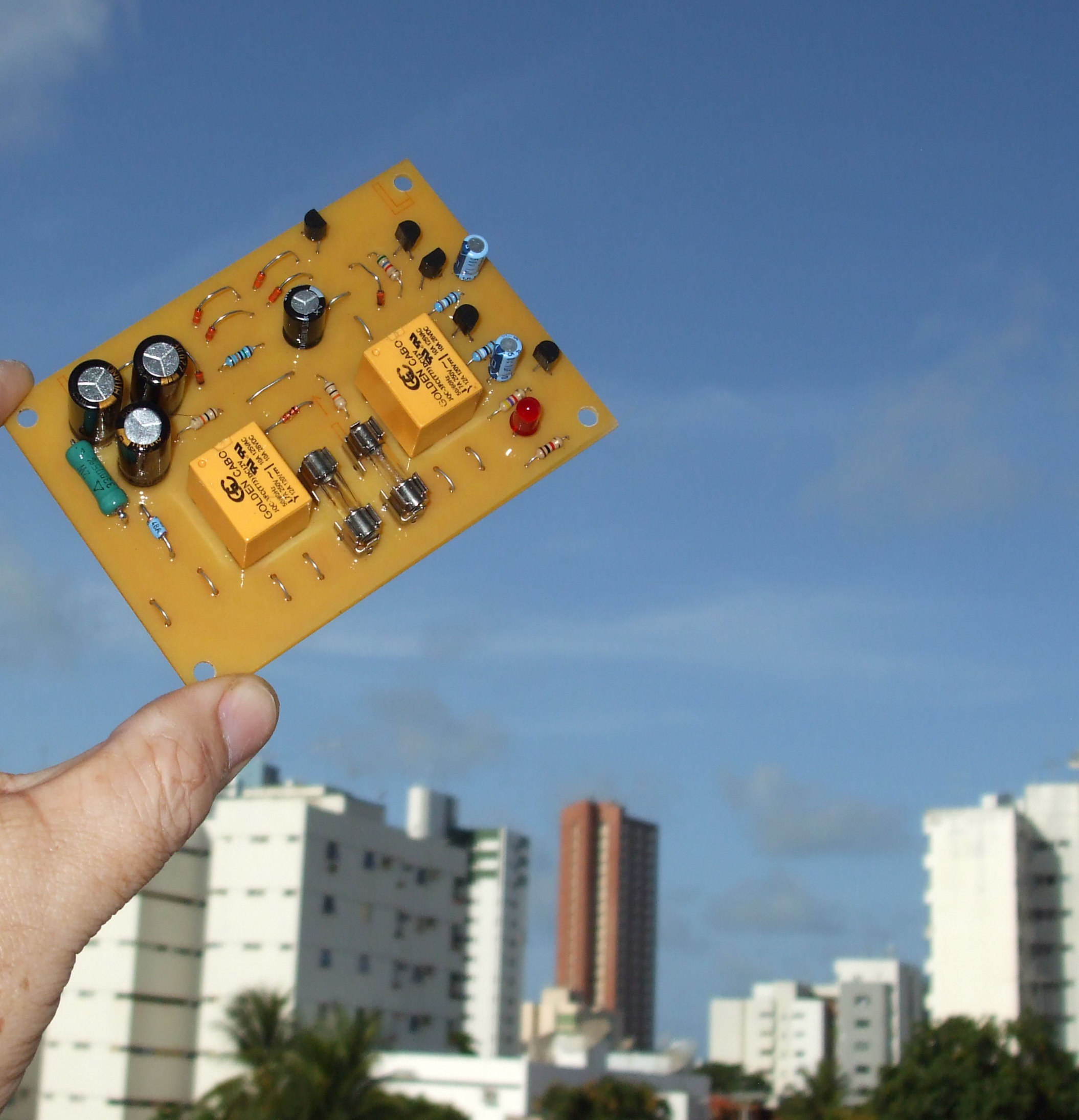

Speaker delayed insertion, speaker protector, off set sensor
having fuses too.
I found in a book...the board was made and sent me as gift, by Mr. Miguel Malheiros (Rio de Janeiro).
Soon i will assemble, adjust and test...if good...then will describe how it works and will post more details to the ones interested.
This is not a Dx Corporation Design...found in a book.... will inform you, the book name, and page, very soon.
In advance will see how this works.
regards,
Carlos

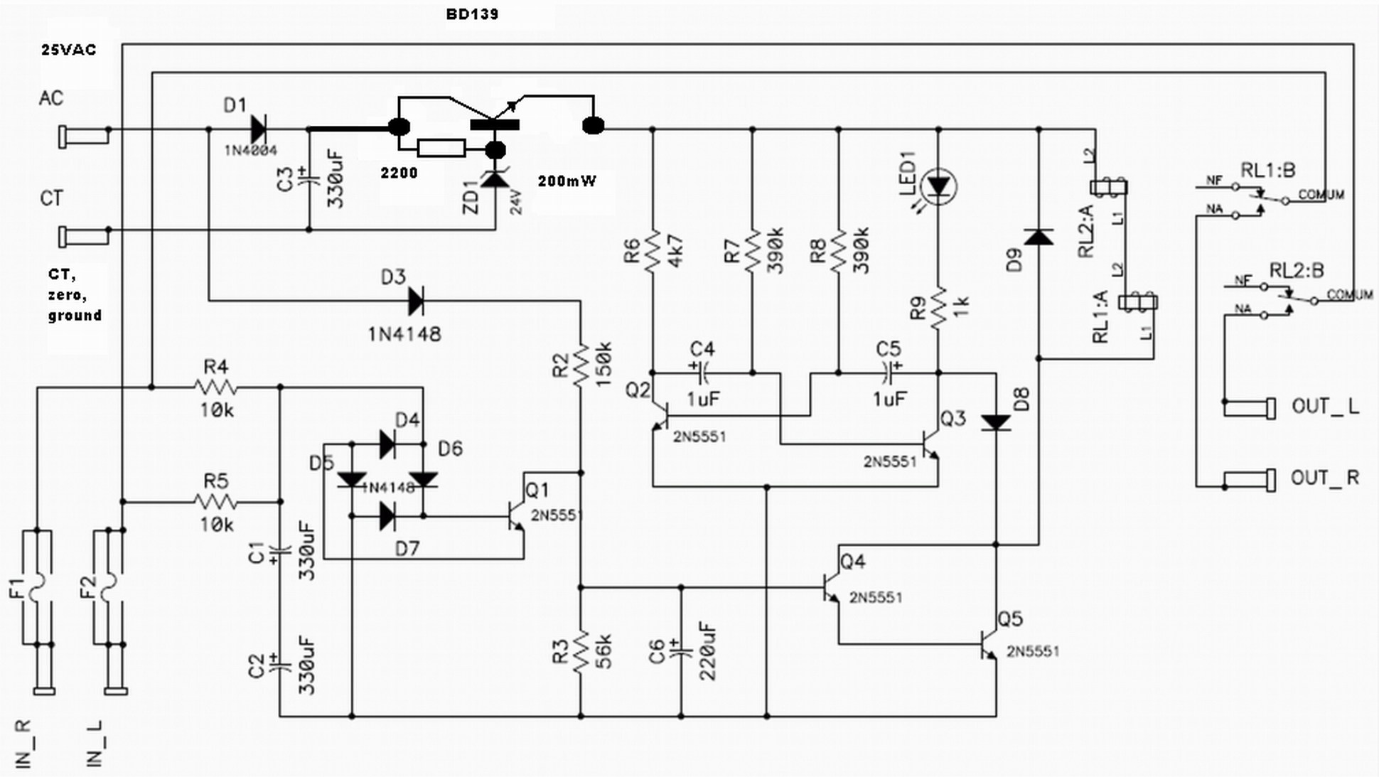

A friend provided me the PDF, produce the board layout..it is not a Dx design
That friend printed my name on it...but it is not mine...a mistake only.
Here you have layout..also the book schematic and the board schematic.
The book is "Electricity and Electronics, second edition - G. Randy Slone....book page 278
He is the designer, not me!
The book describes how this works...you can see just watching the schematic..but if result fine, then i will explain, describe, myself.
regards,
Carlos
I do not know if this will work fine, if there's some error on it or not
seems fine..but maybe some resistance adjustment may be needed, better transistor selection, or to test ours.... timing adjustment and so on.
Seems fine...but who knows?... sometimes we find mistakes...human mistakes or layout mistakes..parts inverted and so on.
I will assemble and will be happy to let you all know.
Soon.
regards,
Carlos

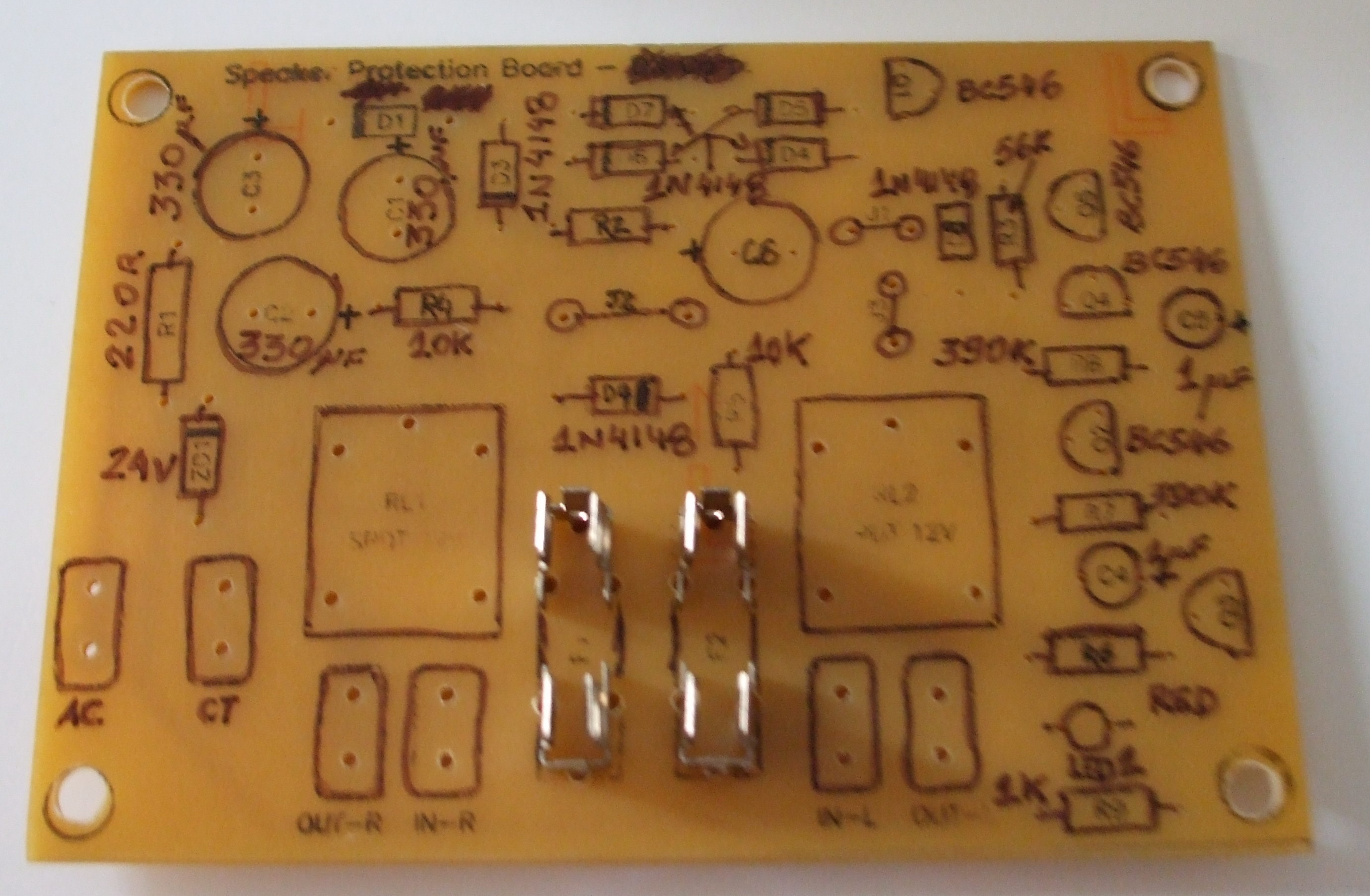

In my case i have to go downtown to buy parts.... exclusive travel to buy 1W zener
Not to go there..only because 2N551 and a zener diode...i will make some changes.... also i may use a 7824 voltage regulator instead these three parts modified.
Maybe Q5 will need a bigger transistor there....more safe....maybe a BD135 or BD139 or something alike...or TIP31C, or TIP41C
regards,
Carlos

Hello Carlos
Nice circuit, looking at the 1.jpg image, I remember that Cambridge Audio was using a similar but less developped circuit in the P40 amp.
The transistors Q2 and Q3 act like a flip flop circuit (in french we call that une bascule), wen there is a too big signal at output, Q3 will in a blocked situation and the protection are intering in fonction.
Thank for sharing this circuit.
Bye
Gaetan

We call here "multivibrador".....multivibrateur may be in your language...or "biestavel"
These are nice things...lamps goes flicking very low frequency while condenser goes charging..lovely effect..we can arrange Leds together the relays...so we gonna have a lot of ligths ....this is nice...hehehehh....i like that....maybe ridiculous to others..but i like signals..lamps flashing..these things.
This needs adjustment...to our own personnal tast.that frequency...also the ligth decay time..maybe some minor modifications will be done....i will do that those next two days.... then i will offer, not my design, but my work, follow up,.....my help.

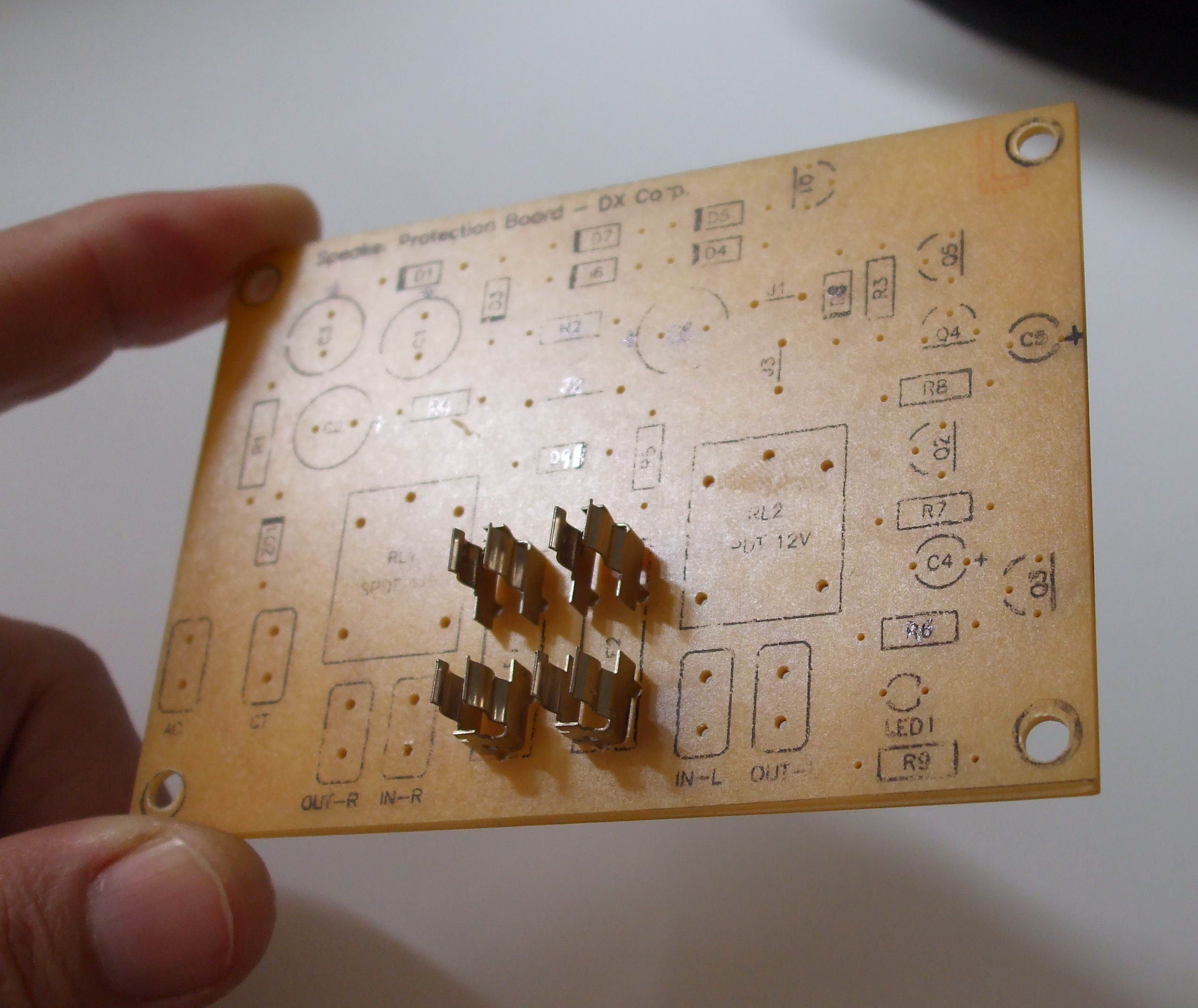

I am changing the silk screen, to help builders (if someone turns interested)... to use BC546, as this transistor has inverted leads when compared to 2N5551.
