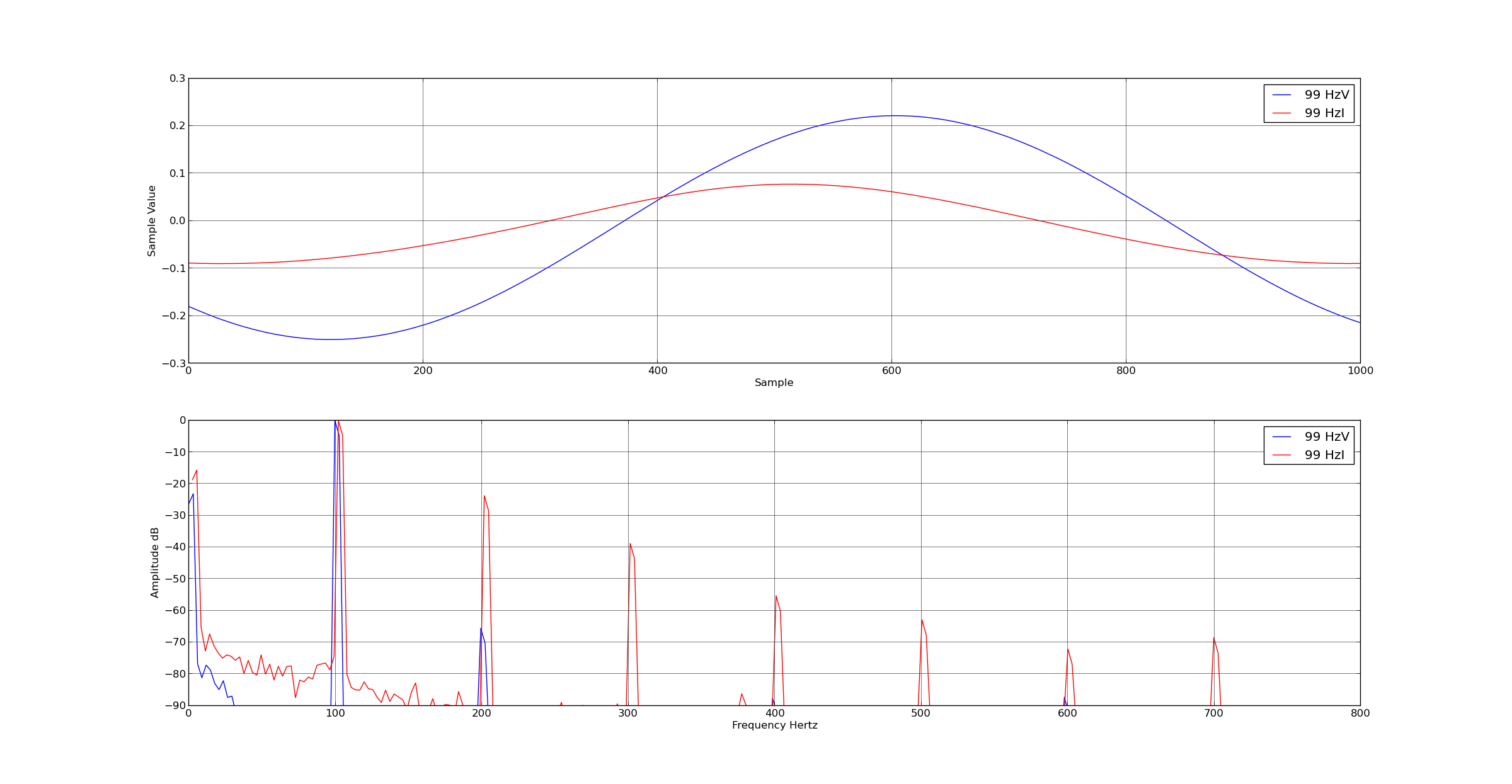

I have measured the current drawn by my speakers (see attached files).
As you can see the current has quite a lot of distortion, so if it goes through long (high-impedance) cables the voltage at loudspeaker terminals will be distorted in proportion to the current harmonics multiplied by the impedance ratio between loudspeaker and cable. Also, the cable impedance will change the frequency response. This shows bi-wiring may not be so snake oil after all.
However, when measuring the loudspeaker acoustic output (which has lots of distortion anyway) with and without a 0.5 ohm resistor in series, I did not find any change. But my microphone isn't very good.
So, maybe long balanced interconnects and short speaker cables make sense. Or just use thick low-Z speaker cable.

You could do a test, using a microphone, with and without 0.5R resistor in series with your speakers, measure THD and frequency response.
