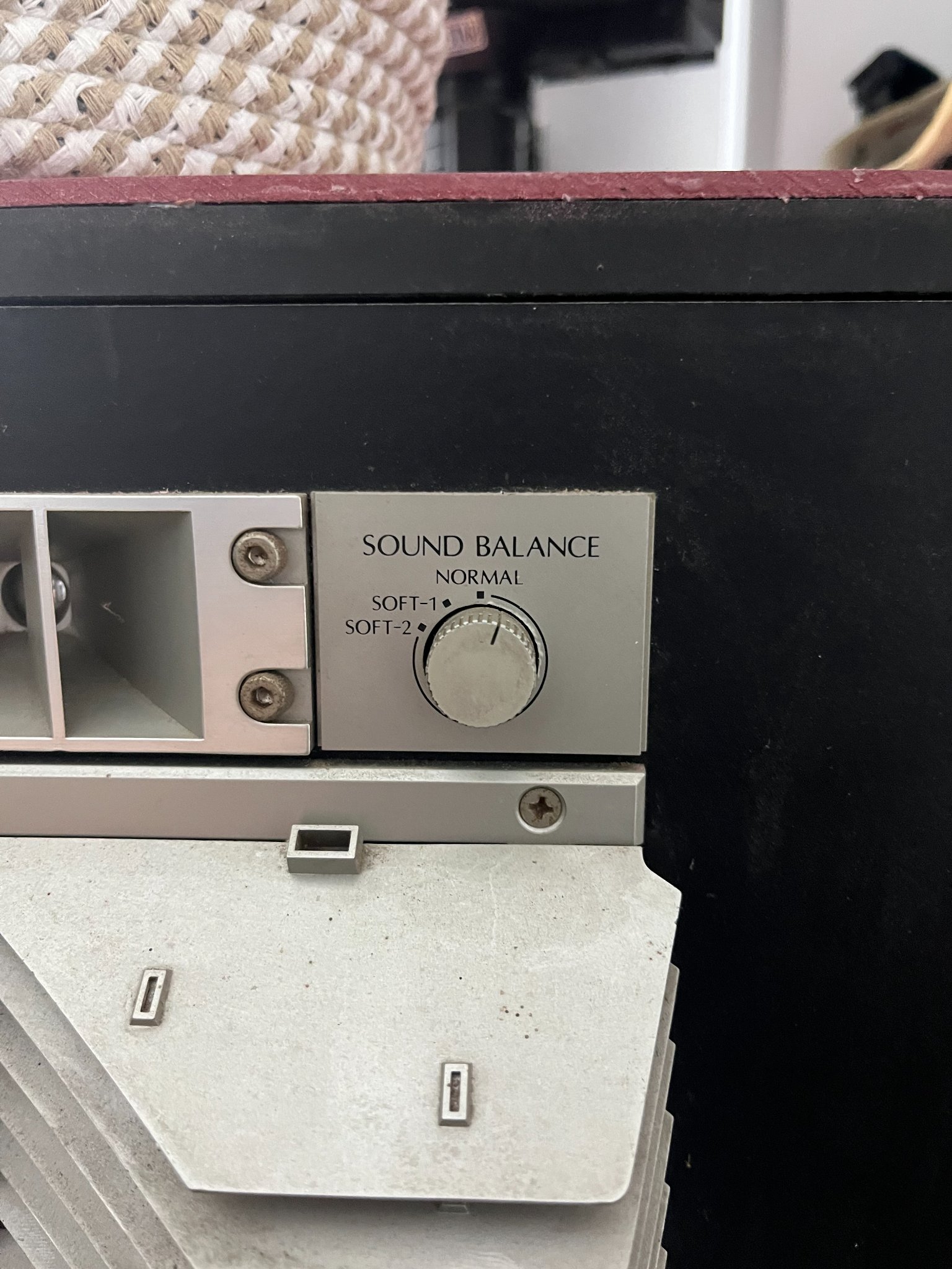

I am not sure but there is a tone control switch next to super tweeter, its kind of broken, is it possible that that switch has to do with bass? I couldn’t find any resources online to see what it does so i am blank on it.

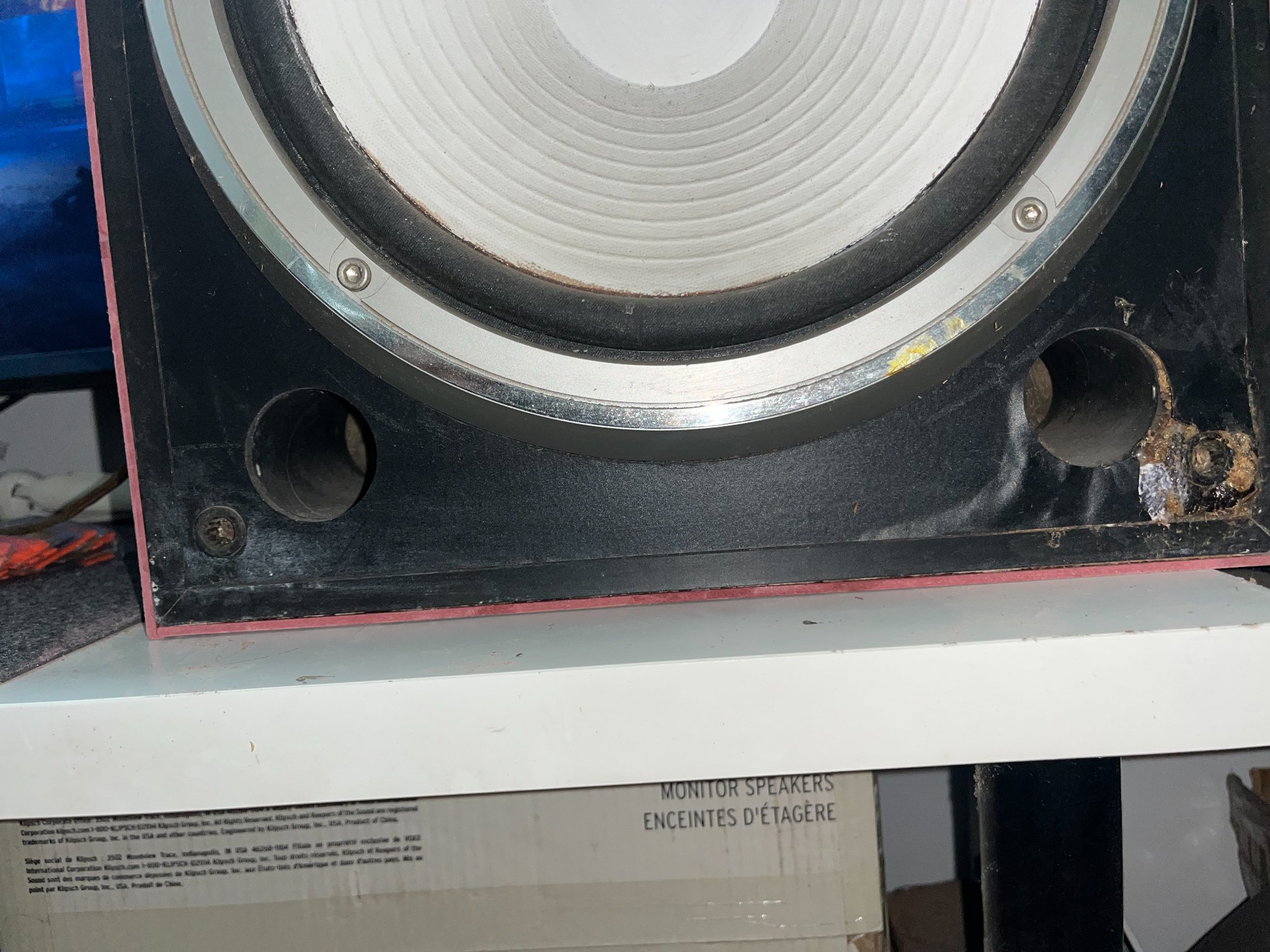

And yes these speakers have front port which are untouched. I have done anything there.

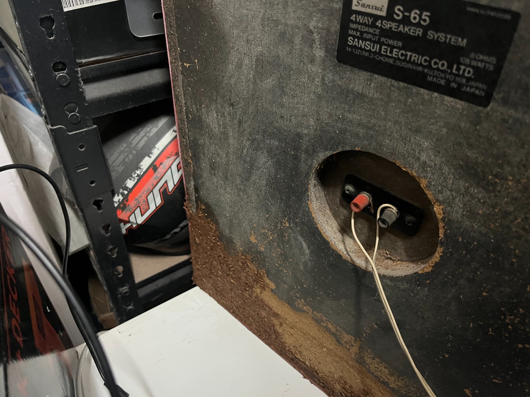

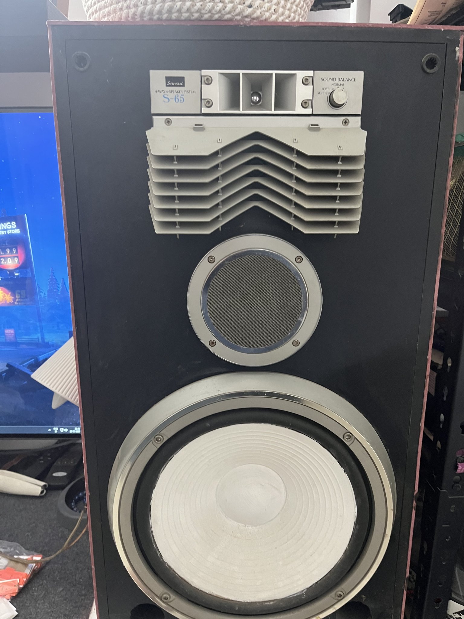

Thank you for the reply guys. I have added few images of speaker that i have added mdf to. And as you can see the damage on back of the body that was on sides as well so i thought instead of creating new box, i added new mdf to just support the current box.
but now what you guys suggest? Have i done mistake by adding bit of a MDF over the speakers? I mean if i play the both speakers currently, in normal case i dont think any one will get an idea that bass is not deep, but when i compare left right sliding amp knob i can feel that one is rumbly deeper and one is not so much like FLAT sounding bass. I feel so foolish i havent done this test... so either i dissemble the mdf panels, which will i think damage the body, or just take risk and add mdf to other speaker crossing finger that it will be as deep sounding as its right now and i find more solution.
By the way does anyone know if that has to do with Sound Balance knob on my speakers? I was thinking its for tweeter. I did not find much details about this speakers online so dont know.
