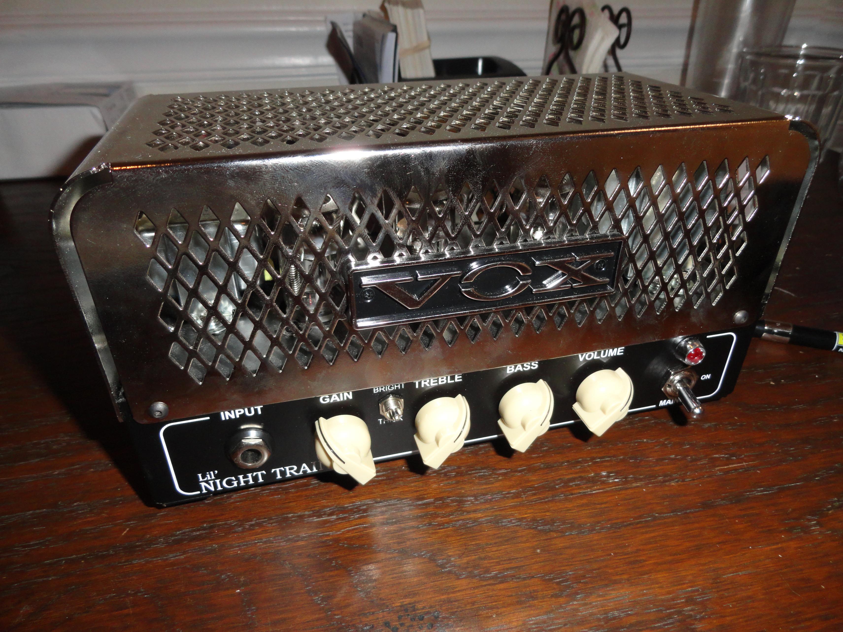

On a regular trip to the Guitar Center a couple weeks ago I stumbled upon a Vox Lil' Night Train tube amp head, used, cheaper than I've seen them before. It was purchased.
Now that I have a head I'm gonna need a cab. I'd much rather build one than buy one.

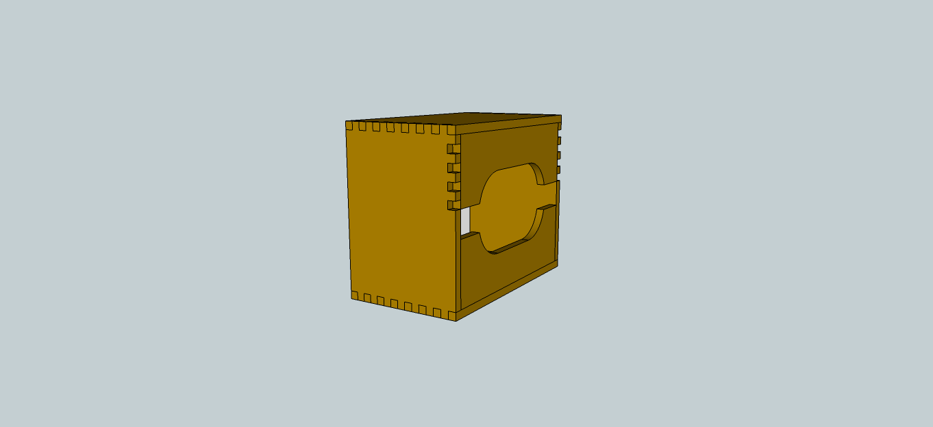

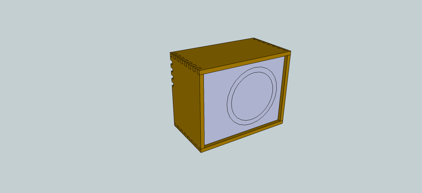

I've attached some pictures. I modeled my thoughts in sketchup on the box...still kicking round ideas w/ the finger joints and speaker panel... there's also a picture of my head and output reading.
Thanks for the help
Just some quasi random comments, feel free to ask for clarification:
Don't make the cabinet so square.
Use 3/4" plywood all around unless you want a very resonant cabinet. At least 3/4" for the baffle, this is where it matters most.
Use a 12" speaker - it'll sound more like a real guitar, less like a practice amp. No difference in ohmage, though some claim 16 ohms will use the whole transformer. Not sure that matters, or if it does, it's a good thing. But it's one of those ideas that has thought appeal.
The Vox cabinet uses a Celestion Greenback, my choice on a budget would be a Green Beret from WGS. They help smooth out the amp's crispy overdrive. (Great little amp, BTW.)

I agree to not go so square with the dimensions - that could encourage peaky response, though the open back should negate the issue. Also baffle size (the board the speaker is mounted to) will affect your bass response - bigger = more bass, so consider your application when determining size.

here's where im at
- abandoning the square box...going to something 16h x 20w x 11 1/4d
- i'm sticking with the 1x12s for the sides, and i'll go with 1/2 or 3/4 for the baffle, i'll see what i can get, maybe i can pick up a small sheet or a damaged sheet for cheap...if there's no scrap available
- i'm either going to brace all 4 sides of the baffle or route out for all 4 sides, to support it w/o a brace...i'll shim and glue it to prevent any rattling...probably going to stick with an open back, for simplicity if nothing else

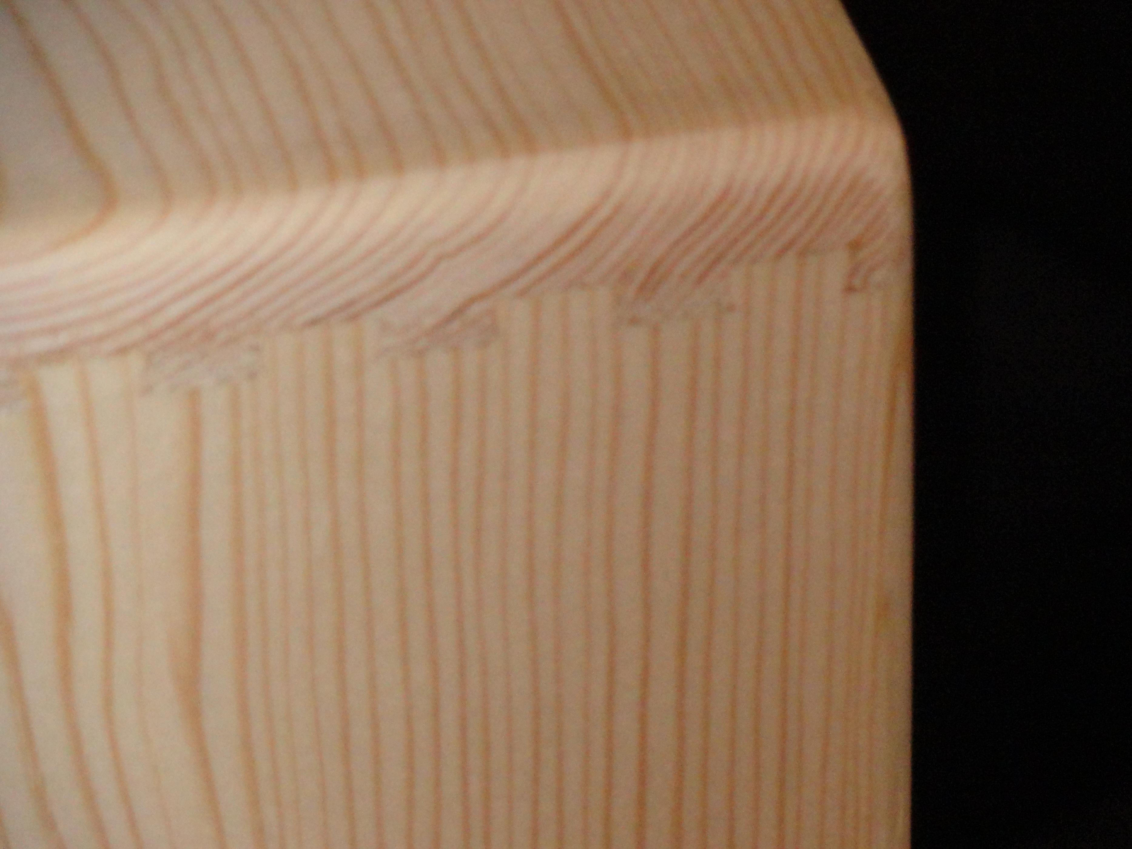

-instead of covering the whole amp i'm going to dovetail the joints...either through or half blind dovetails...partially because i found this jig at harbor freight for way less than half it goes for anywhere else
-i'm thinking about mounting the speaker off center on the baffle, i guess this may create a 'signature' sound, a little bit of which i dont mind, as long as it doesnt shake the thing apart.
-my understanding is that my head is going to have a little crisper overdrive, which might be well complimented by a warmer creamy speaker...i'm doing my best not to order a brand new speaker...1 to save money, 2 to hopefully end up with something a little more broken in...is there somewhere i can get a fairly comprehensive description or comparison of different model drivers? ive been looking at different celestron, gsw, eminence and a couple other names i've seen come up
-does the grill material serve a function (other than to protect and look good)?..this may have a hand in my decision
I'm trying to post pictures again...the ones from last time, my updated sketchup with dimensions and considered dimensions...and my new dovetail jig
let me know if these don't work...the only way i've figured out to post them is as attachments

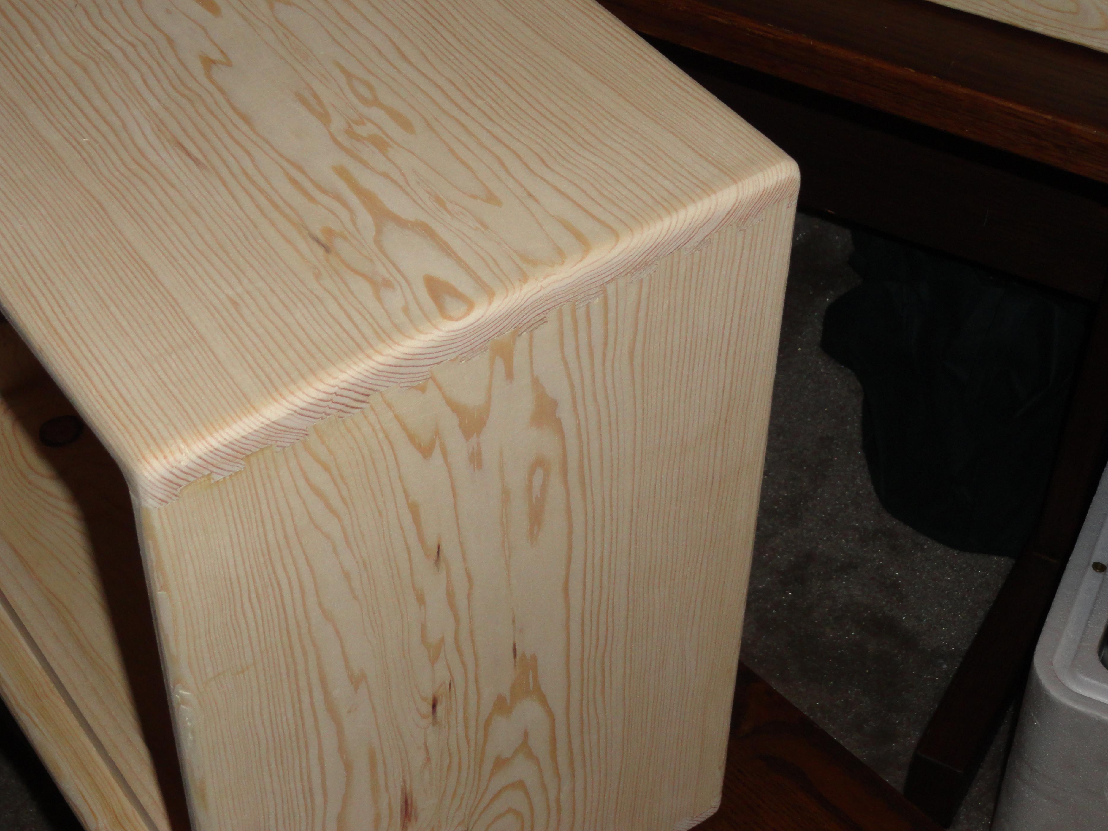

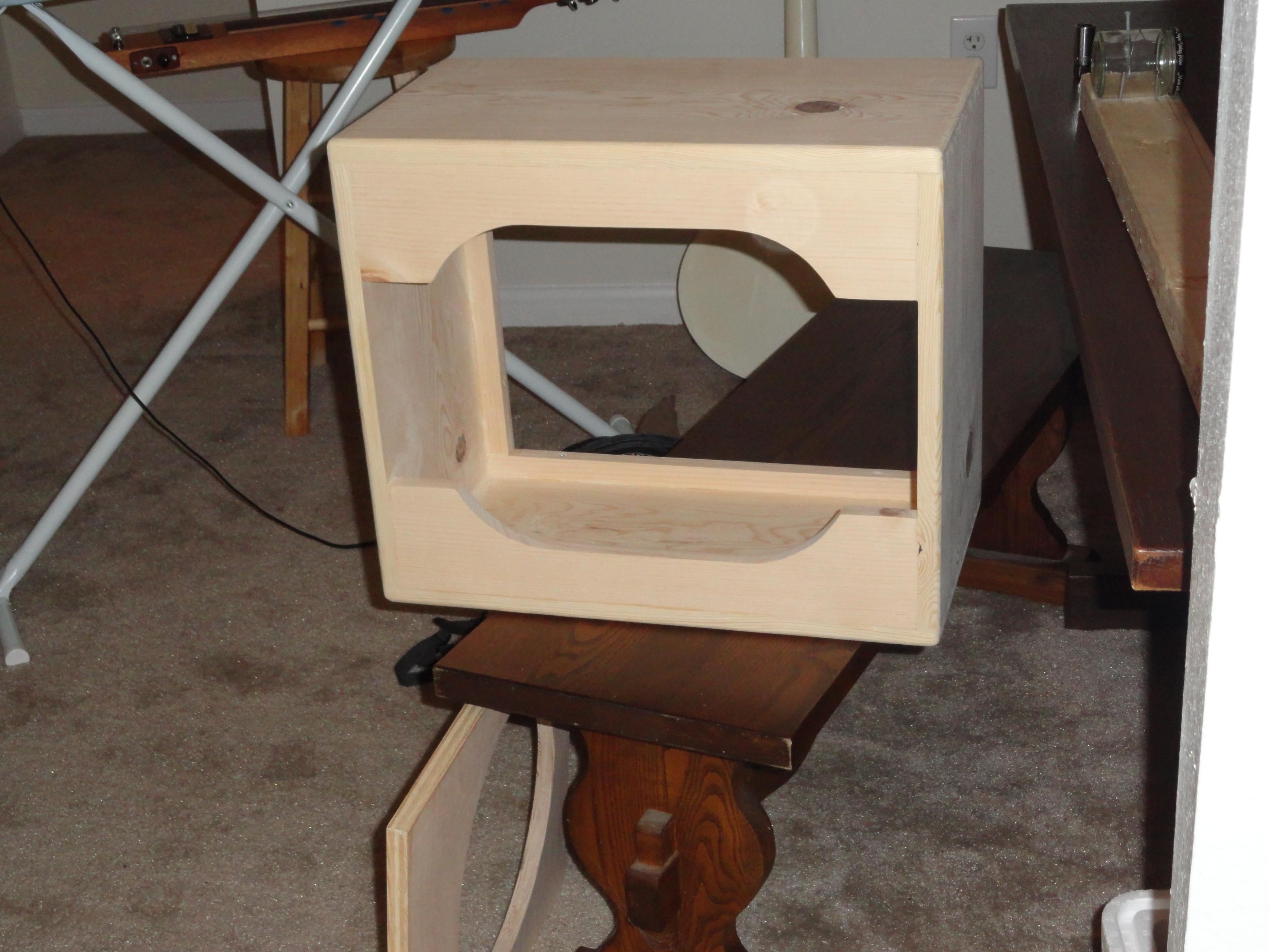

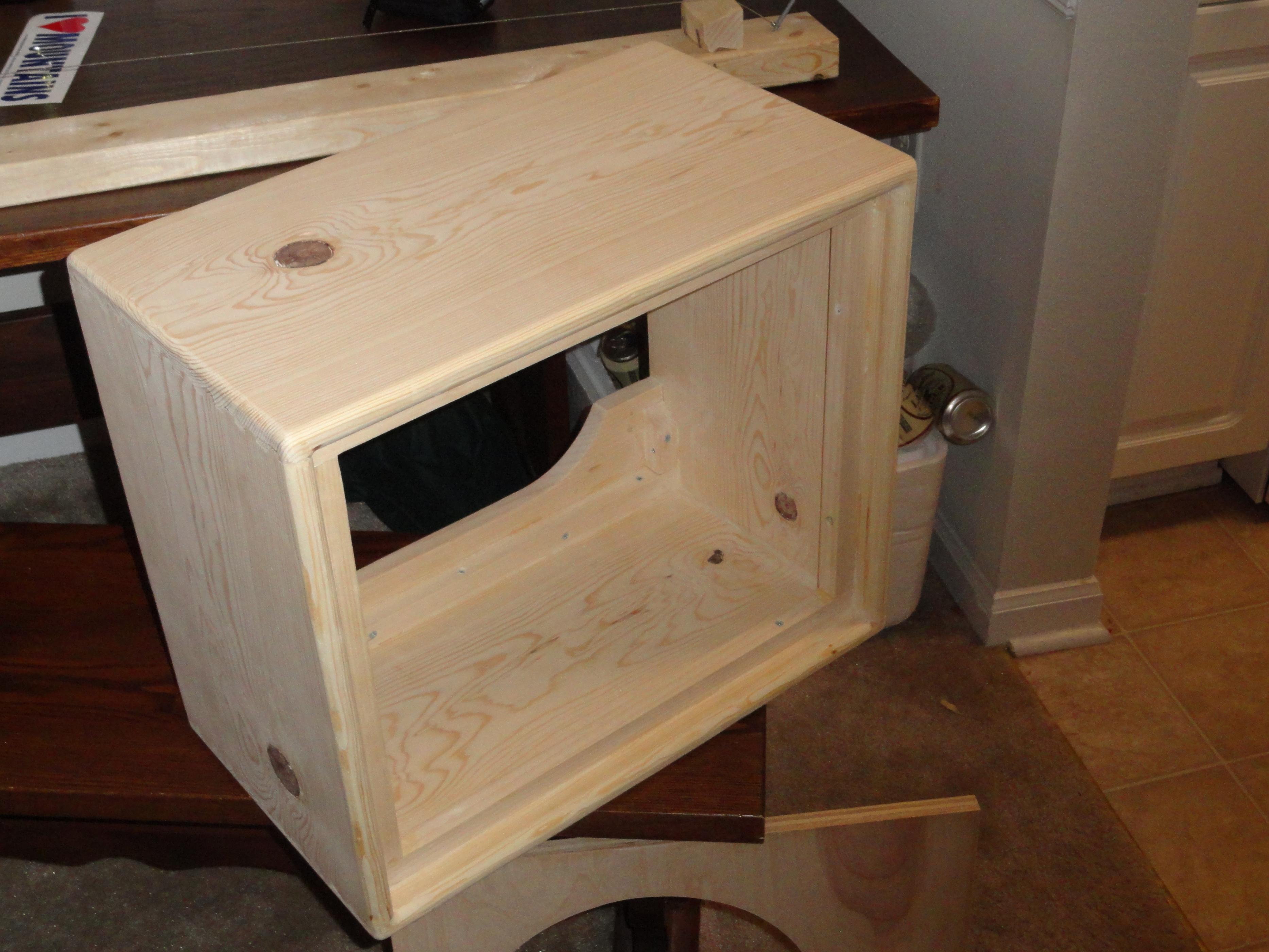

did work this weekend
put the cabinet together...half blind dovetails, open back, prepped the baffle for a 12" speaker...and sanded
just needs finishings now...for a finish i'm thinking a clear polyurethane, brown leather handle, and rubber feet (to keep it from rattling across the room)
my goal for the week is to get my driver, wiring, a jack...i'm gonna give the used gear hunt a day or two more then order something...so i'll be doing my homework this week
i'm posting some pictures, hopefully you cant see the wood filler....

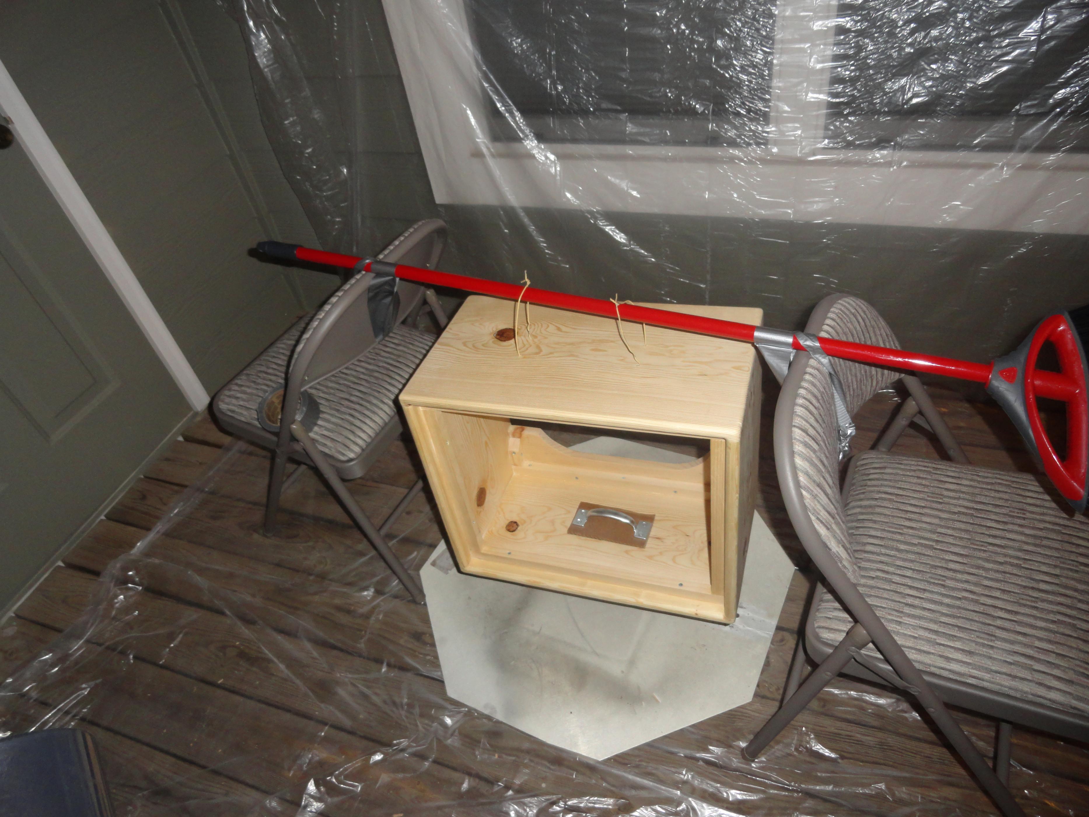

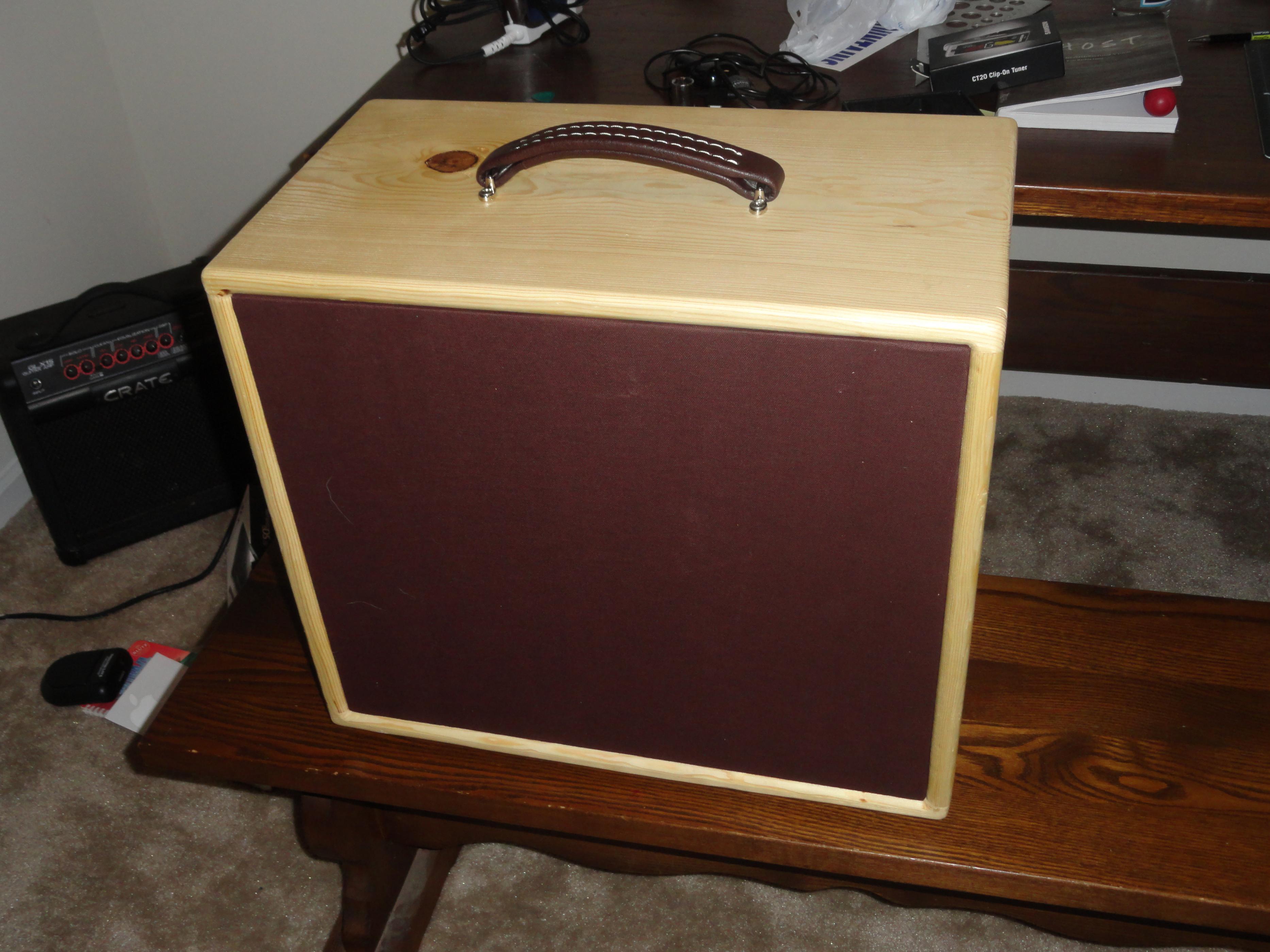

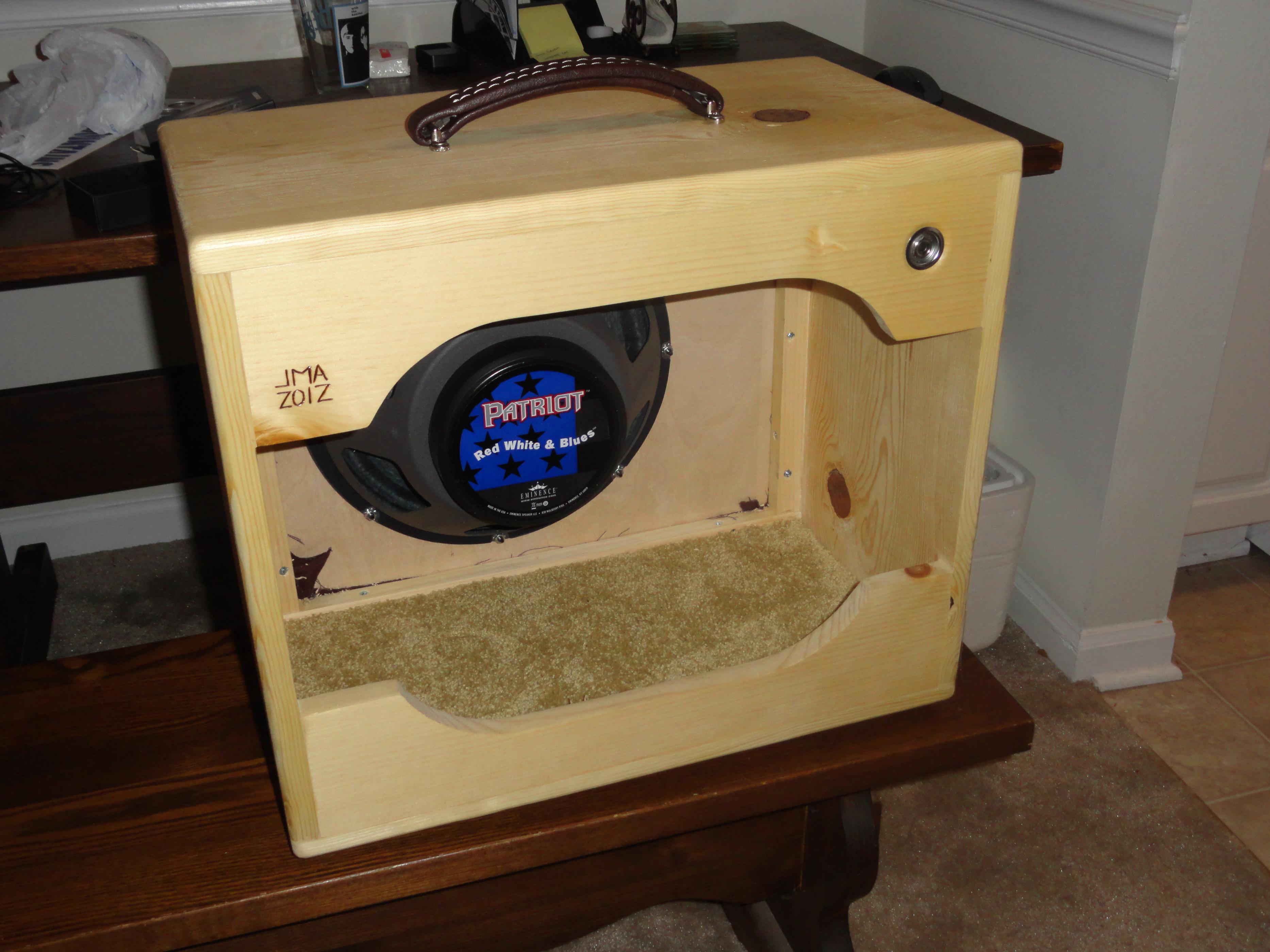

Finished this bad boy up.
I'm pleased with the sound and the style.
I sprayed on a clear polyurethane...used a fender style brown grill cloth...brown leather handle...i rigged up a fender ferrule and an enclosed 1/4" jack...i had a scrap of carpet lying around that i trimmed to size and fitted in the bottom of the cab
the used driver search failed be so i picked up a 12" eminence red white and blues...and mounted it to the back of the baffle
The only thing i'd change is i'd put the handle on the side of the cab, so i have more room to set the amp...rookie mistake
some pictures are below (including my patio/garage paint shop)
Thanks for all the help
