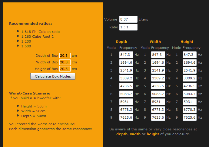

Modes for 8" X 8" X 8" below: from mh-audio.nl
attachment.php
Tony.

Possibly unrelated but your length is very close to being exactly double the width. In general, it's better to use some variant of "golden ratio" to avoid the modes from interacting (big sums and/or dips). For example (ignoring volume for the moment) if one dimension is 10", then the other two could be 6" and 16" (i.e., a ratio of .6 to 1 to 1.6 is one option).

I can't seem to get things right with the golden rule because I either end up with the short side smaller than my speaker or the large side too big to fit, but I noticed the website for calculating resonances mentions "cube root 2" ratio of 1.26 as another recommended ratio, My new box idea came close to that at 1.19, so I thought why not make it come out to 1.26 to see what happens, so I looked up how to implement this and it looks like if I make the middle side = X then X*0.7939 would be the short side and X*1.2599 would be the long side.. I decided to keep the same volume of 512 Cu Inches and did the math and figured that if I kept one side 8" then my short side would be 6.35" and the long side would be 10.08" This will make a box that will fit where I want to put it nicely, so I'll give it a try. This will also have the same internal volume as my last 2 boxes so I can try them all side by side by side... with and without stuffing and see what happens.

The results are in! Yes, resonance seems to be what is happening. I went ahead and built the "cube root of 2" box and while it did not have the cool resonant sound I liked on the 8x8x8 box, it was much more consistent of the three. Apparently the resonant effects can either add to or subtract from the sound depending on the exact frequency. I got some fiberglass insulation, about 12"x16"x5" pieces of it and put it in all the boxes... don't really know what I'm doing, just randomly got some and put it in there... I was having the listen very hard to detect any difference at all between them then, and they all did sound pretty good. I had another box I made that was a lot smaller, 8x8x4, and no matter what I did to that one, the sound just seemed dull and muffled, it was probably not enough air space for the speaker to work right.

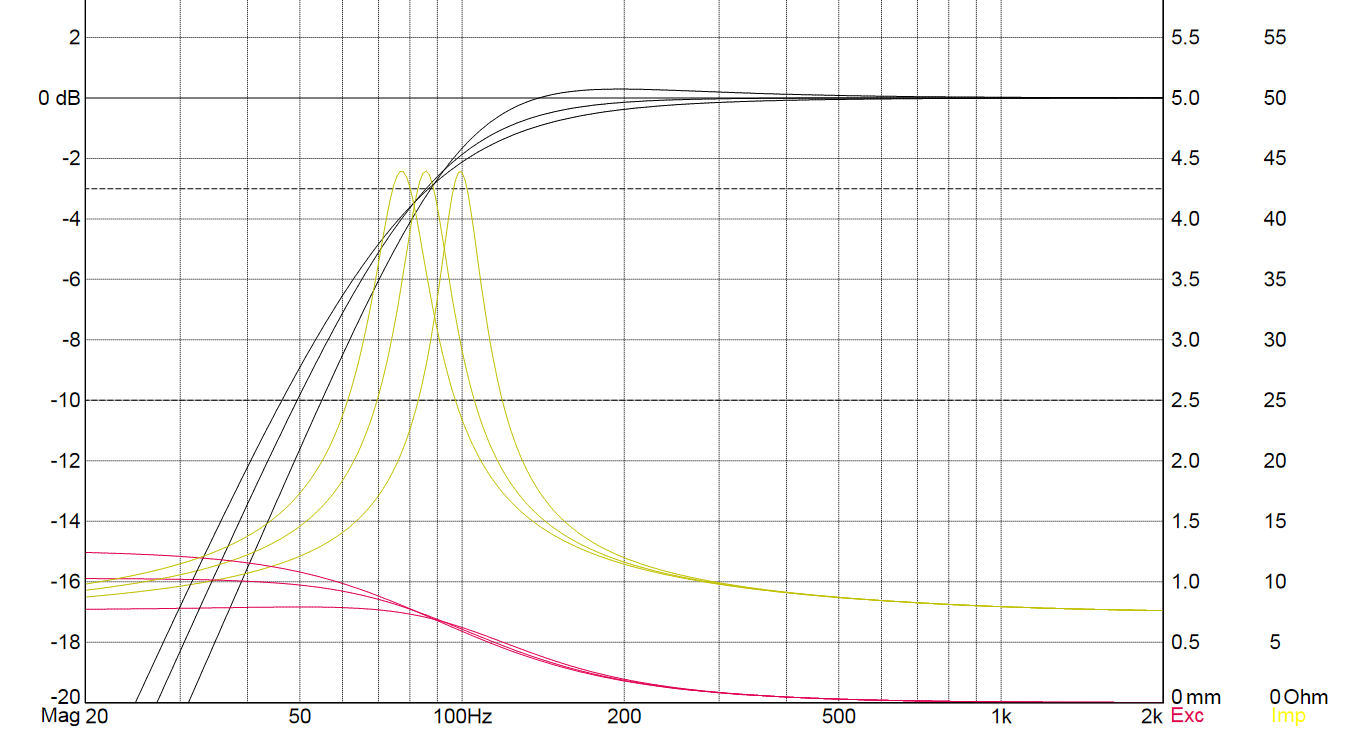

Mine sealed boxes nearly always end up full stuffed with loose fiberglass. Stuffing adds virtual volume seen from the driver think it's something like up to 30% volume stuffing can add, and can be measured looking at the resonance peak when drivers impedance is measured sitting in the box.
Add a picture of simulation to help understanding, the three plots is sealed box and have approx. 30% internal volume in difference, the one with overshoot and steepest cut off of low frequency is the smallest box volume, a spec where the smallest box win is it makes the best spring brake so the Xmax of cone movement is the least movement seen in red plot. The yellow plot show driver and box cooperation which makes a resonance spike where the one at right belong to the smallest volume, guess now you can figure out which data belongs to the others, and at the -3dB and -10dB lines you can see the largest box have the lowest frequency extension at these points.
Sound from back of cone is at opposite out of phase as from front of cone therefor in sealed box needs to be dampened/isolated out, in other box types the tech art is to mix low frequency front and back waves together in way they add correct instead of distort or cancel each other.
