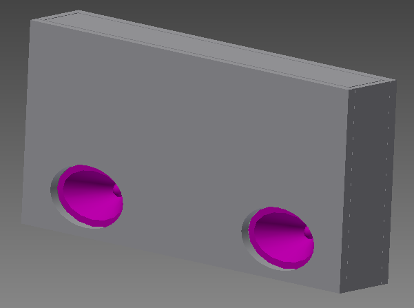

I am pulling together a speaker box to house 2 X 6X9 speakers and class D amp for my TV/media pc and am looking for some advice.
The plan is to somewhat hide this speaker box behind the TV in a vertical orientation. See attachment. My wife does not want to see the speakers so I need to make the most of what I can.
So questions:
1. Is it best for an open/port design like some posts I've read or sealed?
2. With the spec below I am having trouble using online calculators to calculate the volume of a speaker box - is Fo the free air resonance?
3. I will also need to try to deaden the sound behind the speaker box as this is a common wall in a block of flats - is this done inside or outside of the box?

OTOH, if the 6x9 are car audio drivers, most of those are designed to work in at least somewhat "leaky" if not actually aperiodic enclosures - i.e. the old trunk decks, doors - including rear doors of vans, etc.. Some type of vented might give better low end extension, provided not tuned high enough that drivers are unloaded below their resonance if not high pass filtered before the hand-off to the 8". The natural acoustic roll-off in smallish sealed box could certainly protect the drivers from over-excursion, but might be high enough that bass image locations could wander if the woofer is more than a couple of feet away.
Thank you for the replies guys.
I'll go for the filled sealed enclosure of 0.2 to 0.3 cubic ft. As this will have the 8" woofer I am less worried about missing out on the lower frequencies from the 6X9's. The woofer speakers range is 38Hz-4.5kHz but the amp has some low pass filtering which can be tweaked to help the system response.

There is essentially nothing effective you can do for the common wall short of building another wall between you and the neighbor. You could mount z-channel to the wall and mount 2 thick layers of drywall to that with "green glue" between them, or you could add a whole separate wall cavity spaced away from the wall, stuffed with fiberglass and multiple layers of drywall on each side. If your flat is not on a poured slab, you might reduce transmission via the floor by mounting on some sort of spring or rubber vibration isolators.
