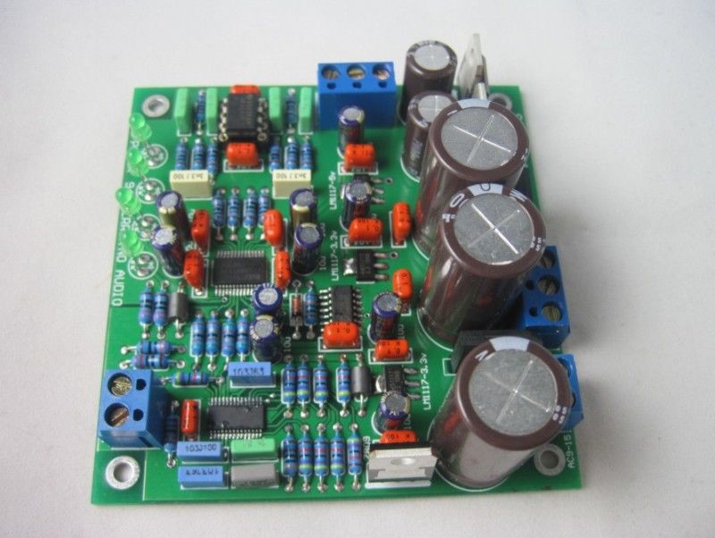

Some time ago I built this DAC and connected it via SPDIF (coax) to my CD player. Sounds great... no problems.

- Yes, The receiving DAC is capable of 24/192.

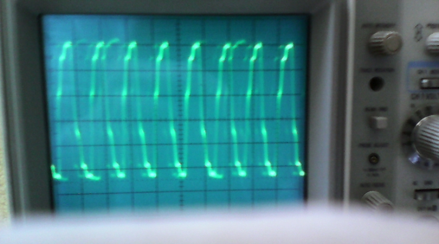

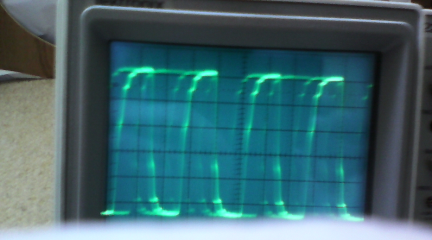

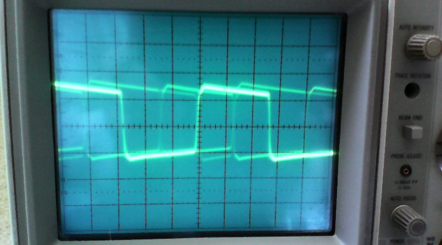

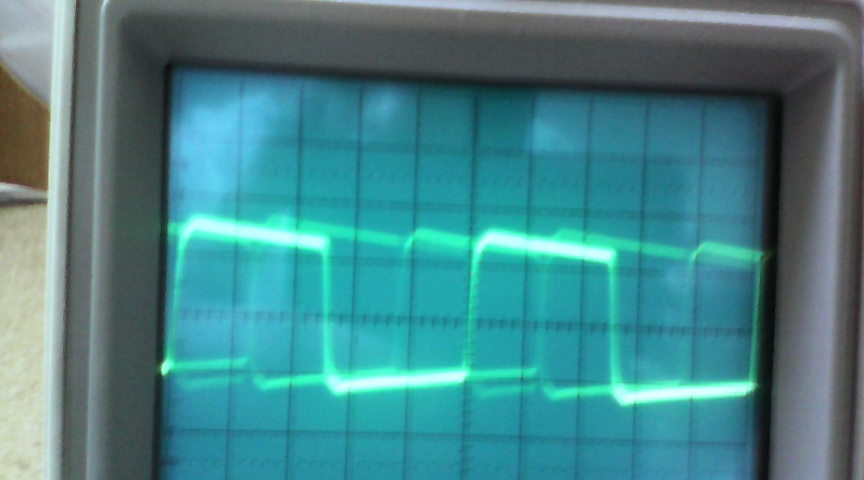

We've got a view!

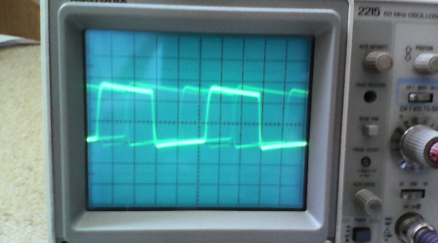

Finally I've got the pics.
The first series is measured on the Sound-card chassis terminated with 75ohm.
44Khz, 48Khz, 96Khz and 192 Khz
So, this is what leaves the sound card
In the next mail I'll post the wave-forms at the end of the cable not terminated.
In the third mail, you'll see the wave-forms entering the DAC (which I yet have to make)

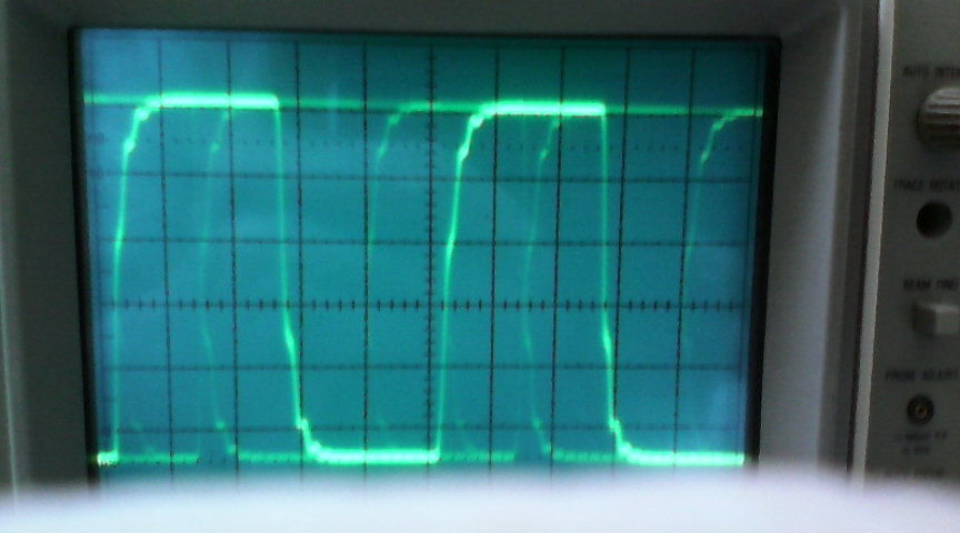

2nd series...
Now measured at the end of the cable NOT terminated

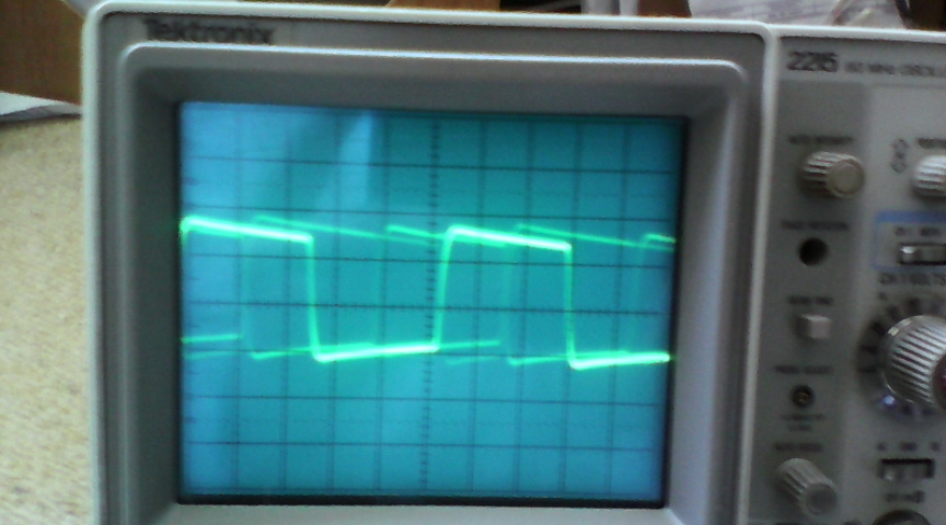

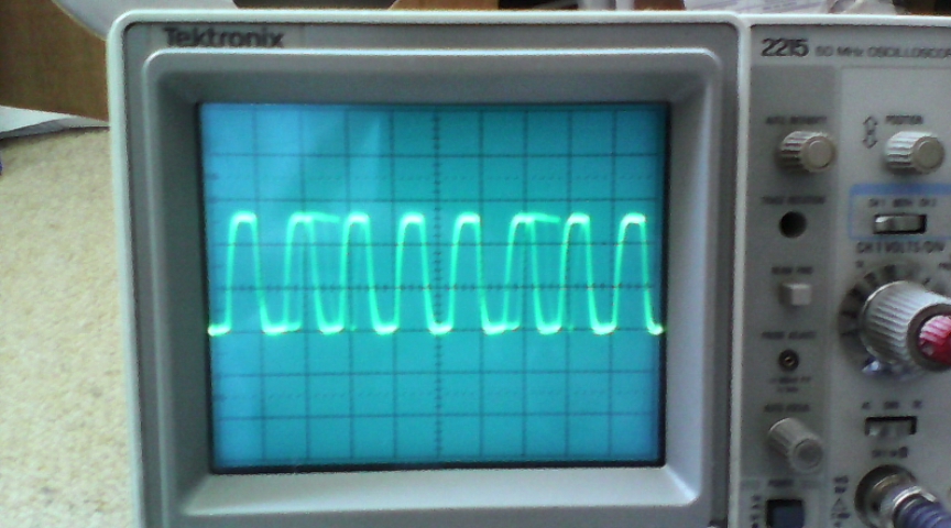

And the last pics
This is what the DAC sees at the entrance :
44Khz, 48Khz and 192Khz
To me the wave-forms do not look too bad.. but what do you think?
The voltage settings are 20mv/div + 10x on the probe (so 200mV/div)
