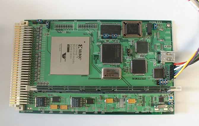

Still, the subject of FireWire interfaces is intereting. Will FireWire be practical for the do-it-yourselfer? It is a very complicated protocol with expensive chips and lots of proprietary firmware.
jwb said:Will FireWire be practical for the do-it-yourselfer?
Unless cheap single-chip solutions emerge that form a bridge between FireWire as used on commercial audio products and a much simpler audio data stream format, FW indeed will remain off-limits for audio DIYers and even for smaller audio manufacturers.
It took one of our engineers more than a year to master FW completely and build an in-house implementation that is operational at al levels of the protocol, using commercial phy and link chips.
They should have contemplated IEEE1355/SpaceWire, which is infinitely simpler and offers the same kind of datarates.

Thanks for the info Werner. I too have been watching for a single-chip firewire solution. I like the isochronous transport and channel division of the protocol, but so far I have been unable to use these features except in software on a full-blown computer.

Firewire chip
Check out this suggestion by nuppe in the PC music player thread:
http://focus.ti.com/docs/prod/folders/print/tsb43cb43a.html
-Robert
-Robert
Re: Firewire chip
Thanks Robert. I had a look but retreated, baffled. Sadly, I have to own up to the fact that if I lived to be 100 - or even 200 - I'd never command the expertise to make use of this myself. I noted the modest price (US$11.40 for quantities of 1K+).
I suppose that Island Digital employed the TI chip in their 'Spigot' connector concept (recalling that TI was associated with the press release announcing its development).
Do you think that there's any possibility that anyone will incorporate this chip into a consumer product enabling Firewire-spdif connectivity, given that MS presumably acquired the rights to 'Spigot' with the aim of forestalling any such thing? There must, surely, be quite a significant demand for such a connector?
Any theories as to what MS's game is?
RFScheer said:Check out this suggestion by nuppe in the PC music player thread:
-Robert
I don't think we will ever see a simple 1394 to I2S/SPDIF interface chip ready to solder in (plug and play) for a number of reasons:
1. Copy control. The 1394 data is encrypted (requested by RIAA) so that you can't copy the precious DVD-A and SACD disks directly. If there was a single chip solution to get to the data then this would most surely violate the DMCA (in USA).
2. Industry control. Sony, Pioneer, Philips and the other big players like these complex interfaces because it creates a "higher cost of entry" to the market and keeps the small hi-fi companies out. Since Sony and friends are among TI's biggest customers, it is not in TI's interest to develop a chip that would remove this barrier. However TI is more than willing to refer to a third party vendor who would develop the necessary software for around $100k.
Sorry for the pessimistic post, I would love to be proven wrong.
On a positive note: Since this is DIY we are free to design better interfaces between transports and DACs ourselves, only problem is they will not be compatible with anything else out there.
