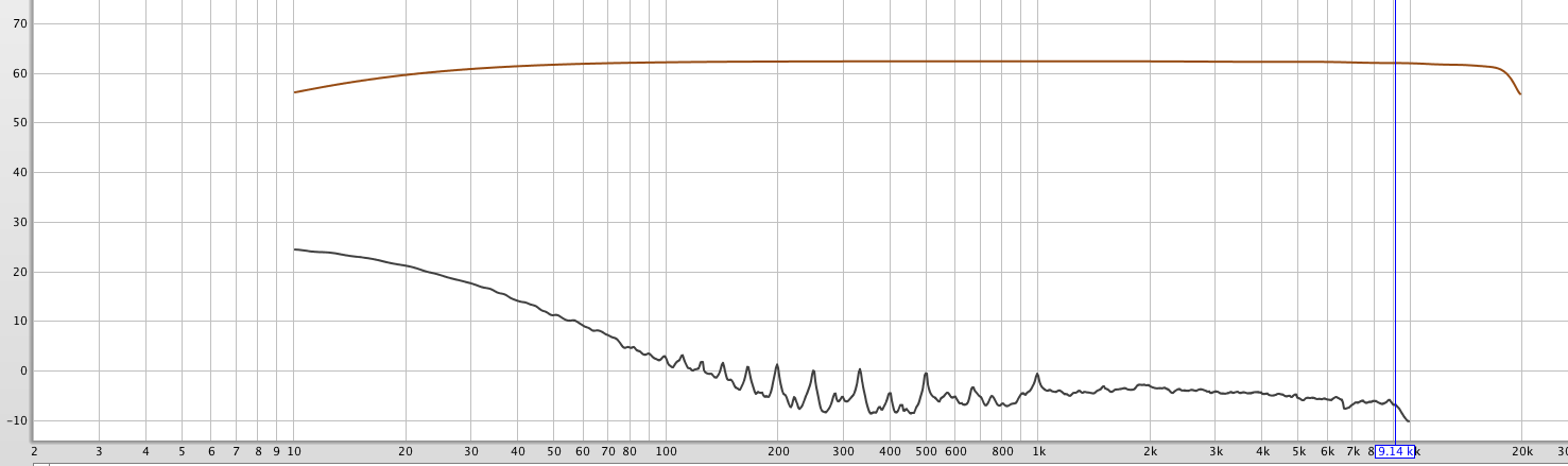

I tested some Pyramid analog isolation transformers that are mostly sold for medium-fidelity car audio systems. No more than about $12 for a stereo box (two transformers) with RCA-jack hardware on eBay.
Using REW test software, the two transformers were identical. They were flat within a dB or two 15-18kHz and except for the lowest frequencies (where your woofer has 5% distortion), the total harmonic distortion was below .1%. I was surprised. Good enough for me.
No need to take my word for it, see graph.
I had a little bit of audible hum in the modest audio system at my vacation home. Transformers fixed hum completely.
Ben

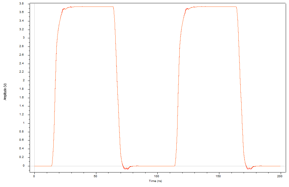

Even with long cables you don't get to many problems, its not high speed digital and to be honest most digital is not controlled impedance near enough will do. I put a couple of sim. shots up yesterday done with a 500mm 50R cable and a 1500mm 75R cable no problem what so ever. If it was a DDR3 interface or similar then I may worry....
Reflections occur at any impedance mismatch

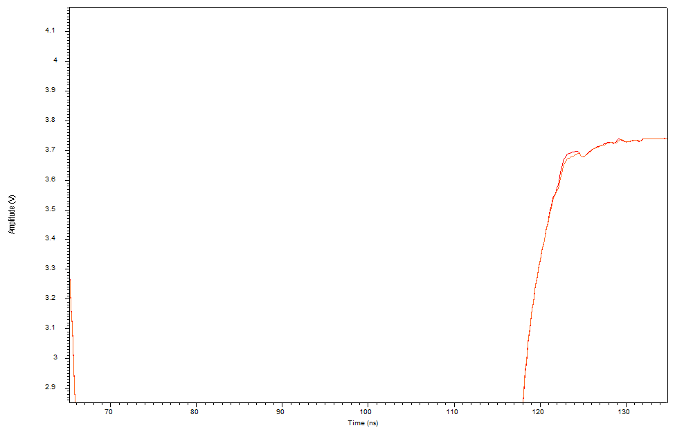

The reflection is minuscule, probably hard to tell the difference between a 50 and 75R connector on a scope, doing a simulation I could pin point a very small reflection and I had to zooooom in. Consumer with short distances it isn't a problem, for pro gear the distances are often greater so it can be more of a problem.
Attached is a close up of the difference between a 75R and 50R connector, the PDF is the schematic for the simulation.

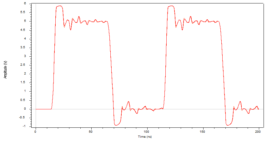

More critical for SPDIF signal integrity is the terminating resistor at the end of the line, the sims below show the difference between a terminated (right) and un-terminated (left) interface... especially if the drive is strong (fast rise time).
