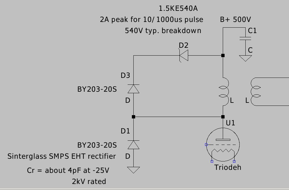

Meanwhile, the transorbs have 100 or more pF of capacitance, and it might be better to buffer that with some low-capacitance reverse-biased EHT diodes. And, the Tranzorbs stick ON when struck, so referring them to B+ might avoid needless fuse blowing....
The Sowter SA08S OTs I use are tested at 2.5kV. Here is the starting point for a protection circuit for these, if needed.

If I were going to go with this sort of a thing, I would use back-to-back 1.5KE series transient suppressor diodes, as well as a little bit of load on the output. I feel safer with the transient suppressor diodes that clamp to a constant voltage rather than spark gaps or gas tubes that can fire at a high voltage, then collapse to a low voltage (arc discharges do that, especially with DC behind them) and blow out the power supply and/or the output transformer. Back-to back transient suppressors with a series resistor, in conjunction with a paralleled MOV or two across the lot may be an option to protect against serious abuse. A small bit of load on the output is an option to keep all the power from being dumped into the protection network. What you're really trying to guard against is having no path for the charged-up primary and leakage inductance to discharge besides the transformer insulation and the tubes and sockets. A preload can take care of a fair amount of the energy stored in the primary inductance, while the protection network will get the leakage energy that cannot be transferred to the secondary. Blowing some power in a resistor to me is a far more acceptable alternative to replacing fried output transformers, tubes, and tube sockets - what a PITA...

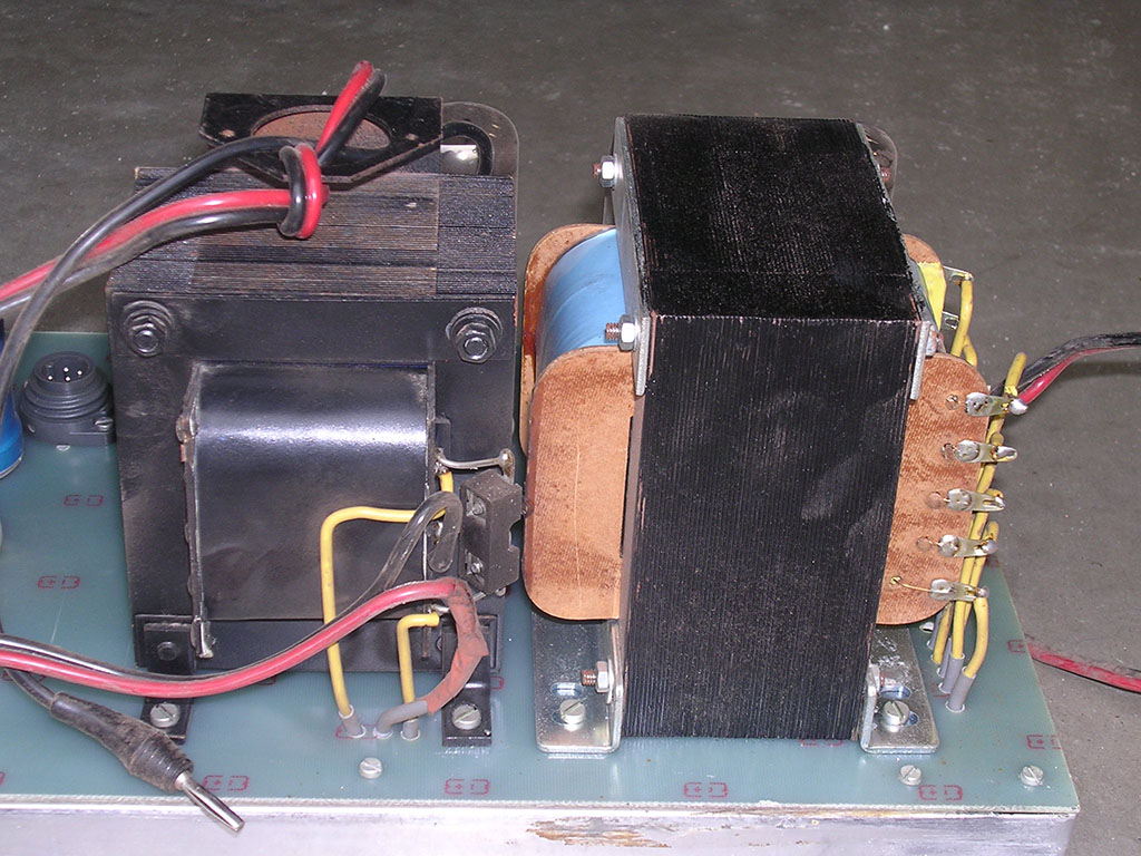

In my power (2 kW) amplifier for PA purposes I use spark gaps for protection of the output transformers because I can not see if my load is always there.
Sometimes there is about 1000 meters of speaker cables connected over the streets, and I cannot look 24/7 if something is wrong with the load.
See picture
See picture
