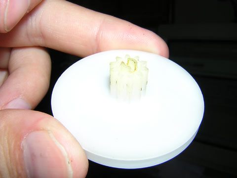

I have a Marantz CD72 CD player which from reading all the forums seems to be very popular.
Last week the pully/gear that drives the CD tray in and out lost some teeth. I cannot find in the forums where I can get a replacement gear in Australia (or anywhere else). I have also spent several hours searching Google and contacted the local importer/distributers (Qualifi).
Can anyone advise where I can get a spare gear preferably in Australia?

You mean this one?
It was taken from a cheap Philips 162/164. I bourght the Philips because I needed a CDM-4 replacement for my CD72mkII. The rest of the tray mechanism looks similar, only thinner and more cheaply made. The wheel and motor, however, looks the same.
My guess is, you can get any cheap Philips machine and use it for spares. This way, you also have a CDM-4 replacement just in case...😉

Looks just right except mine is orange, but who cares about the colour as long as the tray goes in and out!
A brilliant idea about the Philips player. I will go out a search for one straight away.
The website in Malaysia that was advertising spares wanted about $28 Australian dollars for a wheel. If it is of interset to anyone it is
