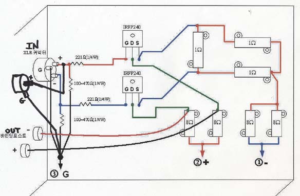

I would like to have balanced and unbalanced inputs
on the SOZ i will be constructing. I am using
Seungyun Lee's great wiring diagram to help illustrate
my question. Have a properly wired in the unbalanced
input? Thank you for your time and consideration. I
can follow directions, but am uncertain when i go it
on my own.

I think you have made it totally RIGHT.
It will work.
Is the input only 100-470 ohm?
What is used to drive this circuit.
I guess not an OP-amp output.
/halo - likes low input imp - but 100-470 ohms 😕

Oops, sorry. Didn't mean to be confusing.
If you intend to use the amp single-ended, ground the other phase of the balanced input. Your diagram has disappeared now that I'm in the reply thing, but I recall that you had the + pin of the balanced input hooked to the + of the RCA jack. In that case, short the - phase of the XLR jack to ground.
No, you don't <i>have</i> to, but it's better that way.
If you're going to use the balanced input, unshort the - phase. No further action needed. Do not short the RCA plug.

Oh, one other thing...the SOZ doesn't do such a good job of being its own phase splitter. There's not enough resistance under the Sources for that. If you use it single-ended, you'll get a somewhat lop-sided output, with one side doing most of the work. Distortion will be somewhat higher as a result.
That's not to say that you shouldn't do it. Just be aware that it's not optimal.
A current source under the differential's tail will take care of the problem and increase the efficiency of the circuit in the bargain.
Grey

Put the gate resistors at the gate of the mosfets for best stability. As show the wire can pickup RF noise the the gate resistor will not attenuate as well as having the RC filter at the mosfet gate (C being gate capacitance of the mosfet) This is important and most tube guru put the gate resistor right on the tube socket for the same reason.
There is really no point in driving this unbalanced as the amp is explictly designed for balance operation. I think some is working on a Aleph X type preamp that does conversion from single ended to balanced that is strongly rumoured to show up on the forum this week. I can't wait!

Operating Son ofZen with a single-ended input will put some
second harmonic content in the output, possibly what you will desire.
In this regard, the amplifier adapts itself to the characteristic of
the source. You would expect symmetric distortion from a
balanced source, and you might similarly expect even harmonic
content from an unbalanced source (We aim to please).
There is no arguing the point that the SOZ is designed for
balanced operation. I plan on running it from a unbalanced
source, and hopefully the carrot of better performance from
a bal. source will drive me to build BOSOZ. Kind of a built
in mod that will definently work.

The neat thing about the SOZ is that it's so simple that you can modify it easily later on. Go ahead and do the official version. You can tag in current sources later if you want. Or not. Whatever suits you.
It won't blow up if you run it with an unbalanced input. In fact, it won't even complain. It will, however, play music. About the only real problem is that it doesn't have much in the way of gain, so it will take a fair amount of input to drive it.
Just make sure that your power supply is up to the task and that you have sufficient heatsinking. The rest is a cakewalk.
