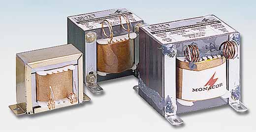

Hi!
I just found out that my part-supplier (www.elfa.se) finally managed to get some inductors that I think would be perfect for a SOZ. Originally intended for PA speakers. Anyways, I thought I would ask your opinions about this, and maybe help someone in the SOZ-process.
The specs are (on the smallest one):
Monacor
LSI-22T
OrderNo.12.5410
Transformer core coils,
High-quality crossover network coils of very high power rating, low distortions (vacuum sealed) and minimum inside resistances, the first choice above all for PA applications.
Technical datasheet
Inductance 2.2mH
Enam. copper wire (ø CUL) 1.2mm
Power rating 8/4 500WRMS/250WRMS
DC resistance 0.10 Ohm
Saturation current (50Hz) 7.9A
Dimensions 60x50x42mm (EI-57)
(This might be my excuse to build my 4. SOZ, as I simply love the thing... (-don't ask me why)) 🙂
