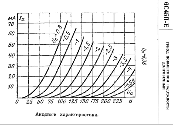

6S45P-E (some people like to muck up the translation from cyr. to latin, and use latin mixed with made up stuff like "pi" damn that irks me.)

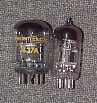

its a little 9pin triode, Pa = ~8w IIRC.
its supposed to be pretty close to one of the old WE tubes.. (437A i think? memory is dead here, and im too lazy to look at data of the WE ones..)
http://www.mif.pg.gda.pl/homepages/frank/sheets/112/6/6S45PE.pdf

Your memory is O.K.

6C45P is a stunningly linear valve. It wants >10mA of anode current before it wakes up properly, but can operate with quite low anode voltages (100V). There does tend to be a bit of grid current, so you have to be careful if you take liberties with the (150k max.) grid leak resistor. Because Cag is so high, you can't really use it as a gain stage unless you drive it with a cathode follower (or a moving coil cartridge) unless you don't care/can't measure the HF response. It makes a superb cathode follower, but you need a >100MHz oscilloscope handy to find and tame the oscillation.

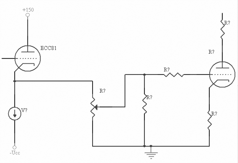

Well, I'm just going to ask some rather odd questions.
But I Became a bit worried about the input capacitance when fdegrove said that this tube need a buffer-stage.
Actuall my plans was to use 6C45 as the first tube in an amplifier, the signal comes from a source through a pot and is den fed to the grid. But is this "impossible" because of the input capacitance?
I have attached a schematic of a circuit with a bufferstage, but the pot is placed between the buffer and the 6C45, but will this circuit still be an good alternative if the resistance of the pot is kept low?
In my circuit om going to use current feedback, and the gain will only be about 15-25. Will the current feedback provide some kind of compensation for the high input capacitance?

No, I haven't tried it as an MC input stage. Sorry, Frank.
If we assume a gain of 20, then the input capacitance will be of the order of 120pF, in which case the highest value volume control I would want to use would be 25k.
Fine. No problem. Don't forget to use a 2k2 grid-stopper resistor, or it may oscillate.Gunderz said:I'm going to use an 10k pot

Is it Ok with a 10k pot if I use a bufferstage?
What if I dropped the bufferstage?
Will it still be fine?

No problem,it's just that it looks a good candidate on paper,i.e. a current amp as opposed to a voltage amp.
I'll stick to my // E188CCs for a while longer.😉
The best suited value should be determined on the O-scope,I think.
Cheers,😉
