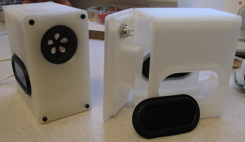

Attached are an example that I used along with a TB W1-2121S. The particular PR used I bought from ebay over in the UK, but they were also available, at the time at least, on aliexpress.
Ah, excellent. Was it possible to spec them for that TB driver and your enclosure design (using T/S parameters in your software) or was it a gamble, an experiment, to see how well suited they were? There appears to be no such info given, at least not through aliexpress, but perhaps through the manufacturer in some cases.
It was a complete gamble but they are so inexpensive that it doesn't really matter. Having said that, if I was going to be buying in any considerable quantity I would expect to be able to spec them.
