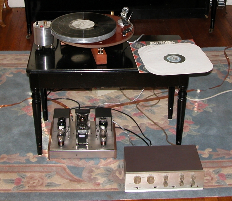

I gave up on the motor pod thing and just bought a Timaudio motor pod unit on eBay for $99 that I use to drive the rim of the platter in my just-for-fun diy TT project.. It seems quite speed stable, can't vouch for its durability as I have only had it for a week.
The platter, sub-platter and bearing are parts I purchased on eBay that originally lived in a Thorens TD-125 MKI.
Lots of parts are available on eBay..

Again noting that my experience is limited, the TimAudio motor pod worked just fine during an entire day of critical listening in the living room demo system during our recent audiofest. (Line stages, phono stages, and speakers swapped in and out all day as was intended with this system.) Speed did not need to be adjusted once and the thing ran continuously for over 10 hours.
The thing is ready to go, just set it up and plug it in.. Note that depending on platter diameter you may not be able to run it at 45rpm, however my intent was for 33 rpm operation only so this was not an issue. The motor pulley is a bit too small for 45 rpm operation with an 11.8" platter. Drive is by 4lb test nylon fishing line - works great!
My main system is in a dedicated basement room where a TD-124 does the playback chores, so the "Phenolic Wonder" which is TimAudio powered probably will not be used again until the next diy meet. It incidentally worked way better than I expected and despite its unsuspended design was amazingly insensitive to footfall frequencies. No mis-tracking due to heavy footed audio types was noted.. 😀 I have attached a picture of the table which uses a recycled TD-125 MKI main bearing, platter, and sub-platter. (eBay) Arm is a Linn Basik, and the cartridge an AT-120E/T. The thing sounds way better than it has any right to..

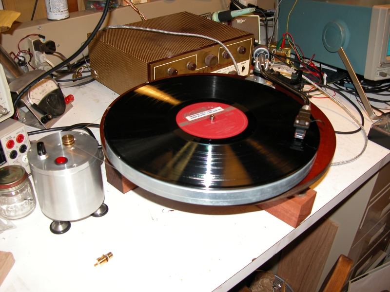

You might look at buying a used Rek-O-Kut belt drive tt (N33, etc.) off the ebay and use the motor and platter for your own rig. They used the wonderful German Papst AC synchronous motors in those decks (as did Empire TTs), and the platter bearing is also very nice-a spiral grooved steel shaft to constantly bring the lubricant up in the cast bronze well. Using a package like this, the motor pulley will already be sized correctly for accurate speed, and belts are readily available. If you definitely want to roll your own, the advantage is you can buy the crappiest looking deck possible just to get the parts, or even buy separate parts if available. Or conversely, buy a nice complete model and just use it until you get the urge to build a new plinth.
I built this deck from an ebay Papst motor from an Empire (about 60.00), a platter and bearing of unknown vintage (again about 60.00), and some woodworking. SAEC arms. Miraculously, the motor pulley size is almost perfect-I can get the speed dead on with a VPI motor controller (commonly found used for about 700.00), but in reality it's close enough that I don't really need it. The motor pod was made from a piece of aluminum tube, with some polishing.
I'm a big fan of these Papst motors, and though the idler drive Rek-O-Kuts have seen a pretty steep price increase in the last couple of years, I think the belt drive models are still pretty inexpensive. In fact, I have a N33 platter and motor on deck (hah) for an upcoming project.
