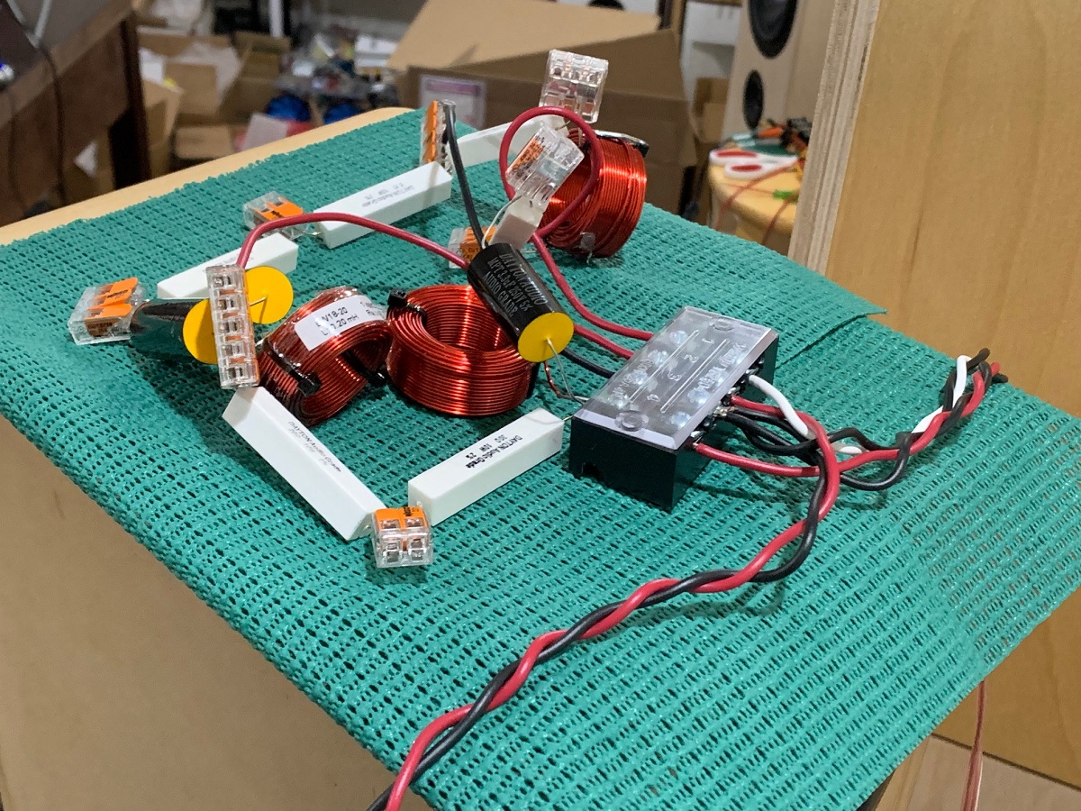

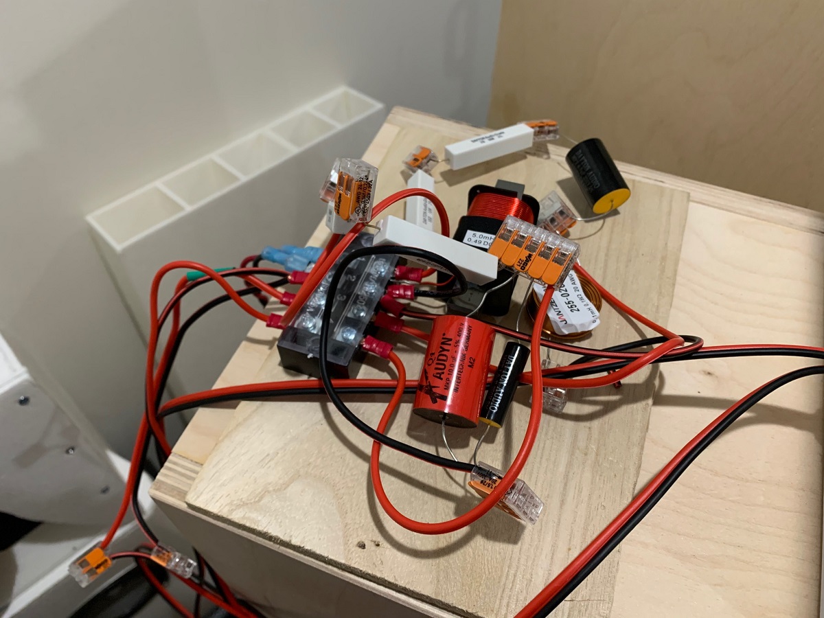

For about $225 I built myself a universal crossover development kit. This has air coil inductors from 0.1mH (2), 0.2mH (2), 0.33mH (2), 0.5mH (2), 0.68mH, 1.0mH, 2.0mH
Iron core 1.0mH, 2.0mH, 3.0mH, 4.0mH, 10mH.
MKP film caps 0.47uF (2), 1.0uF (2), 2.2uF (4), 3.3uF (4), 4.7uF (4), 6.8uF(2), 10uF(2), 15uF (2), 30uF (2); bipolar 50uF (4), bipolar 100uF (4);
Resistors all 10w 2% Audio Grade cement filled: 0.1R (2), 0.22R(4), 0.33R(4), 0.47R(10), 0.7R(4), 1R(4), 2.2R(4), 3.3R(4), 4.7R(8), 6.8R(4), 10R(4), 12R(4), 20R(4), 30R(4).
These were all from Parts Express.
It’s wonderful having this kit and a bag of Wago connectors. I can prototype 98% of any crossover design that I can come up with and test quickly in 15min. If it works, I’ll order the correct value that I had to build up with for the final speaker.
For example, XO for my Rockville homage to LS3/5A:
Or here:
The best $225 I ever spent on audio. I use it All the time. About 8 speakers now and counting. I can measure, design, test all in one evening.
