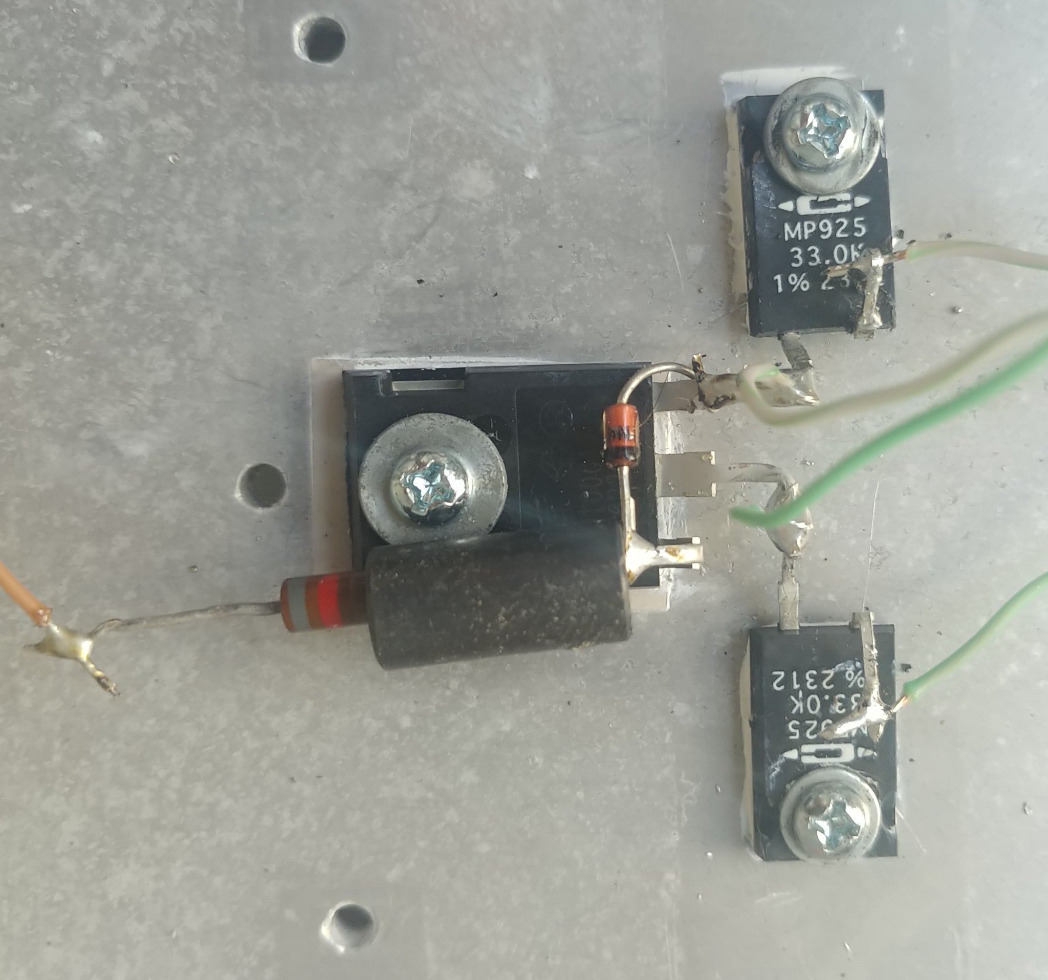

Well, today is the day where I've said goodbye to my smoked glass RCA VT-231 Phase inverter, and a welcome and happy "hello!" to my Wolfspeed C2M1000170D MOSFET Source-o-dyne Phase Inverter - which is now sounding absolutely fantastic!
I ended up putting 0-960VDC (and not the +/-300vDC) on the fet. Partly due to the gain in my DHT finals, I had to implement a CLC arrangement for the power supply to the Source-o-dyne.....Sic Schottky diodes -> 22uF PIO (1.5Kv) -> 6Hy oil choke -> 10uF (1Kv) PIO . Almost no hum. Almost )
The output of my Source-o-dyne PI (2 phases) are RC coupled (FT3's) to two Wolfspeed MOSFET Source Followers (textbook Tubelab) , then DC onto the grids of my DHT's.
The input of the Source-o-dyne Phase Inverter is DC coupled to the prior gain stage (in my case , a 7b4)
Wolfspeed C2M1000170D MOSFET Source-o-dyne Voltages:
Power Supply: 960 VDC
Source and Drain Resistors: 33K Caddock thick film
Drain: 676 VDC
Source: 275 VDC
Gate: 280 VDC
All in all a great outcome, and special thanks to DiyAudio member tikiroo for his massive help ))
PS forgive my sloppy skills (I just had to get it working)
