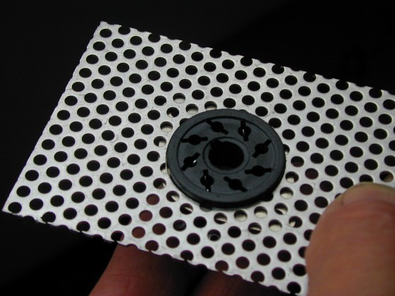

What I'd like to find is a perforated metal plate instead of the solid metal plates that are sold by Hammond. Then a wood box with one on top and one on the bottom should provide plenty of ventilation.

If you have an industrial metal supply house in town, they should sell perforated steel and aluminum. I have one right down the street from my work
😀 that sells perforated metal in different hole sizes, spacing, and mat'l thickness. I cut the stuff with a metal cutting table saw blade (Freud $40 at Home Depot) The metal supplier sells "rems" by the pound, but I have to stop in frequently to find appropriate sized metal. The metal cutting saw blade cuts AL like a hot knife thru butter. I routinely cut up to 1/4" thick AL for the chassis end plates with it.
The piece in the pic is .050' thick AL with 1/8" holes.

Home Depot sells "expanded metal". It s got diamond holes cut into in. The real cheap kind is for using under plaster and tile but I'm thinking of the nicer type sold near the aluminum sheet stock. This metal is for covering vents. Paint it with a thick black paint. Comes in 2 foot squares.
