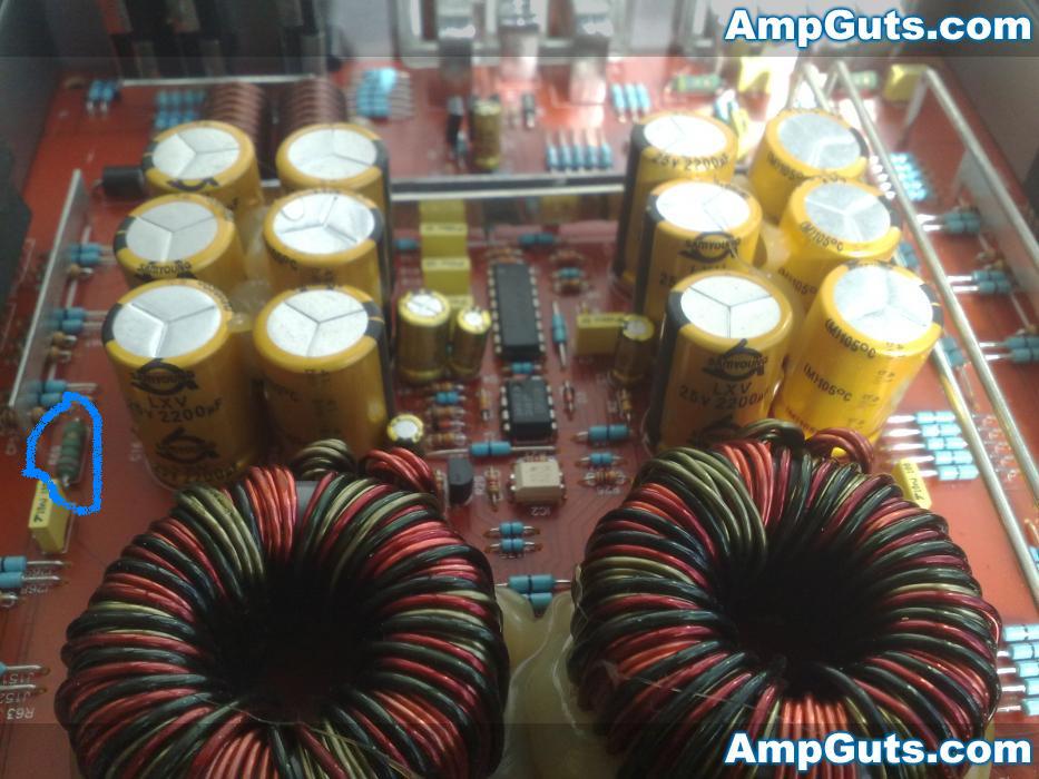

Does anyone know the value of the resistor that goes in the power supply?
1 end connects to the middle leg of the power supply fets the other end connects to a cap then to one of the windings on the transformer..
I believe its a 1 watt resistor but dont know the value since it burnt pretty bad
Its circled in this pic but cant make out the color bands
Looks like there are two power supplies and so I am taking a stab at the possibility that you will find a similar device on the second power supply opposite of the one that is circled that is burnt.
It also looks like a simple Zobel filter <RC network > and these typically have values between 4.7 and 10 ohms. And yes it appears to be a 1watt ceramic metal film resistor...Hope this helps some I don't have any info on this series of offshore amps

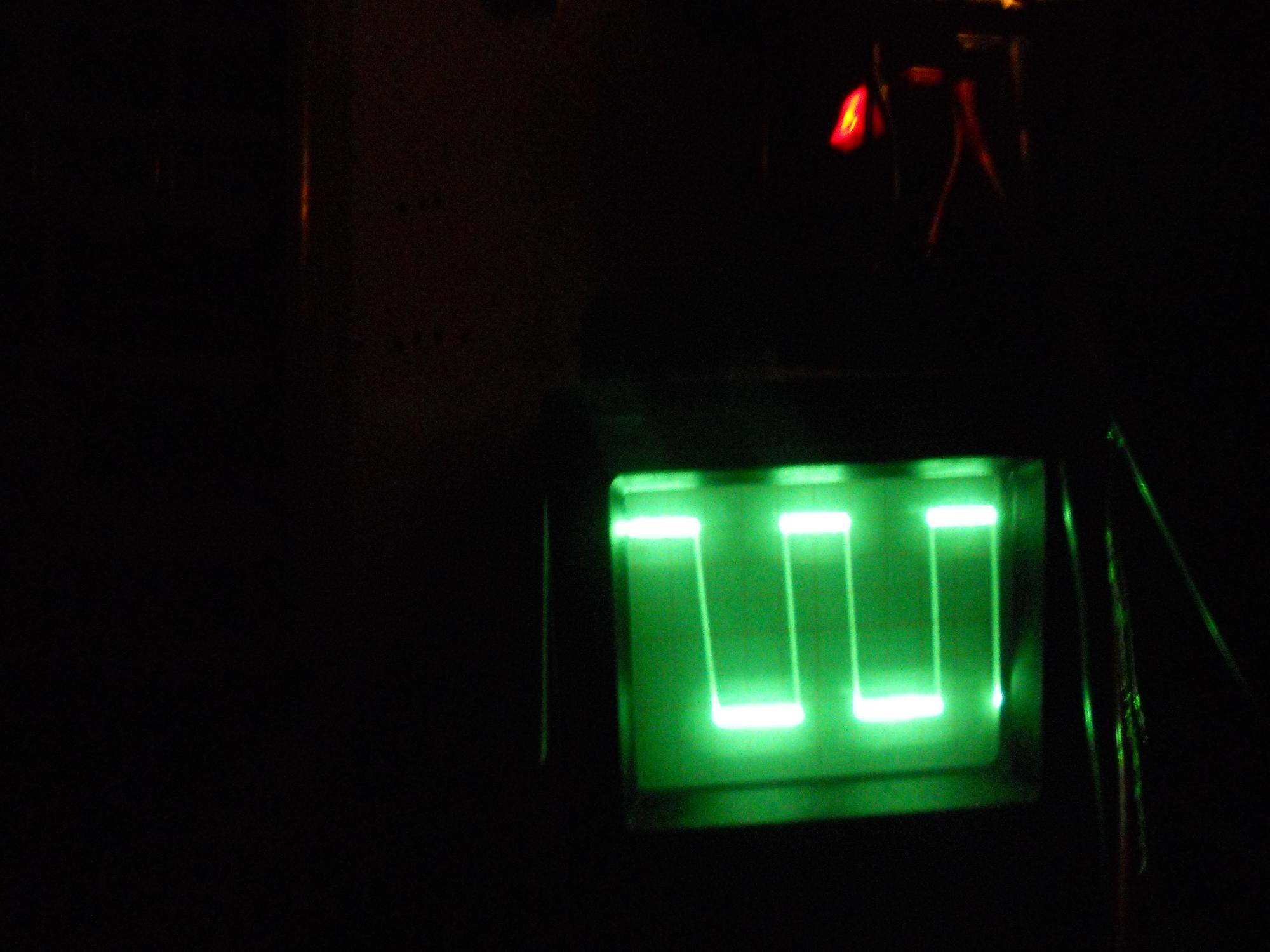

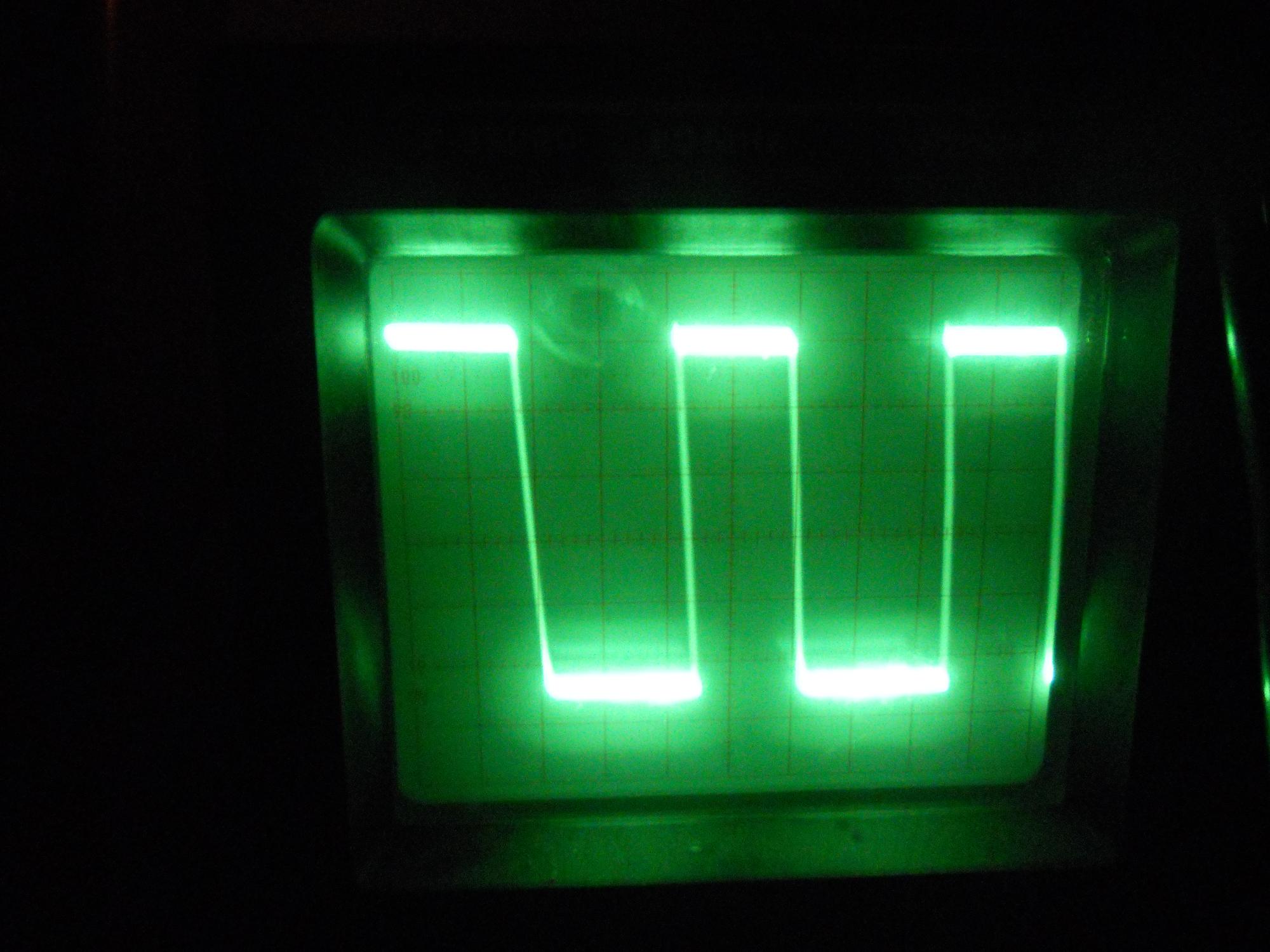

Those look OK but that's unloaded and it could change when you install FETs.
If there are 2 supplies, there are 4 sets of gate resistors. Check the signal on all 4 sets.
Checked the signal on all sets it looks the same ...

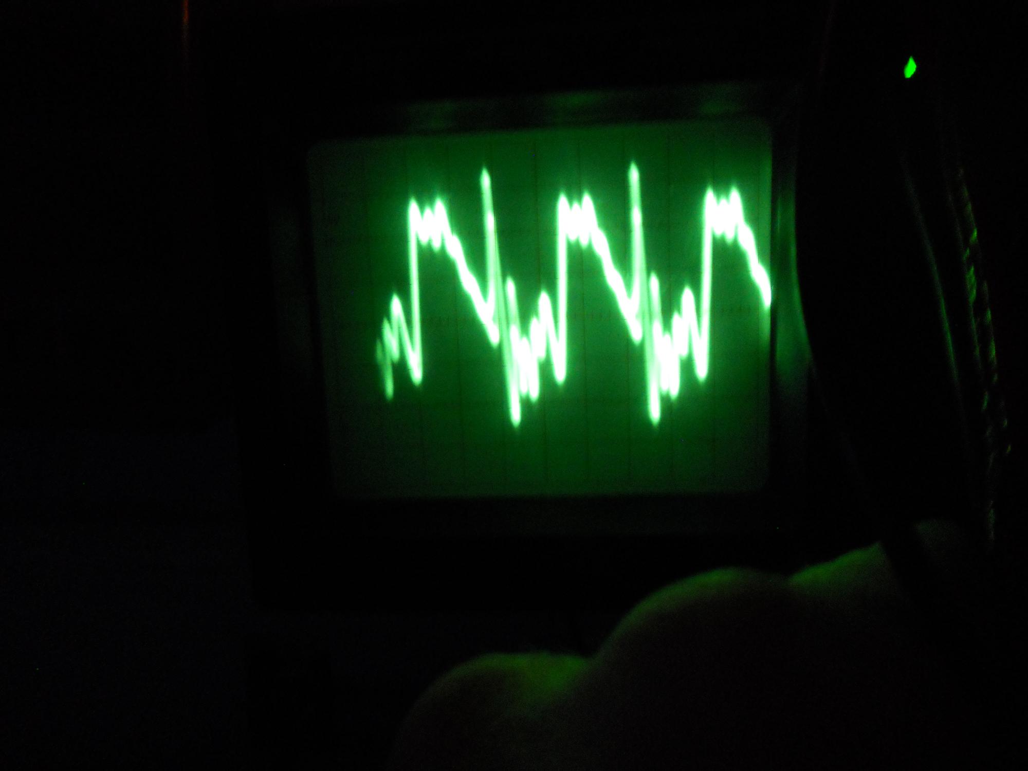

Remove the FETs. Connect a 1k resistor between the gate pad and the drain pad for one FET in each of the 4 banks. Does the gate signal still look square?
with the 1K resistors soldered in between the gate and drain..
The waveform is not square at all
That's not good.
Do you see a square wave on the output of the 494?
Do you see a square wave on the base of the PNP driver transistors?
Do you see a square wave on the emitter of the PNP driver transistors?
PIN13 appears to be the output I get the same waveform on pin 13 as i do on the gate pads..
ON the base and emitter of the A1266 drivers i get the same waveform as the 494 and the gate pad..
Waveform doesnt look good at all..
