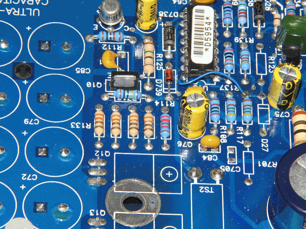

Also the cap at C65 connected between the 3524 and the PS drivers is currently a 10v4.7uf cap. Its supposed to be 16v. Its also different brand and color(orange) which I've not seen before on SS1000 amps. Looks like all transistors and caps in the PS circuit have been replaced between the 3524 and the toroid. However, the gate resistors on the FETs look to have never been replaced even still they are measuring 3.3ohms. The amp is using 7050 FETs.
Since I ordered a pile of 16v4.7uf caps I'll swap out C65.

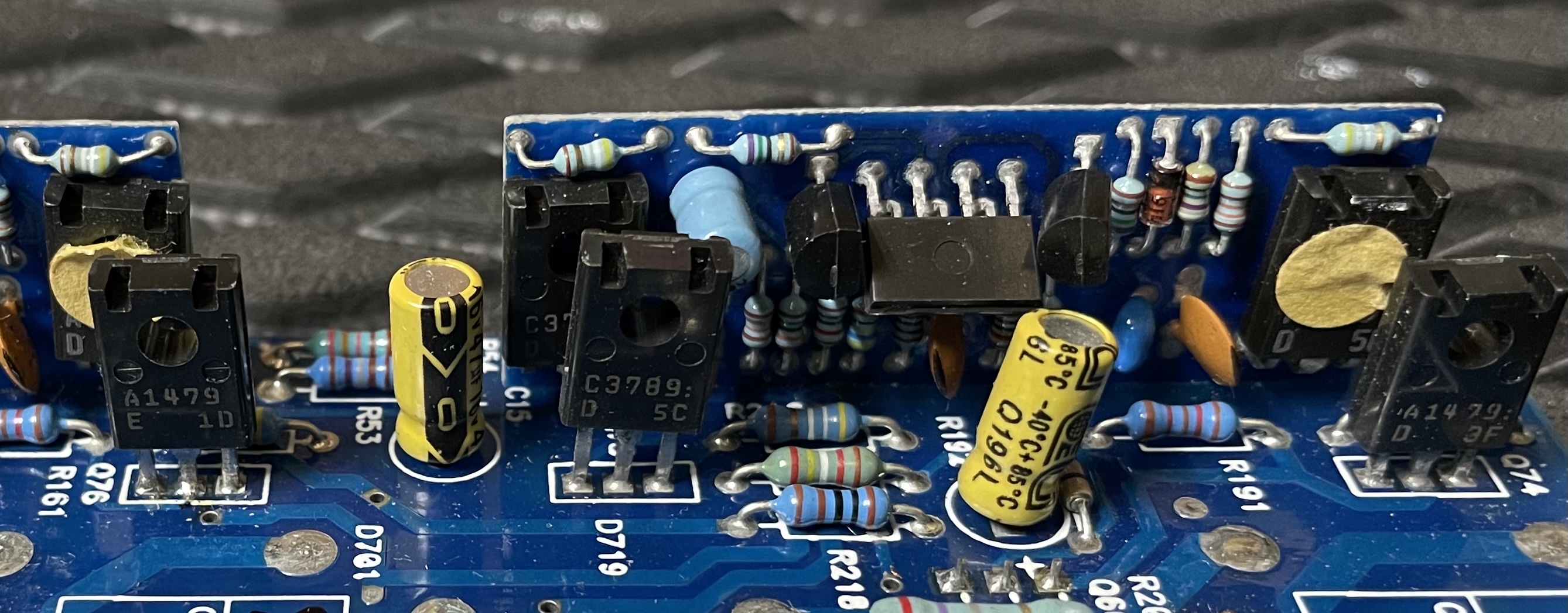

Reversed is likely correct. Check for pin-pin connection between that driver and the one on the driver board. At least some of them were installed wrong by the manufacturer.
So that seems to be an issue then across all 4 pairs of driver transistors. In each pair, the base of one is connected to the emitter of the other (Base-to-emitter) whereas on the schematic its base-to-base and emitter-to-emitter . Being a manufacturing error, Im surprised this worked out. I guess the mistake makes only one driver actually perform the work. I wonder if that could have caused output failures under high current.
So, I should reverse Q73, Q74, Q75, & Q76?
The drivers should be in parallel (B-B, C-C and E-E through 49.9 ohm resistors). Correct any that are wrong.
Ok.

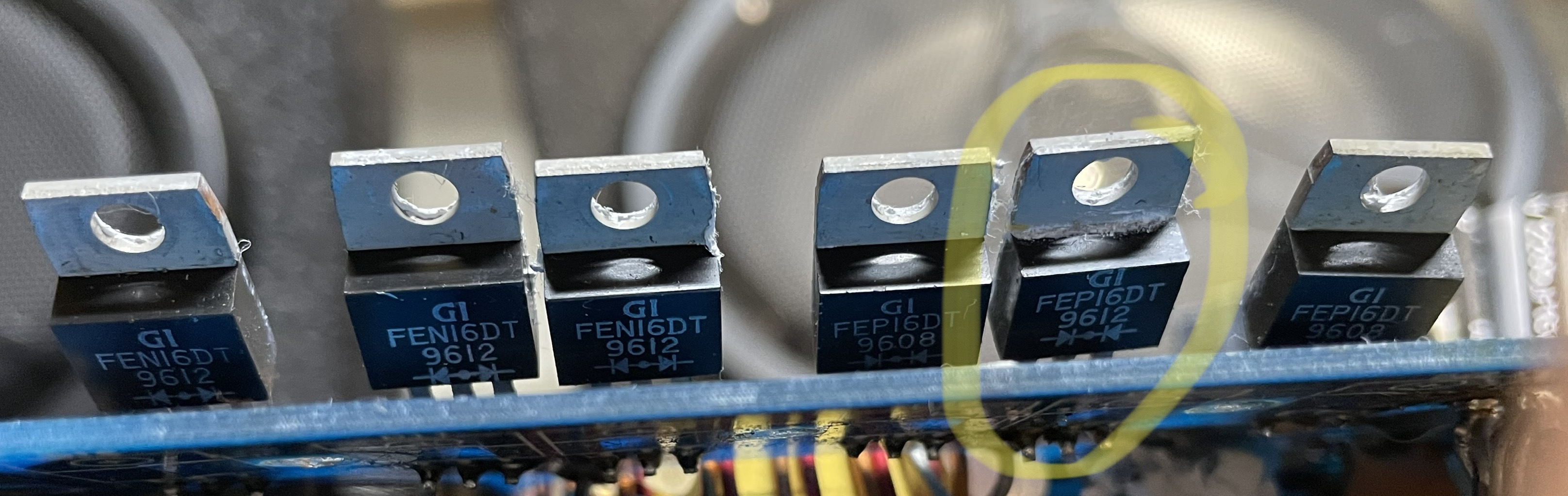

Next noticed the rectifier in D18 may was changed. Oem soundstream TO-220s usually have their legs slightly painted. This one did not. All rects are FE(P or N)16DT still, but this one seems to have a different date code or other numbers on its front. Picture attached. I know SS amps have a tendency to be weak in the area of rectifiers and so I may replace all 6x of these.
Was there a question.

I was using Tapatalk from my cellphone to post a few pictures including the picture in post #14. Unfortunately Tapatalk posts pictures as thumbnails. If you click on the thumbnail it will enlarge to full screen and perfect to read. It was just faster to post photos for me that way, but I understand the inconvenience of browser opening up another window. Sorry.
Should I replace the 6 rectifiers?
The rectifiers are in two groups of 3 parallel rectifiers. The 3 in parallel should match.
I don't know why SS has so many rectifier failures. I don't know if it's the old FEN and FEP parts but I've never seen a new part like the MUR1620CT and MUR1620CTR fail.
I'd replace all of them.

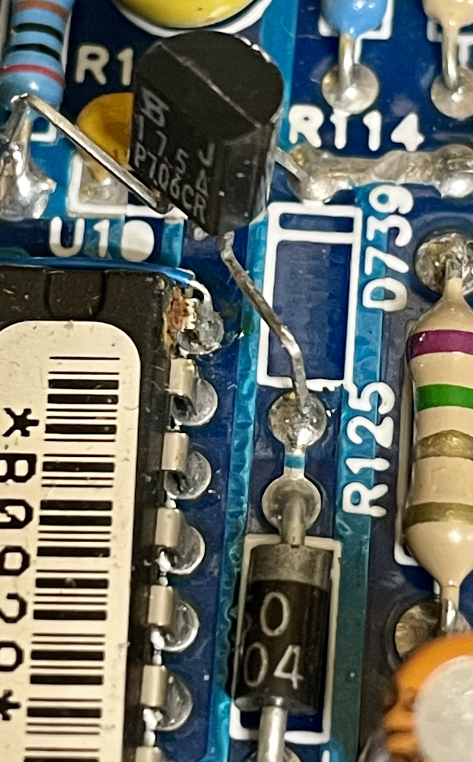

Looking back at C65 which has the wrong capacitor voltage rating (Orange cap in the thumbnail photo), there is also something going on with D738, D739, and R107. There is a J175 transistor legged between the pads of D739 and R107
C65 is wrong so its got me looking around this area.
D738 looks like its not an MBR150 per the schematic.
D739 is being subbed by this J175
The J175 is testing a little funny. I lifted leg 3 to test it and between legs 1 & 3 its measuring 58 ohms. Between legs 1&2, and then 3&2 its passing diode check.
Click the Thumbnail. Is anything weird or broken here?
In photos I have, I don't have the J175 but I've seen that in some SS amps.
The J175 JFET sounds normal. Read section 6 on the Checking Semiconductors page of the tutorial.
