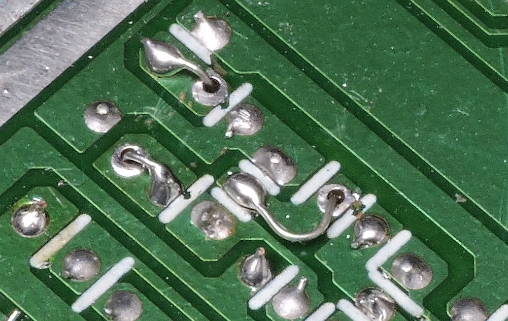

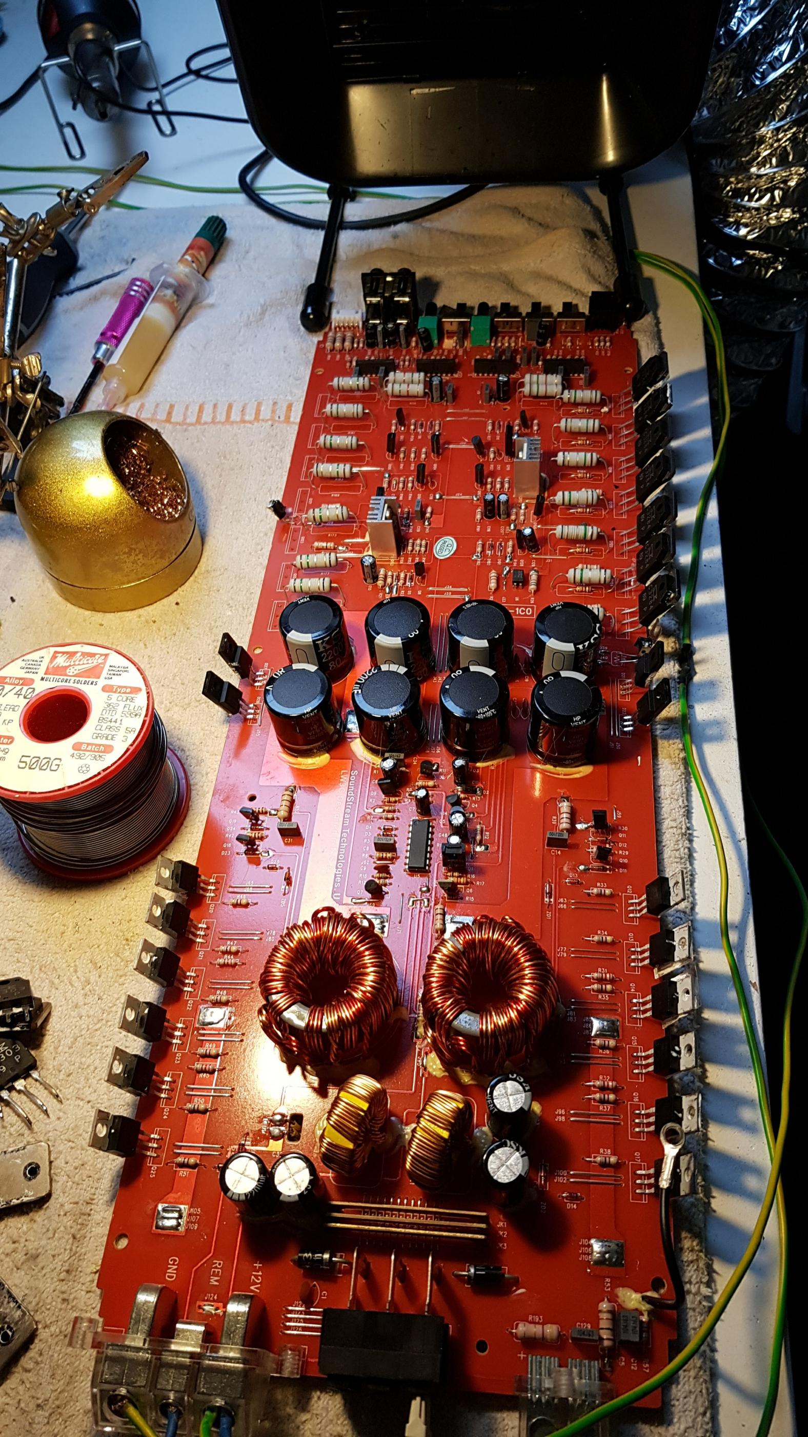

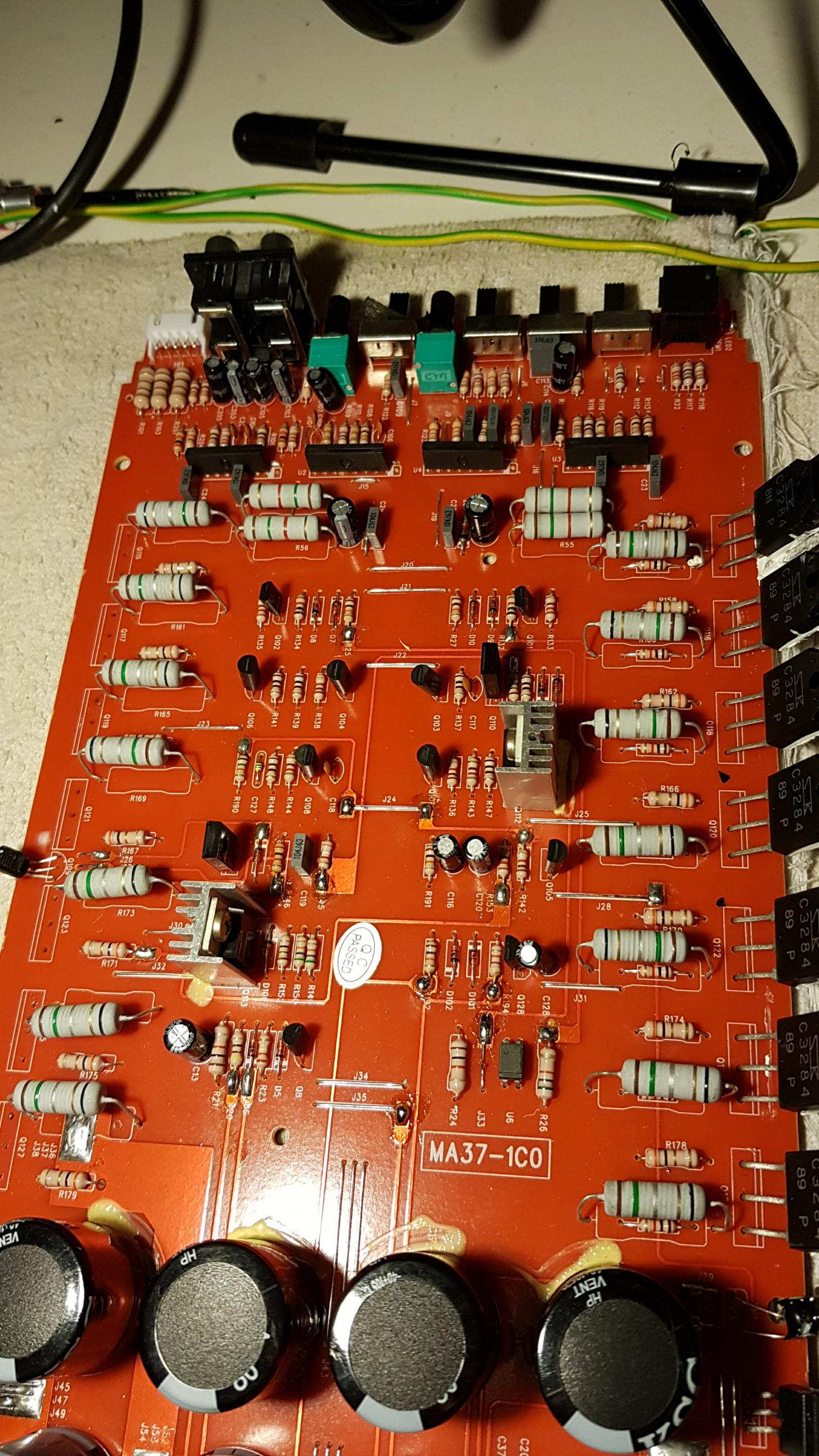

Hi guys,
This soundstream amp has a correct working power supply (measured with no rectifiers installed).
The amplifier powers up well (0.8a for 4 sec), and then it instantly draws about 10a+
Nothing else gets hot except for the PS fets.
I removed one side of the output transistors (A1303) and now the amplifier does not draw excessive current. All the A1303 transistors read OK. When soldering one transistor back it is instantly pulling 10a+ again.
Any ideas? It seems like there are no strange voltages on the output transistor connections which could cause it.

You probably have shorted drivers for the outputs .
It appears you have a burned resistor .
So more then likely a out of tolorance resistor and bad driver transistors .
Also did you check the outputs to see if any were leaking or did you just check them for shorts

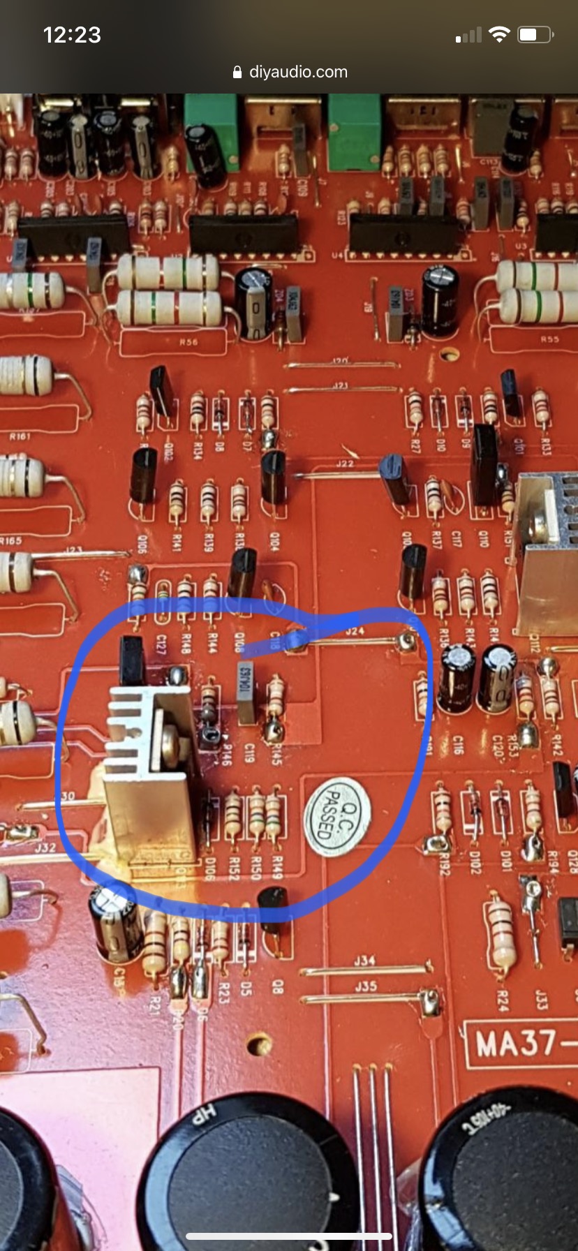

The resistor which seemed black on the photo's is not burned. This is a shadow area from the light I have on my desk.
There actually doesn't seem to be visible burned components on the output section.
The PS circuit is driven by a KIA494AP.
Mostly when the output section is causing trouble in this kind of amplifiers I have worked on, there are some strange voltages on the output transistor pins, which give a clue that the drive transistors are dead.
This amplifier doesn't has strange voltages on the output transistor pins.
I tested all the output transistors with a transistor tester. Which gives me the hFE, Ie, Ube
All values seems to be very close in tolerance with eachother.

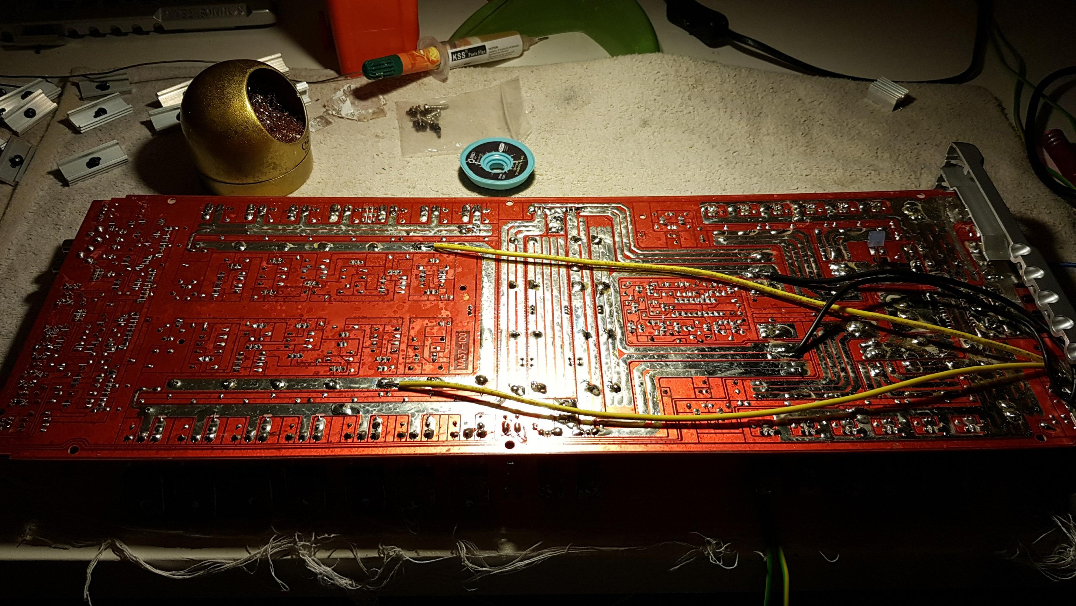

With terrible board design, do you mean that small metal jumper cables which connects the copper traces with eachother?
Any point where there is a solder connection on the top AND bottom for any component terminal, the connection is likely to be intermittent. The best solution is to replace the component (or scrape the terminals), solder only on top and make the connection on the bottom to some other point in the circuit. You don't want solder on the top and bottom of the board.
In the attached photo, you can see how the resistor legs are not soldered on the bottom of the board (they were soldered on top) and the leg is soldered to another point.

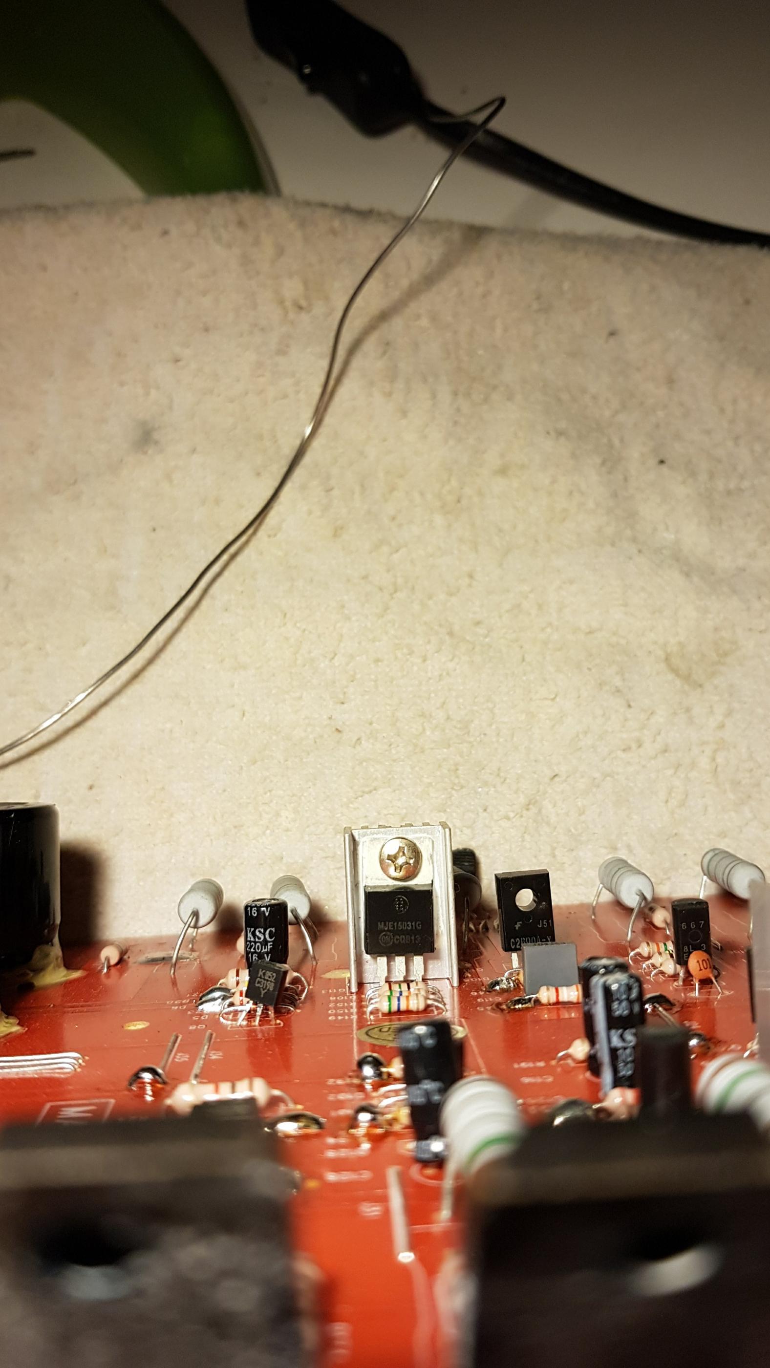

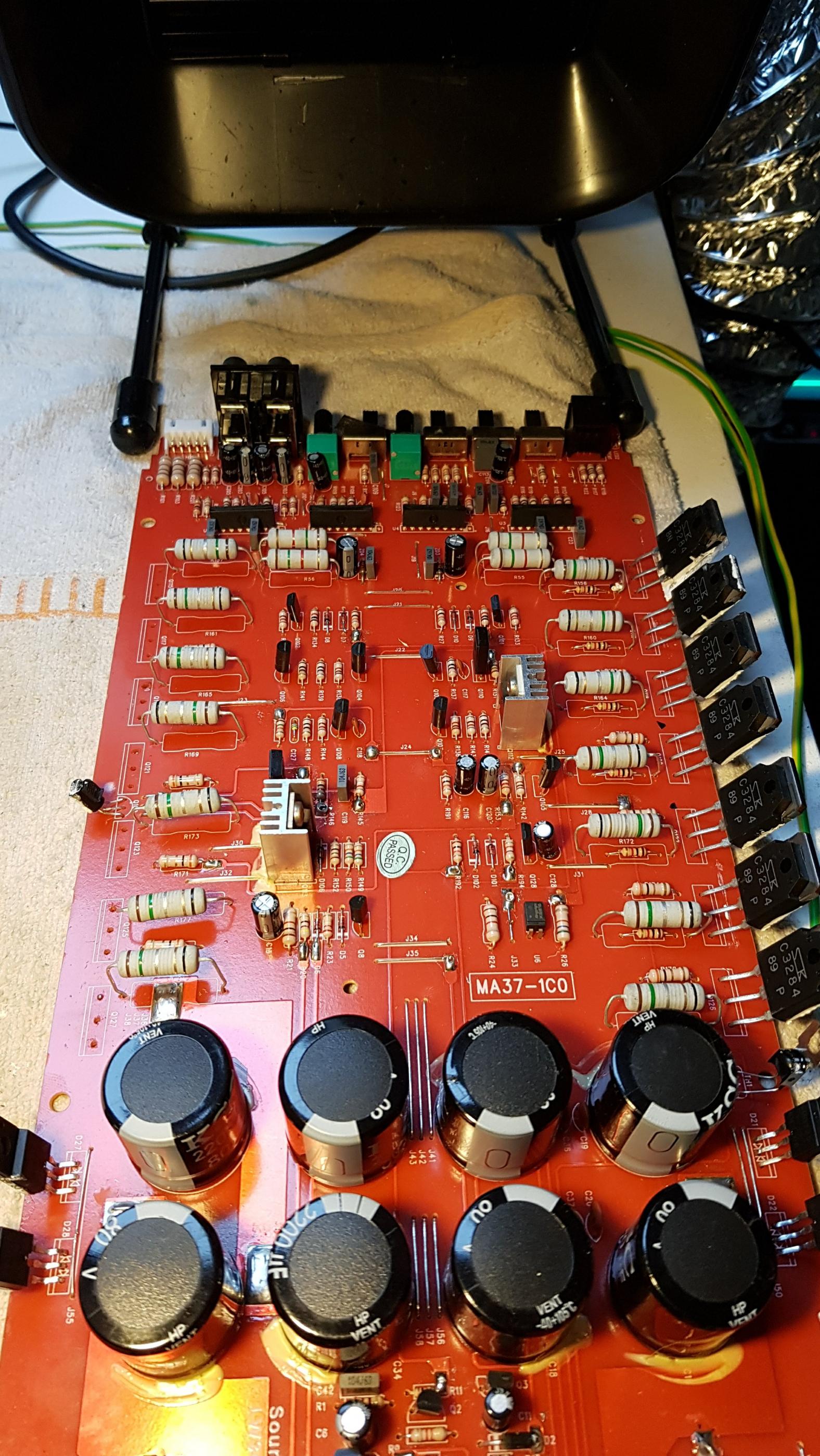

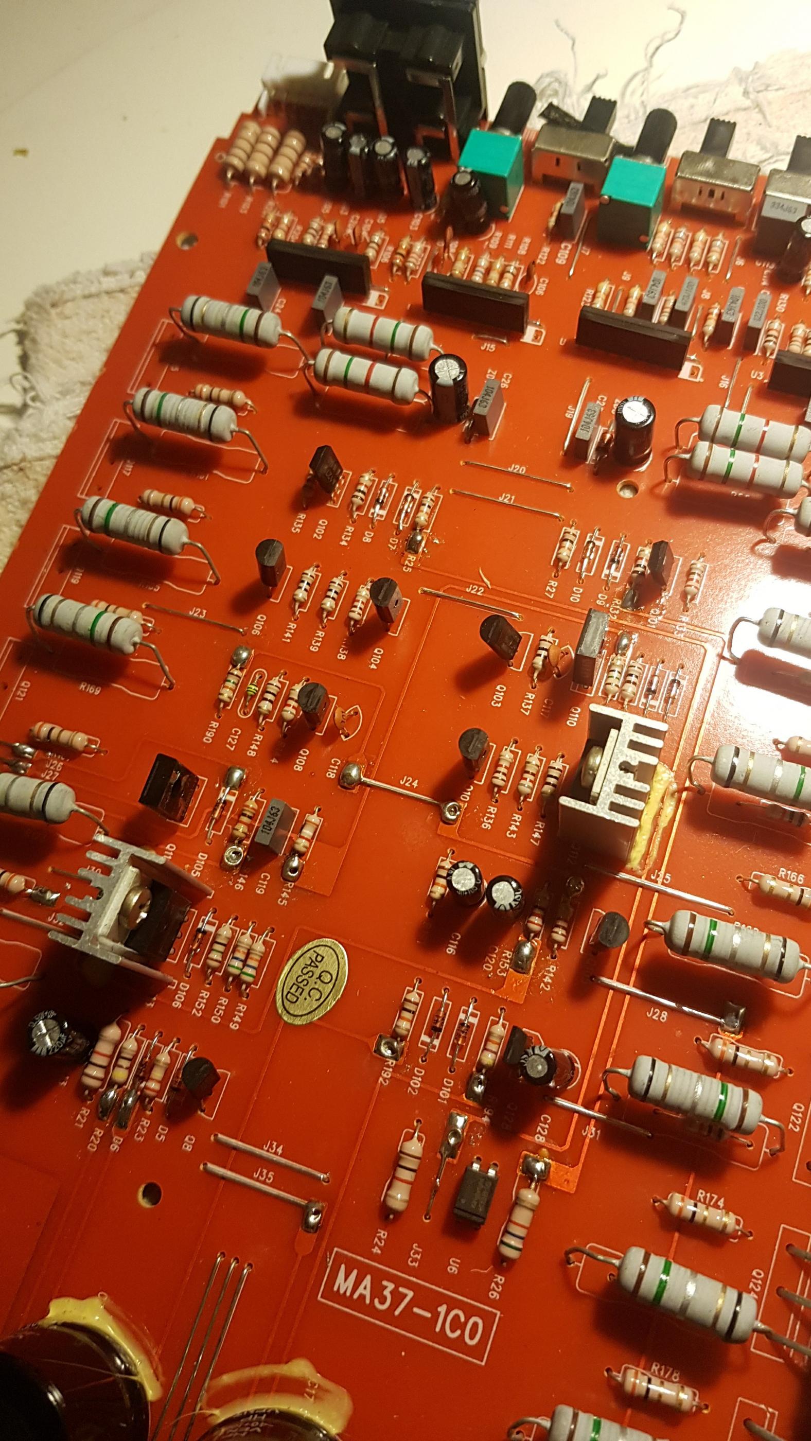

I actually got the same and second amplifier with the exact same problem.
All the connections are 100% ok and well soldered.
No burned components visible.
When one bank of the output transistors is removed (they all read OK) the amplifier powers up fine without excessive current draw. Also with 100% good and nice solder connections.
Power supply is OK
Rectifiers are OK
It's a problem in the output section. No strange DC voltages on the output transistor terminals
I tried to slightly isolate both banks to unsolder the yellow wire on the bottomside of the PCB (this doesn't make a difference)
I unsoldered and tested all the drive transistors of the bank which output transistors are unsoldered (all transistors read ok)
This amplifier has 2 output banks. A bank with A1303 output transistors and a bank with C3284 output transistors.
From each bank, all output transistor gate pins are connected to the single MJE15031G drive transistor (connected to the little heatsink)
Anyone has an idea?
