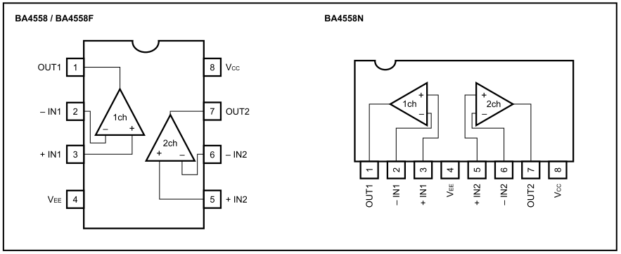

ok, i checked almost all the two sides soldering joints and cleaned the old fixative on the flats. I've tried to reconnect the amp, and on the second try it didn't went on protection! i checked if there was some dc on the channels, and 4th had it... a lot! And the value kept rising! Now i've desoldered the two output transistors of that channel (tip35c and tip36c), and both are good... What's the next thing i should check?
The solder bridge on the rectifier was not intentional. That should have caused excessive current draw if that power supply was functioning.
Check all of the op-amps to see if any have excessive DC on their output terminals.
The op-amps are those two, right? View image: IMG 0048
Can I check them while they are soldered to the board or i have to take them off?
The op-amps that you need to check are all of the 8-pin inline ICs like the ones near the fixative you removed. The output pins are 1 and 7.
ok! Sorry for another noob question, but in order to do this reading, the amp should be turned on? Becouse with the amp off, dmm set to dc, black probe on GND, all the output pins are almost 0v
