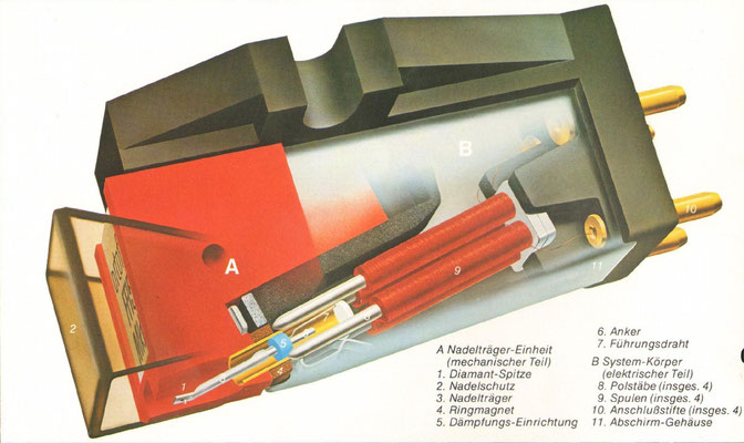

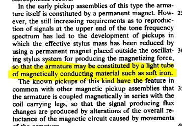

Go read the ortofon patents for VMS. All ortofon fixed coil cartridges use VMS, which is a MI technology. I've attached a diagram where you can see the fixed magnet.

Basically yes. Being pedantic it would be moving alloy as aluminium would work for the shunt, but it does get mildly magnetised in use so there is some ferrous content there. VMS is a unique operating principle. Sorry that you chose to believe marketing rather than doing a little research for yourself.

Which part of 'read the patent' did you struggle with?
