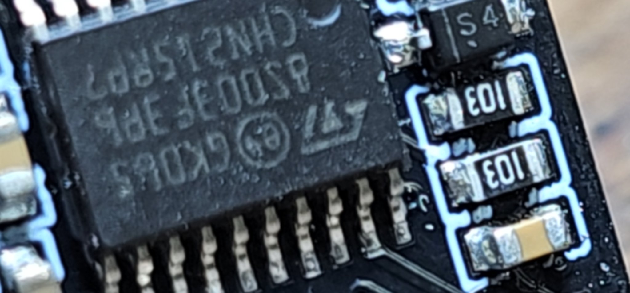

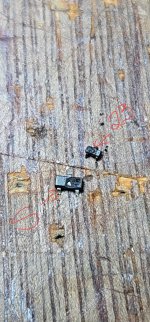

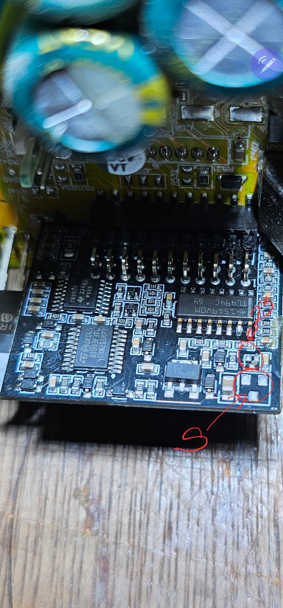

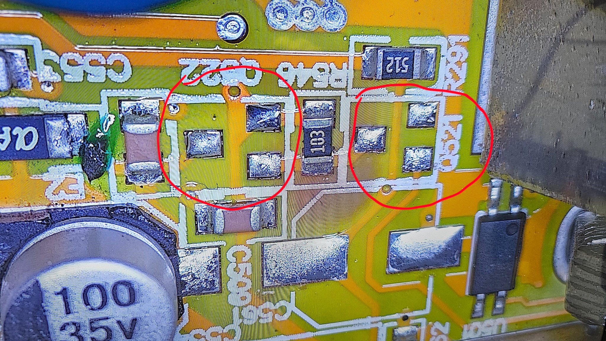

Hello friends... I'm looking for the name of these components in the power supply stage. The amplifier is a SoundMagus PK1400.4. The components appear to be transistors, but I've tried several without getting satisfactory results. Two of them have a number (23), one only shows the letter S, and the last one didn't have a number because it was completely blown. I hope someone has an amplifier in their possession and can guide me. Greetings, friends, and have a good night.

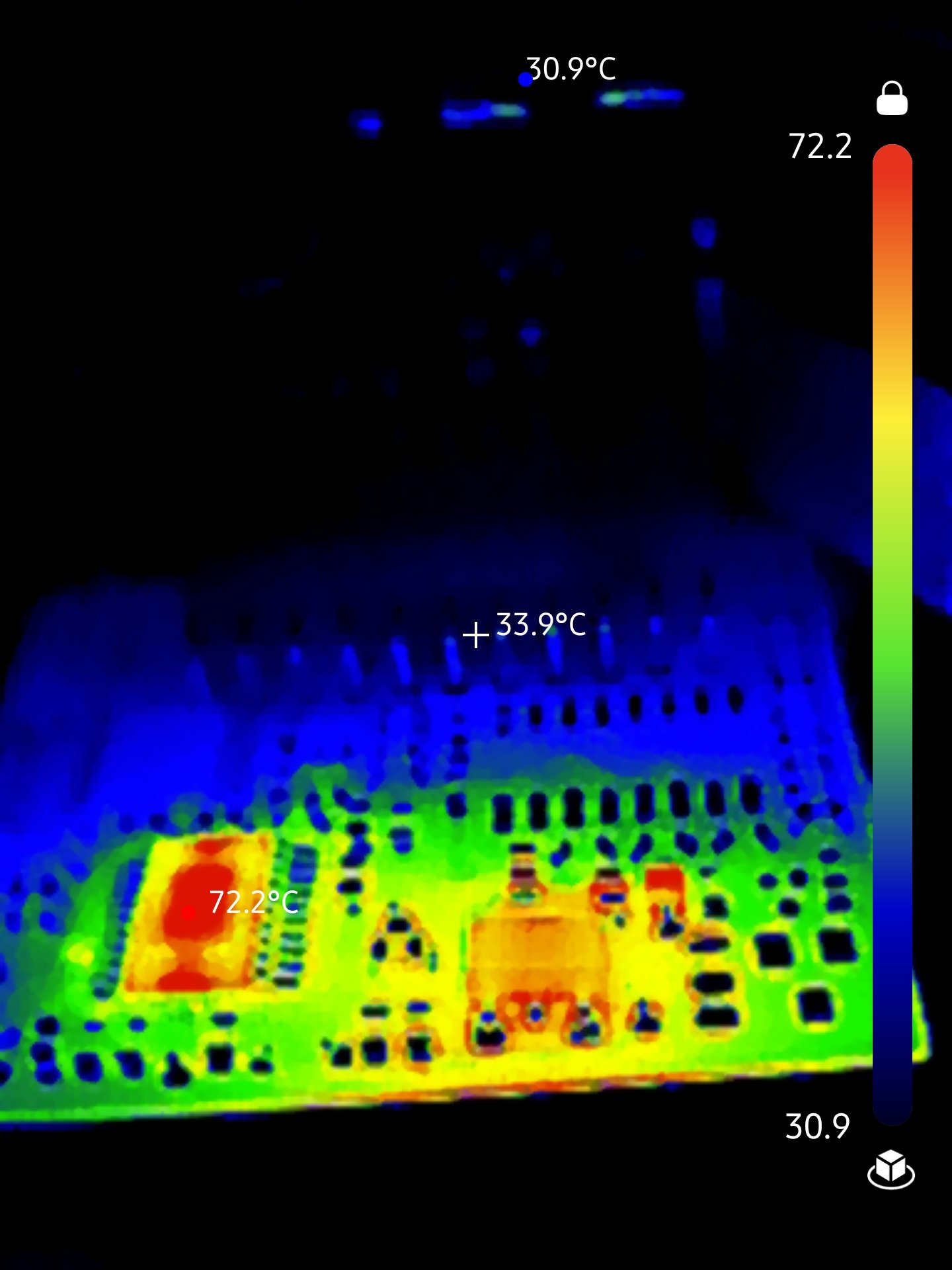

Hello good evening, the longest transistor does not feed the regulator, it is working, I decided to investigate further in front of the regulator since it was getting hot, using a thermal camera I discovered that a programmable Controller is shorted, this is powered by the 5v regulator, I measured continuity between the power pins of the Controller and found the short, I removed it and the regulator no longer heated, I'm afraid I will have to look for a card, I hope to find greetings
