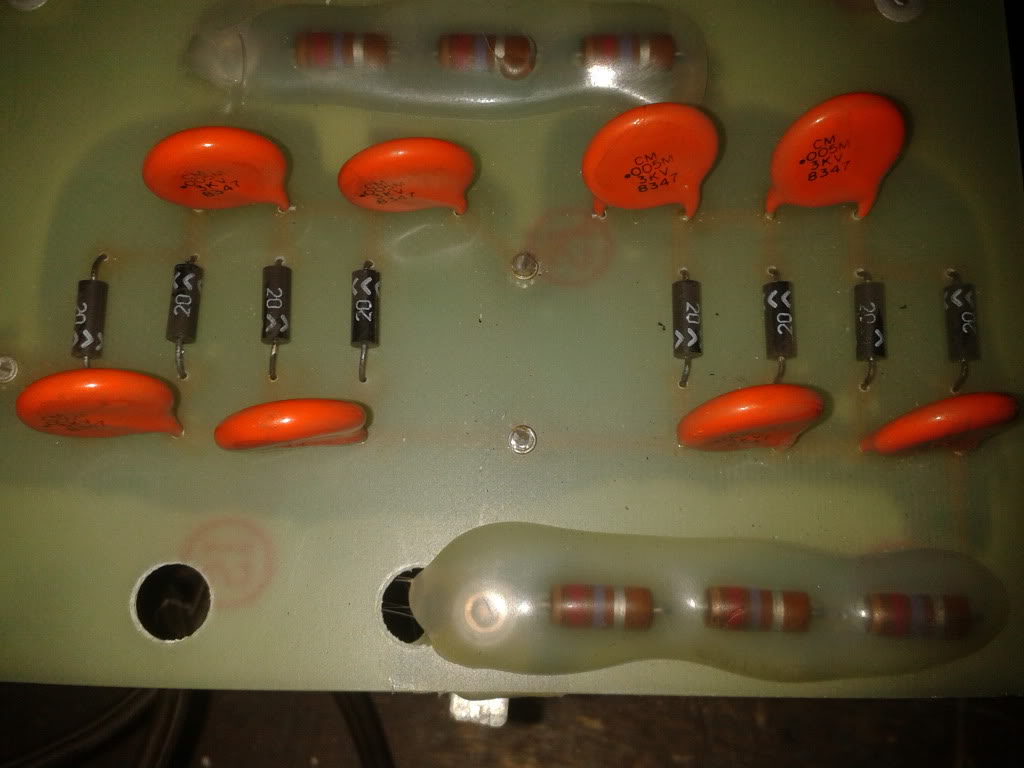

Hi

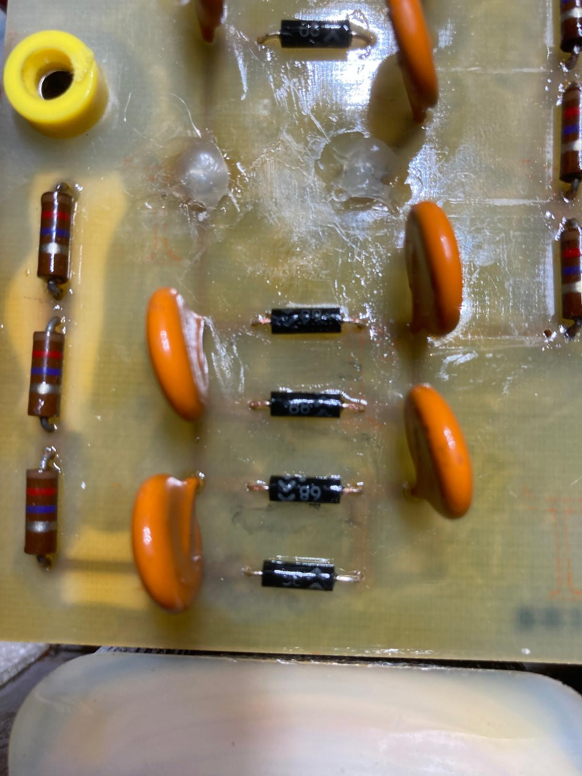

Unfortunately, one of by beloved speaker is not working.
I found only 37V DC on the membrane polarization plug instead of 310V.
I guess it's one dead diode or many.
The problem is that I can't identify this diode : it is only marked 68.
It's an uncommon kind : several stacked circumflex accents instead of one ring.
I mailed to the company and yet I got no answer.
So, can you tell me what kind of diode may I use in replacement and possibly its specifications ?
Besides, I did not measure the same DC voltages as on the PCB.

The diodes here are being used in a capacitor-diode voltage multiplier. Any silicon diode of sufficiently high voltage rating will do.
Actualy, egellings, the resistors are 120Meg : brown-red-violet.
I had to connect them in parallel to be able to measure (Fluke 15B).
Are you sure, HumbleDeer, about the diodes : I don't want to destroy these tremendous speakers.

In voltage multipliers, the voltage requirements for the diodes and capacitors are the same: 2x the peak input voltage. (see attached app note)
Can you see the voltage ratings of the caps? I have a pic for a similar looking bias supply from a model A2x and it shows 3kV.
If the capacitor voltage ratings are < 4kV, I would recommend the Vishay GP02-40 4kV diodes.
https://www.mouser.fr/c/?q=GP02-40

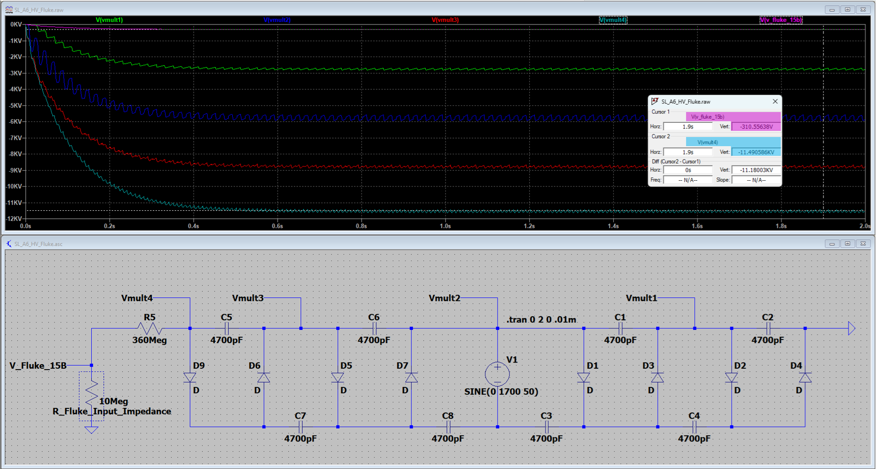

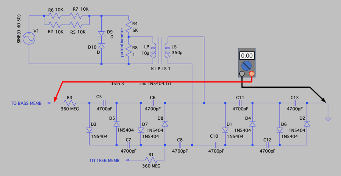

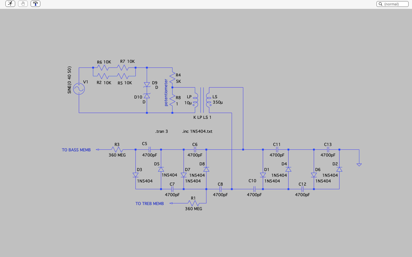

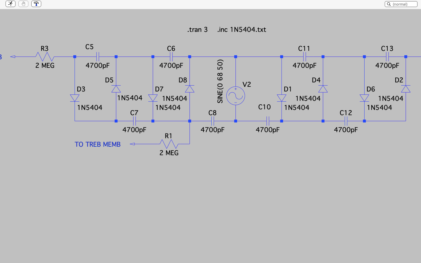

here is the complete circuit but I don't understand the voltages calculated by Ltspice.
On the bench, with 40V AC through a variac :
PCB not connected :
5.8V AC at the primary, 207V AC at the secondary
PCB connected :
3.2V AC at the primary, 124V AC at the secondary, 10V DC at output R1,
18V DC at output R3.
PCB not connected :
PCB connected :
Can you clarify what and how you were measuring?Unfortunately, one of by beloved speaker is not working.

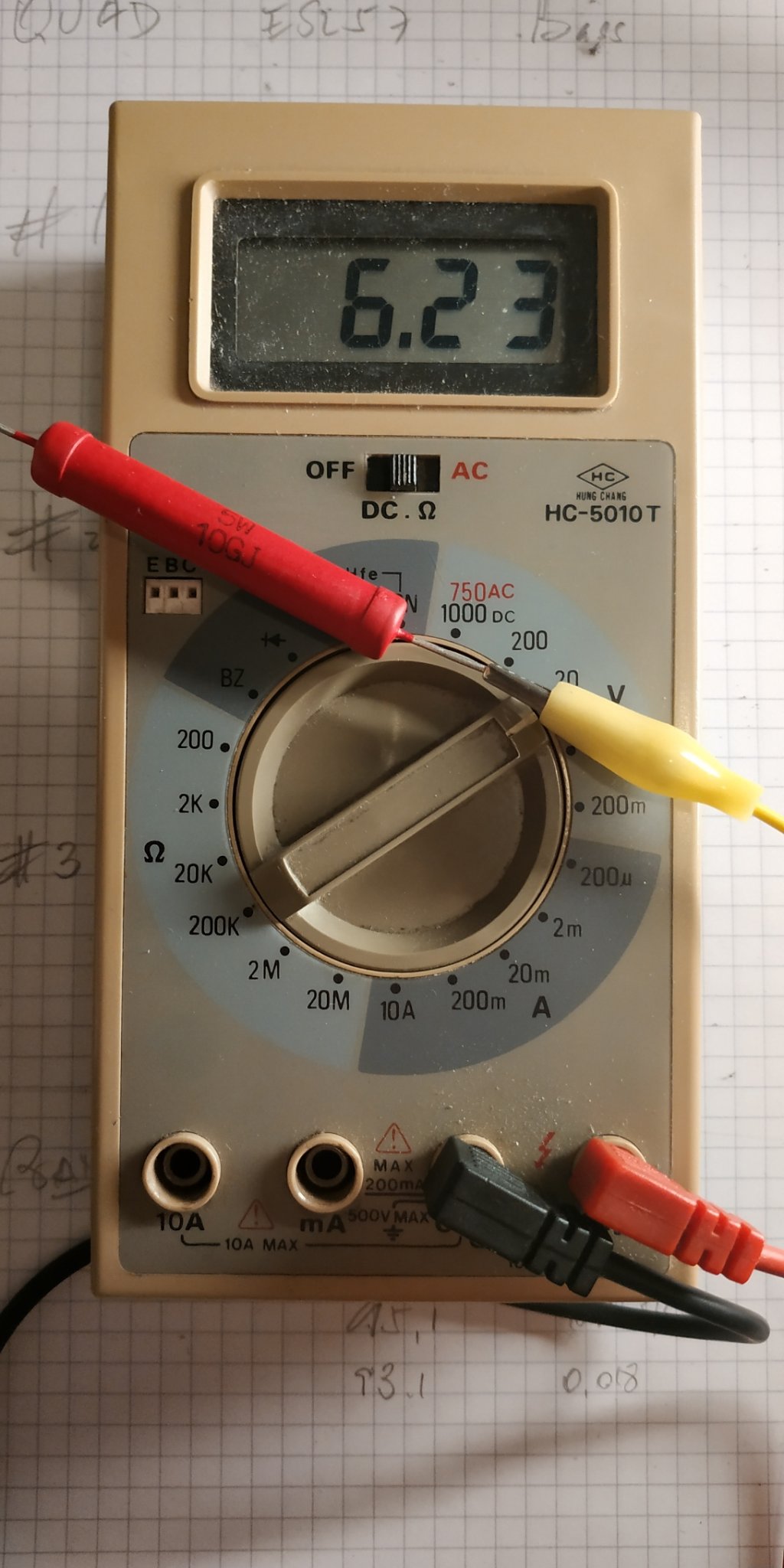

1) Was the 310V measured on the working speaker and the 37VDC measured on the speaker that is not working?
2) Did you have both the of the polarization plugs disconnected? both bass and treble plugs. (This is important to make sure any leakage in the wiring or either panel isn't loading down the multiplier)
3) When measuring the voltage, were you connecting your FLUKE 15B directly to the polarizing plug and ground as shown below?

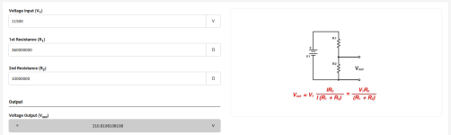

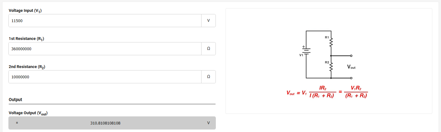

If the answer to question 3) is "Yes", the 10Meg input impedance of the 15B formed a voltage divider with the 360Meg bias resistors.
The bass bias voltage would then be 310VDC * (370/10) = 11.5kVDC, meaning each of the Capacitors had about 2.9kV across them...just under their 3kV rating.
To make more accurate measurements of the HV bias supply you will need to use a HV probe that can handle the high voltages and has a high input impedance (1000Meg) so it won't load down the HV multiplier which has an inherent weak current capability. You can often find them used on ebay for < $100
https://www.fluke.com/en-us/product/accessories/probes/fluke-80k-40
https://www.ebay.com/itm/176767671886

First thing first : 37V was measured on the incompletely wired supply.
1) 65 V DC, this time, was measured on the faulty and discharged power supply
(without a speaker connected).
300 V DC on the good power supply (also discharged).
Besides, both speakers work perfectly.
2) Both plugs are disconnected.
3) Yes, as shown in the photo.
Sorry, I don’t understand the formula 310VDC * (370/10) = 11.5kVDC, can you explain it to me ?
Were does come from the 310 & 370/10 values ?
As you noticed, actually the schematic is incomplete: ground is also connected to the secondary ’s
center tap of the output transformers (which go to the treble & bass stators).
The primary, of course, is connected to the amplifier output.
