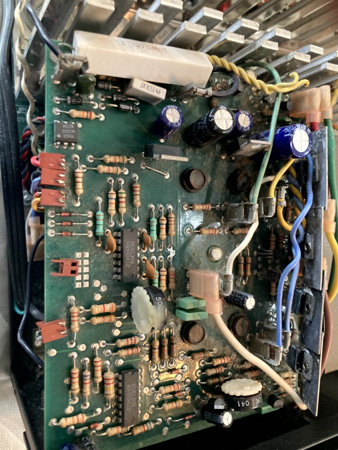

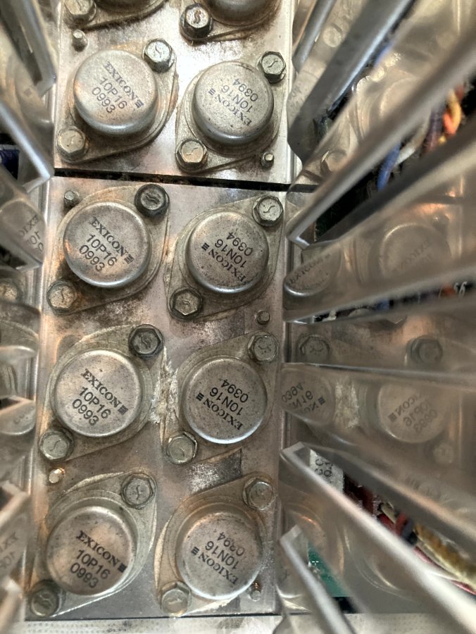

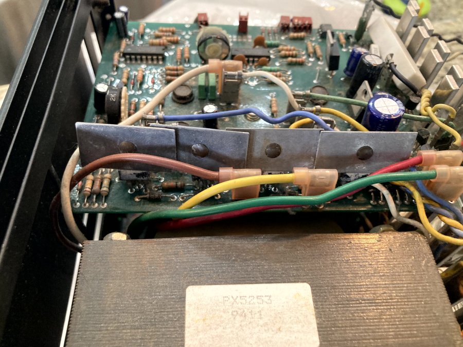

I have 2 nice Soundcarftsmen amps, A400 and a 860.
Both sound the same, the only difference is that the 860 uses lateral mosfets and the A400 vertical mosfets, same basic circuit.
I only can keep one, should I keep the one with lateral mosfets ?

They’re both laterals.
Just different packaging. Exicons are equivalent to Hitachi J49/K134. The Hitachi J160/K1056 (or J162/K1058) are TO3P versions of the TO3 Hitachi laterals.
The TO3Ps will be easier to replace with new Exicon laterals if needed. Exicon’s TO3 laterals are at end of life.

*Mostly. There are slight differences in the FET data sheets, and likely differences in the amp schematics, but that’s beyond my expertise to explain.
I remember the 860 has that cool shoebox form factor. However your A400 looks a lot cleaner.
If I recall correctly, don’t the 860s have an odd power supply arrangement (some research may be needed)? That could skew more points for the A400.

What sets these Soundcraftsmen apart from other amplifiers is the Phase Control Regulation (PCR).
That's the pcb on top of the supply caps.
What it does is it controls the thyristors firing angle in accordance to the power demanded by the amplifier.
My PCR800 works on regulated rail voltages of +/- 70Vdc.
The unregulated voltage is higher at +/- 95Vdc,, so effectively there's a +/- 25V headroom.
Even under full power, there's no sag in the rail voltages because it doesn't come out of regulation.
