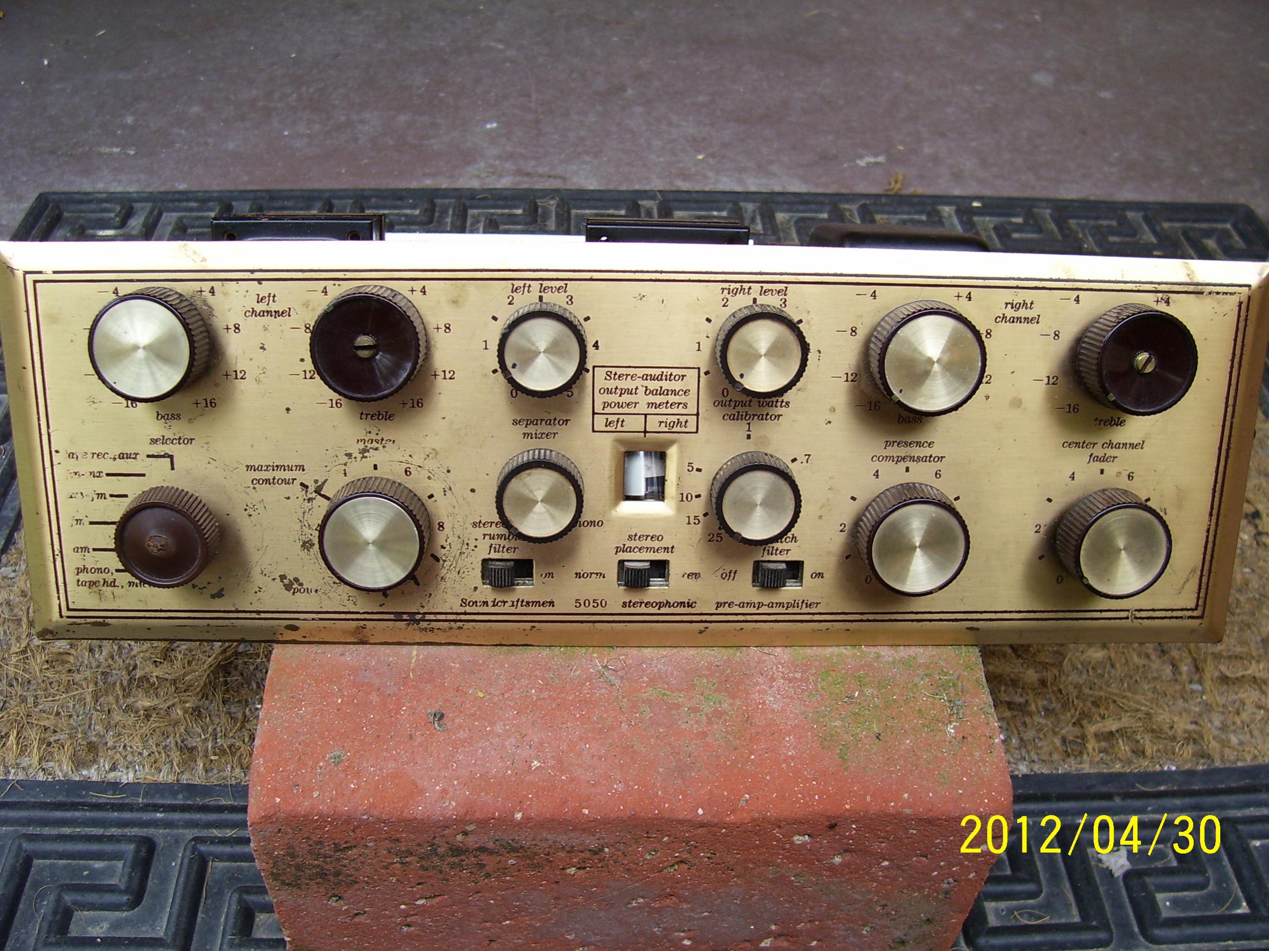

The indicator tube is for the "Stere-auditor Output Balance Meters" on the face plate. It has tone controls, Right Bass and Treble and Left Bass and Treble along with a Presence Compensator control.

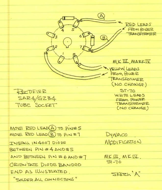

I've uploaded the series SS diode "trick". Follow the layout, but use UF4007s, not NASTY 1N4007s. The tweak may be critical with Sovtek 5AR4s and does not hurt, when an OS tube is used. 😉

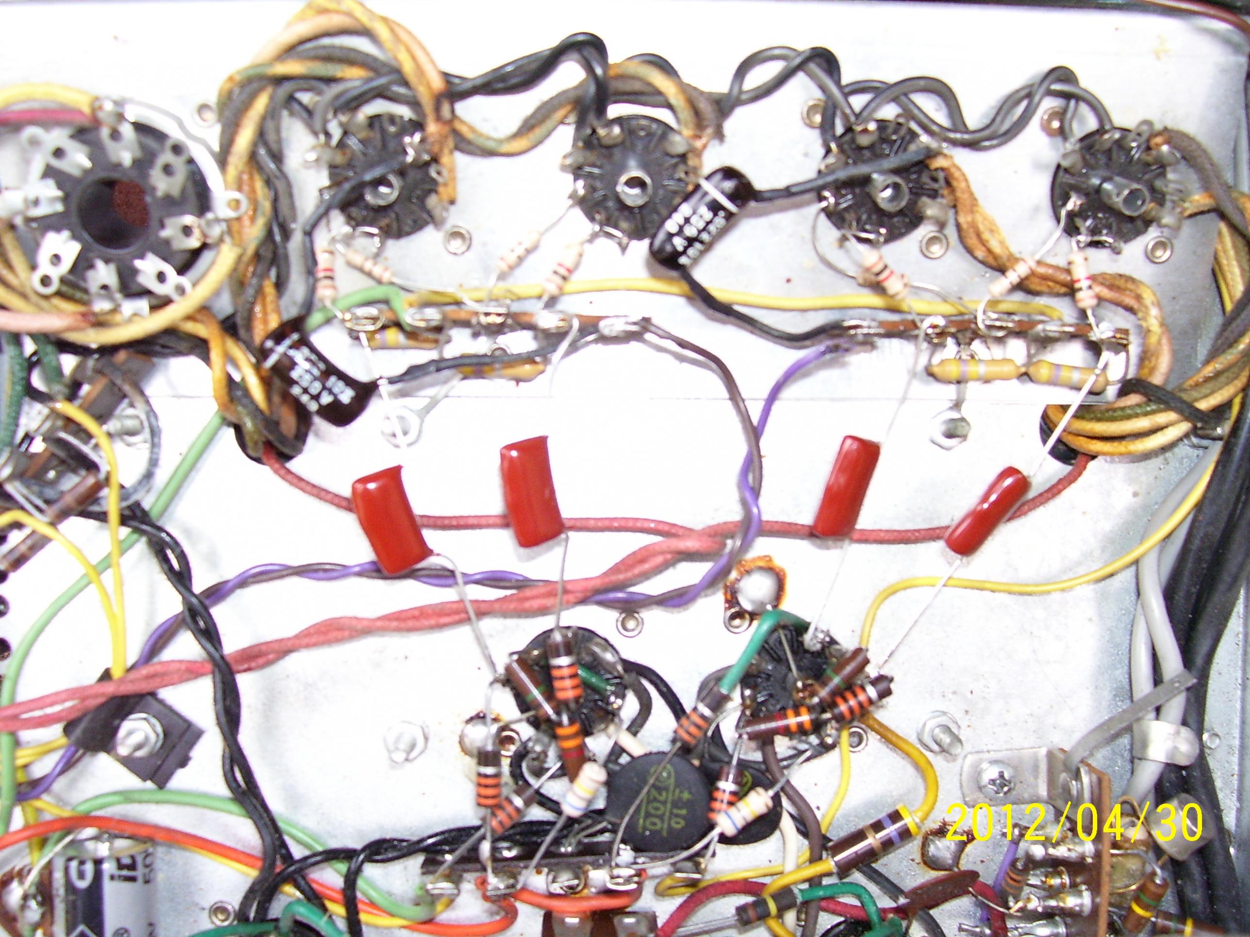

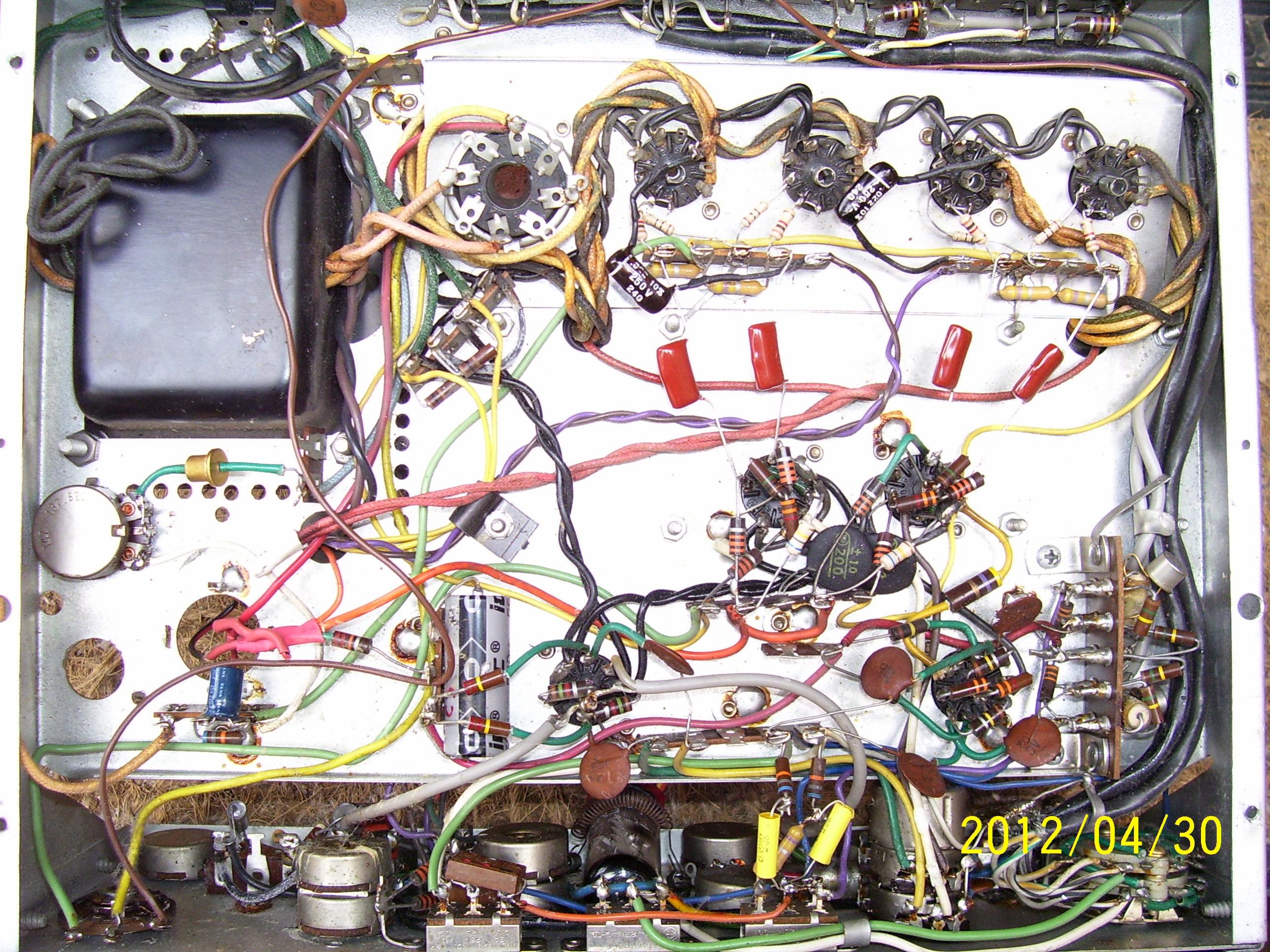

I suspect the missing filter cap. is 2 section, as I see 2 red wires. The 5AR4 data sheet tells us what the limiting values are. Jim McShane, a VERY reliable seller of tubes and parts, stocks a F&T brand 500 WVDC 50 μF./50 uF. part that rates to be suitable.
If a restoration that's close to OEM is to happen, hand tracing out the schematic may be necessary. OTOH, functionally refurbishing the unit to perform well is somewhat easier. The building blocks available are well understood and good sound can be anticipated.

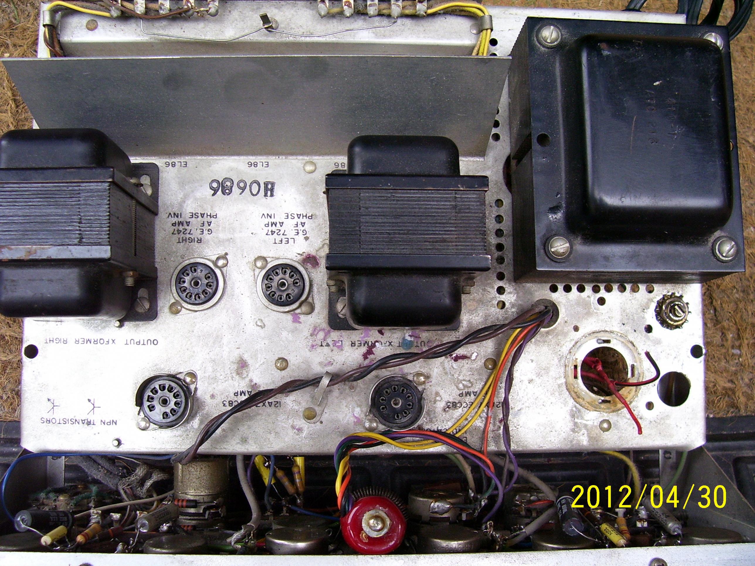

The uploaded photos provide at least 1 clue. I see a "top hat" diode connected to a potentiometer. That suggests the O/P tubes use "fixed" bias and only a single adjustment is present. That imposes a requirement that all 4 "finals" be very closely matched in both gm and cathode current. Can you say increased costs?
From what I've been able to gather, the amp and tuner date from the end of the 1950s. The BJTs in the phono section may be germanium, not silicon. How many transistors are there in each channel? Sorry, the tuner is unimpressive. It predates FM MPX and has (IMO) an inadequate tube complement. The tuner's value may be exclusively historical. 🙁
UF4007s may be the correct choice if starting from scratch, but I am using 1N4007s for the 5AR4 in my 6CA7 PP build and my THD is less than 0.055%, and hum at the speaker terminals is less than 1mV, inaudible.
The UF **** diodes will reduce noise, they won't affect hum or THD. Your measurements are excellent, they just aren't the measurements that dictate why a better diode is a good choice. Do a search for "PN burst noise" or "diode noise", you'll turn up a lot of good info.

I see the chassis has two empty holes - the small hole was for a large power resistor the was mounted to the chassis; the larger hole was for a multisection can cap. I see a grey Illinois cap under the chassis that isn't original and I also see a terminal strip under the larger hole to the left of the Illinois cap in the pic - it leads to the top hat diode and pot Eli mentioned. It's certain that is bias supply parts that have been relocated.
I think a proper new can and a better job of implementing the bias supply is in order. I can likely help if you don't have another source for the parts.
