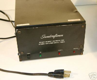

Keep it in the same case, it works very well. i have owned many of these. still have some parts. the fan is a two speed setup with a big fat resistor to slow it down, the solder cracks from vibration.

PM860 Burnt
I just got a pm860 with a burnt board the mounts over the capacitors. would if be possible to get a picture of the board so I know the value of the burnt resistors? Thx in advance. Robert
