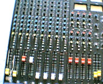

the desk come from ebay, which i recommend highly, soundcraft desk for £80, bargin!
heres a little picture of the desk when i got it, its in many bits now

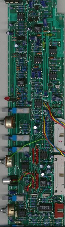

heres a little scan of my master board (RH master), intresting, i still havent actually tried to fix it yet, ive been working alot recently (only part time, but its alot to me, only being 16) good side of that is that i now have a little more money to spend 🙂
the ic's on the master board are as follows, also this is a little guess of mine of what they do... probably woring but anyway.
NE5532N ....this is near the oscillator controls ...
TL073CN ....i think this one is the vu meter driver...
NE5532P ....there are 7 of these on the board ...
TL071CP ....two of these, near the talkback mic, and in the middle of the board ...
here it should be,
