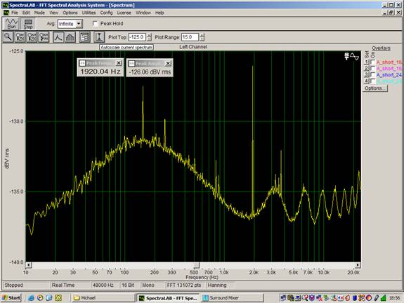

I've been tweaking my USB 2.0 creativeLab soundcard in order to lower the noisefloor, focusing on powersupply and shielding in the AD converter and digital processing paths.
This morning I decided to take it to the next level and try to push the noisefloor down even further, or get rid of the crap @ 5kHz and up.
This is where I started today, at this point the laptop and soundcard are on batteries with a bit of powersupply (oscons & coils where they made sense) tweaking since before.
Basically up until this morning getting the cards AD path down from around -100-110dB SNR to -130dB SNR.
Here is a FFT screendump of this morning. The conditions are ; analog in shorted, soundcard and spectraLab set for 24/48 displaying -120 to -150dB.
-131dB SNR is pretty good...

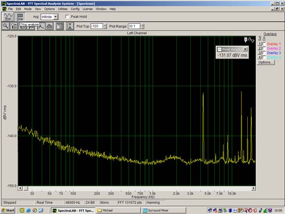

But working on it for an hour or so more, killing the internal switchmode supply and shielding the dac/ad chip gives this...-135.3dB.

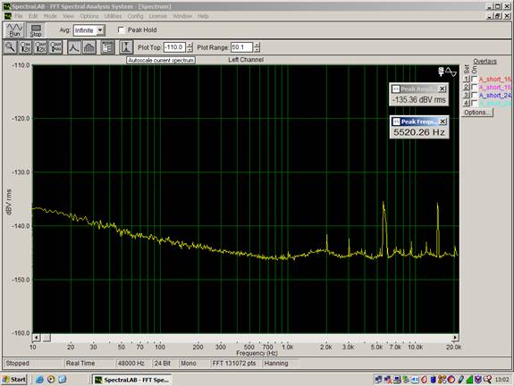

-136.2dB @ 8Hz
This dump shows the soundcard after adding shielding to all digital processing chips and specific shielding around the spdif transformer which was very close to deoupling and filter caps for the AD converter......gives a reading of -136.27 now @ 8.06Hz.
This brings me to my problem, I can't seem to get rid of the spikes at 5.4, 15kHz and around, they are slightly damped compared to the start but I don't seem to have found the cause for them.
If I add a oscons or mkt caps at the wrong places the spikes could increase with up to 10dB (which so far, for me indicated the powersupply)
They are only visible when I monitor analog in, using spdif and running zero's does not reveal the noise.
Any advice/experiance would be welcome!
/Michael

I think that many ICs are powered from the same regulator, is that it?
If yes, you could try to implement Guido Tent's power supply decoupling
The 5.4 and 15kHz spikes can be due to an IC working (or asking for current) at this frequency, that causes some noise on the supply, and degrades the DAC's (or the ADC's) performance

What about noise from the computer itself, or the USB connection?
Do you get a difference if you place the soundcard at another position relative to the computer?
Have you checked that it isnt a frequency that is folded around fs/2. At these levels it could be that the filters do not cope with filtering the noise above fs/2.
The frequencies to look for would be then fs/2+n(fs/2-freq).
Where n is most likely to be 1 but any integer is possible.
Are you sampling at 48k or is it 96k?

Yes the chips analog supply share the same 5v supply as a few logic chips and the toslink units however there are ferritecoils in between. I also tried disconnected the spdif and toslink units but it did not make a difference. As I don't have the schematics there could ofcourse be more.
Which is the ADC chip?? And what is there before it??
Its a sigmatel URL=http://www.sigmatel.com/documents/stac9460-ds.pdf]STAC 9460[/URL] that is not supposed to come close to where its at right now and the signal goes directly into the chip, the only komponents between input and the chip are two caps for dc filtering.
The only issue that changes depending on where I put it is that it sometimes picks up 50Hz if I am not careful.
Have you checked that it isnt a frequency that is folded around fs/2. At these levels it could be that the filters do not cope with filtering the noise above fs/2. The frequencies to look for would be then fs/2+n(fs/2-freq). Where n is most likely to be 1 but any integer is possible. Are you sampling at 48k or is it 96k?
The pics up until now was sampled at 48kHz and I thought about it before posting. It could explain the peak at 5350Hz (ie 48kHz/9 equals 5333Hz) but not the one at 14362Hz as far as I understand.

Shorting the inputs to the ADC is a little bit like cheating 😉
The proper way of doing this is applying an analog 1kHz sinewave at -60dBFS to the ADC. This signal is small enough that the noise will dominate over the distortion. Then measure the THD+N in spectralab and add 60dB to that number. This gives you the dynamic range.
To generate a -60dB signal, it is best to have your DAC output close to 0dB and then attenuate with a potmeter. This way you attenuate both the siganl and noise coming from the DAC and so you take the DAC performance out of the equation.

Ojg, jewilson, I agree fully but there is more to it.
I started off trying to loose the spikes at 5 and 15kHz but to be able to see them clearly I had to let spectralab do heavy averaging.
I was to focused on the spikes to think about the consequences of heavy averaging, it cancels random noise to almost nothing and that is why the results get so good. If I use peak hold it is more in line with the specs at around -124dB with no signal and I am sure it gets worse if I would measure with a signal as you suggest.
The thread was to show the spikes and try to understand if that is as good as an adc gets or if I had particular problems due to the spikes that could be fixed.
Anyone know if there is some form of standard doing these type of measurements, i.e is it peakhold or should one apply some amount of averaging?
I think neither peakhold nor averaging will tell you the real DNR number. When I think about it FFT is probably not suitable for this measurement at all, because the FFT itself will also be averaging the samples. I.e. a 32768 length FFT averages over 32768 samples.
Here's what I would do: Record a few seconds worth of your -60dB signal at 24 bits into Cooledit or similiar program. Then use Cooledits filter function to notch out the 1kHz fundamental. Now select the statistics-menu and it will tell you the RMS value of the signal. This will be your DNR number.
I don't know if this is the standard way of doing it, but it comes close to how it would be done in the analog domain.
